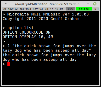

   i have raised this issue before, although in relation to the picomite VGA. the length of the command line is limited to whatever mmbasic 'thinks' the screen width is. the same limitation applies to line lengths when in the editor. and the same limitation also applies to entry via the serial/USB console too - so you can't just plug in a serial terminal and type in a (long) command line that exceeds the VGA or LCD panel width.
the end result is that many of the more complex OPTION lines are impossible to enter unless you carry out some terminal configuration gymnastics first. i've also raised this issue before, but been ignored.
really, the command line length should not be so limited, and you should be able to type in a command line that spans up to several screen/LCD display lines unencumbered.
as far as i can tell, the mx170 verison of mmbasic does not suffer from this limitation:
Micromite MKII MMBasic Ver 5.05.03
Copyright 2011-2020 Geoff Graham
> option display 20, 40
> ? "the quick brown fox jumps over the lazy dog who is asleep all day long"
rob  :-)

not quite sure what planet you are living on Peter, but the mx170 only supports console mode; all interaction is via a serial console. here is a screen capture:
as you can see, the command line wraps but is still interpreted correctly when the enter key is pressed.
rob   :-)
