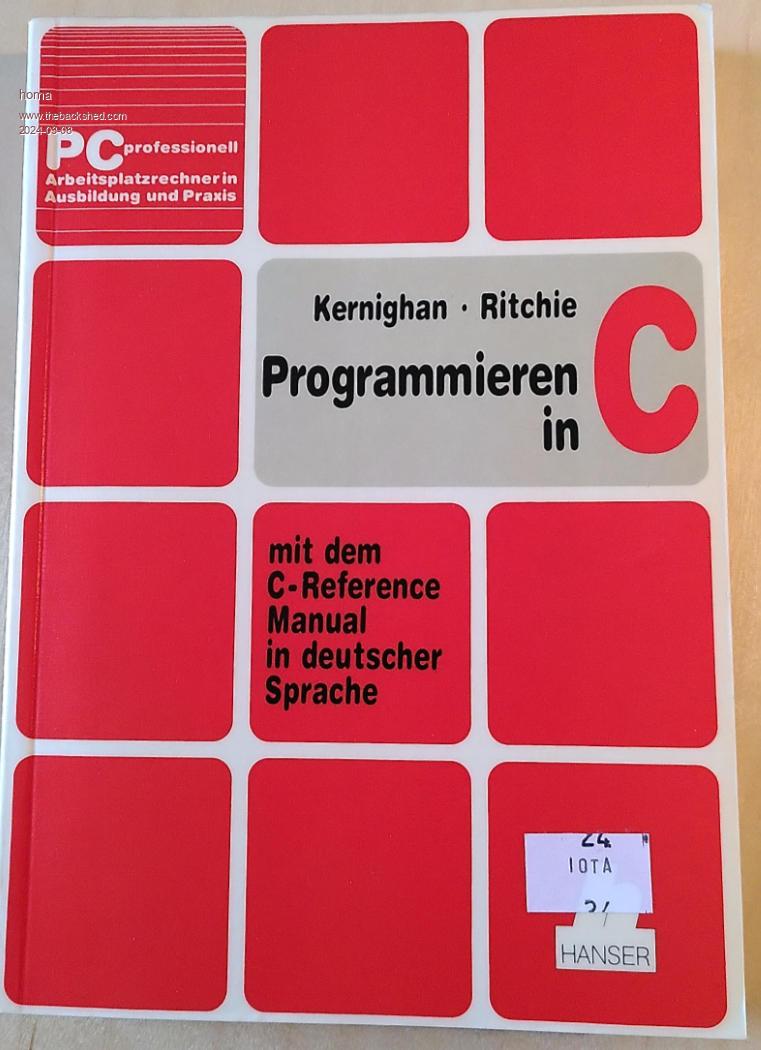

homa
Joined: 05/11/2021
Posts: 686
Posted: 03:55pm 07 Mar 2024
Hi Tom and Peter,
Thanks a lot for helping me out here!
Dude, I still have this on my shelf and in German, but it's still Spanish to me, I have a bad translation ;-)
No kidding, a later edition must be much better in translation. I'll see if I can still find it. Reading English is okay, but really learning it is a challenge for me as an old man.
