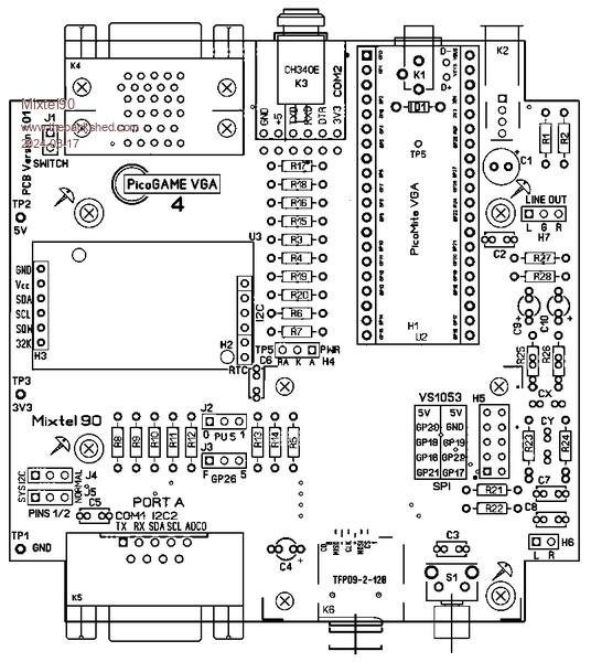

I know it's been a while but I kept allowing myself to get distracted. :)
I'd better warn you, this one is hot off the drawing board in some places. It isn't a tested design (yet) although I think all the different items (VS1053, USB, VGA pins, game port etc.) have all been tested individually now.
Once again, it's a pretty flexible board and you have various options that you can use.  It's rather a good idea to read the manual. :)
If you decide to put it in a case then you will have to chop out some of the PCB support pillars to get it to fit. Sorry 'bout that.
PicoGAME 40 gerber.zip
PicoGAME 4 101 circuit.pdf
PicoGAME 4 101 manual.pdf

Hi Mick,
It will become hard to choose what picomite platform to use. All have benefits and drawbacks. I am beginning to get confused. Peter cranking out boards, and your new introduction. But I guess yours is a superset of the picoGameVGA design, correct?
Posts: 8968
Posted: 06:36pm 17 Mar 2024
Correct. In fact, it's a development of the PicoGAME, PicoGAME 2 and the unreleased PicoGAME 3, which were all based on the PicoMite VGA. I've taken out some of the less-used options and added the latest USB and VS1053 developments. It's needed a bit of fiddling, but compatibility with the previous version is pretty good if you ignore the loss of Port B.
PicoGAME isn't intended to compete with Peter's CMM 1.5 or the CMM2, it's designed to be a gaming platform in its own right. It doesn't give the user a load of GPIO to play with, it replaces that with a standardised game controller / joystick socket.

Hi Mick,
Your latest design certainly looks very flexible.
What sort of controller does it support?
Can the controller port be used as an RS232 serial port?  I guess it would need level convertors to do that.
And I guess a question that might be better directed at Peter, is the USB version of the firmware taking over from the PS/2 version.
I have been working on a case that fits an available small form factor PS/2 keyboard, and now I am just looking at how to fit the PicoMite VGA PCB into the case.
Things like the switch header make it easy to mount a switch wherever I want, and (u)SD extensions likewise.  Even an audio jack can be run from header pins and mounted on the back panel.
The connectors that I need mounted on the same side of the pcb would be the VGA and the power, which I believe this design has.
It's been a long search, but I believe I'm getting closer to my ideal Modern Retro Computer.

Posted: 09:50am 19 Mar 2024
The DB9 has GP0, GP1, GP2 and GP3 dedicated to it. They all have 3K3 pullup resistors.
I've shown the controller possibilities in the manual, but basically you can have:
1 or 2 NES/SNES controllers
Atari joystick
Any I2C controller such as the Wii Classic using I2C2.
You could use GP0 and GP1 as COM1 TX and RX but you would need extra hardware, as you say.
Not all at once though. :)

From the revised manual:
There is now a version 1.02 of this PCB. It is identical in every respect to version 1.01 except that 2.54mm pitch connectors can be added for  K5, K6 and S1. This allows the board to be fitted at the rear of a deeper enclosure, with K5 and S1 extended to the front panel and K6 extended to a SD or microSD card breakout board also mounted against the front panel. The K5 extension can use a PC motherboard serial port lead. Note that the connector for the SD card will probably have to be a horizontal type as it is beneath the audio module. It is also possible to fit some microSD card breakout adapters using these holes rather than using the surface mount socket. Note that it will be necessary to remove the ready fitted connector on some of these as they are supplied "upside down". The connectors are not listed in the bill of materials and have no component references.
Gerbers etc. will be sorted out shortly.
EDIT:
Not quite identical now. The order of the pins for the SD card has changed so that it lines up with SPI2. SPI is still used by the VS1053.
