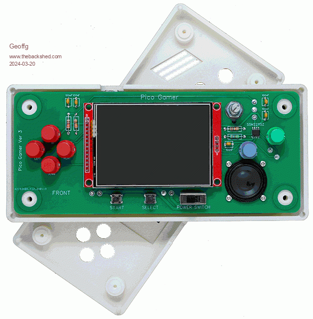

The April issue of Silicon Chip magazine is hitting the streets about now and it features the Pico Gamer.  This is a game playing console similar to the Nintendo Game Boy Advance but using the PicoMite.
It is based on thwill’s concept for the Game*Mite but with a 3D printed case, a different circuit and different firmware.  It is however software compatible, so games written for the Game*Mite will run unchanged on the Pico Gamer and vice versa.  The default firmware comes with most games available on the Game*Mite (with the authors' permission) plus my versions of Pac Man and Tetris.  Adding more games is easy, just copy them to the PicoMite’s drive A: and they will immediately appear in the menu.
An important component is the 3D printed case which can be made by many companies in China, typically costing less than US$20.  The case has a smooth rounded feel which sits well in the hands but it’s most important feature is that it holds the switch buttons steady – without this buttons have too much side to side “wobble” which ruins the game playing experience.  The design files are on my website ready to be sent to China.
A full description plus all the construction data and firmware is on my website at: http://geoffg.net/picogamer.html.
You can watch a short video describing the Pico Gamer here: https://youtu.be/Koi4JSnmtNg
Silicon Chip has made a video demonstrating the games: https://www.siliconchip.com.au/Videos/
Silicon Chip is selling full kits plus some components (PCB, case, etc) here: https://www.siliconchip.com.au/Shop/?article=16207
If you are going to build it you should also consider purchasing an electronic copy of the April magazine (AU$10) as it goes into more detail.  The online and downloadable versions of the April issue will be available from 28th March here: https://www.siliconchip.com.au/
I have a web page describing the design of the 3D printed case here: http://geoffg.net/3D_Printed_Cases.html
Credit to thwill for thinking up the Game*Mite.  It is a great concept.

Congratulations wit the new Pico Gamer !!
I looks very nice. And a good thing that you could keep it compatible with the Game*Mite. That will definitly help with growing a larger game base.
I also read your text about designing the case. That is something on my wish list for the comming year.

Looks great - congrats!

Very pretty.

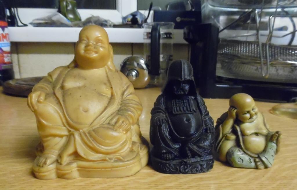

guess which one I 3D printed. ha ha
ebay flatpack build yourself £80, it's not got auto levelling and you got to flash a sd card then transfer that to sd card slot on printer but 3 years ago it was ok for the money.
