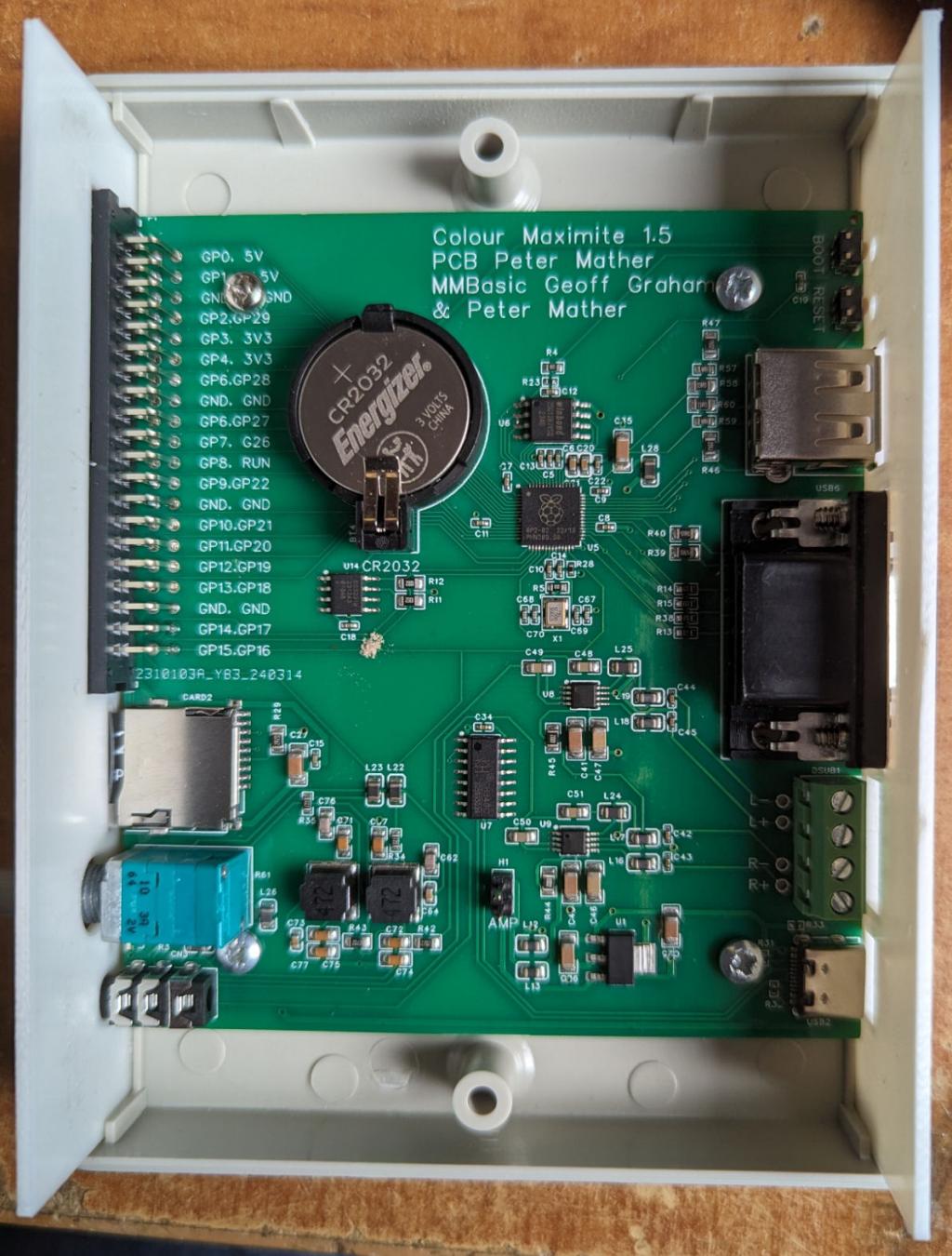

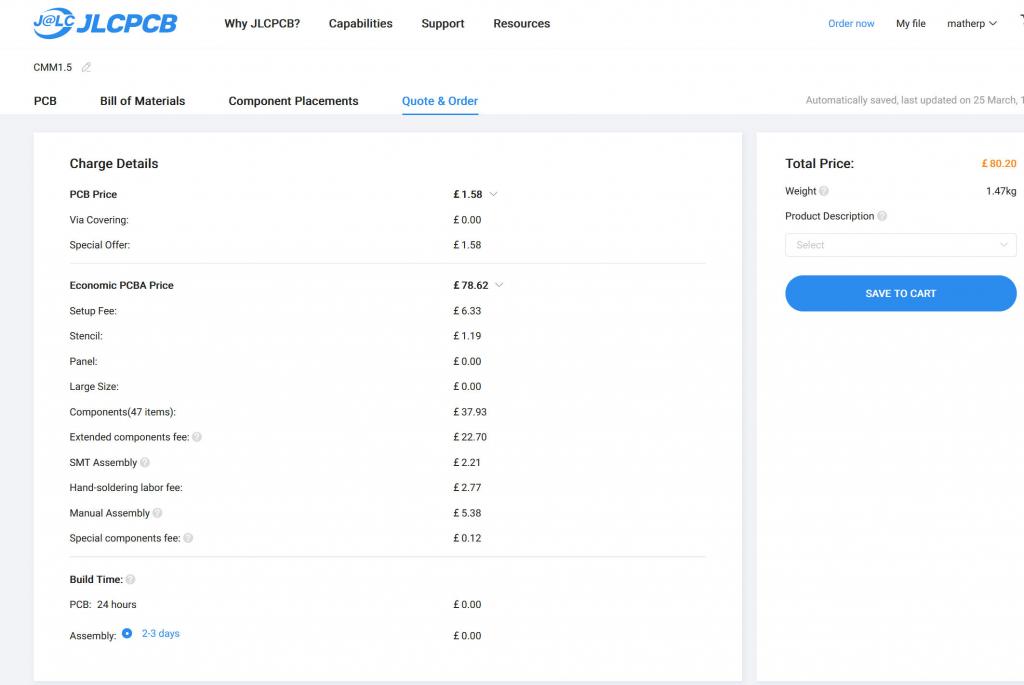

The CMM1.5 is a platform for running the PicoMiteVGAUSB software. Attached are all the design files to allow anyone to build this. The box is the MULTICOMP MCRM2015S. Price for 5 boards fully complete and ready to run from JLC is £80.20 + shipping and any country dependent taxes.
The push button on the volume control is non-latching so it can't be used for an on-off switch. Instead it is connected to GND and GP0 allowing it to be used as a user input for a program.
To install the firmware connect a USB-A to USB-A cable to the USB-A socket while holding down the "BOOT" switch. Copy the PicoMiteVGAUSB V5.09 firmware .uf2 file to the disk drive created by the RP2040. Then remove the USB-A cable and connect a USB-C for a console. Type OPTION RESET CMM1.5 and you are then fully configured

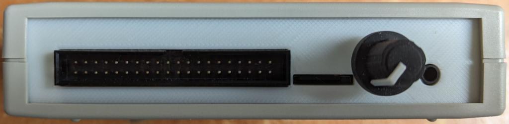

Dxf and stl files for the box ends
CMM1.5ends.zip

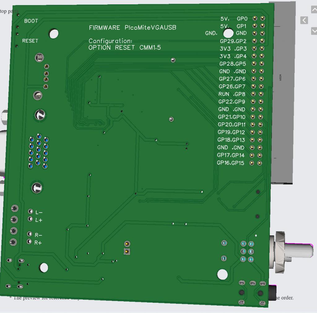

Posts: 5995
Posted: 07:47am 26 Mar 2024
Hi Peter,
JLC has removed the top copper cooling of U1. This may not be a huge issue, but the board is not the same as the 3D simulation files you included in this same post.

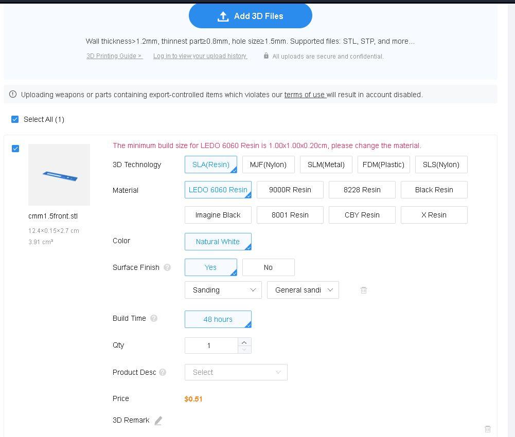

Trying to get JLC to 3D print the end-panels for the box, but no matter WHAT type of 3D printing I select(material or technology), it is rejected as being too small.
Peter?
Posts: 11656
Posted: 06:43am 21 May 2024
No idea. I printed myself. You could convert the DXF files to Gerbers and get them made as pcbs

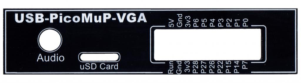

Posts: 2981
Posted: 06:51am 21 May 2024
Hi Grogster, All,
It looks like a face plate, I agree with Peter, get them done as PCBs
Here is a scan of one I have just had made in the last month.
Kind regards,
Mick (The Big one)
EDIT***
I got this one made in 0.8mm but of course you can get any size that they do PCBs in.
Mik

Posts: 5995
Posted: 06:56am 21 May 2024
You selected 0.15cm thick, and 0.2cm (2mm) thick is the minimum they offer.
You could redesign the panels to be 0.2cm thick, and have the edges slimmed down to 0.15cm.
Posts: 9996
Posted: 06:57am 21 May 2024
Thanks.

Posts: 9996
Posted: 06:59am 21 May 2024
  Volhout said  You selected 0.15cm thick, and 0.2cm (2mm) thick is the minimum they offer.
I didn't.
I just uploaded the files, and JLC decided about the thickness - I had no choice on that.  Anyway, I would PREFER to do them as PCB panels, just as I did for the CMM2_G2's, so I will pursue that option now.
Posts: 2981
Posted: 07:34am 21 May 2024
Grogster,
It wouldn’t be difficult to just redesign them in your PCB program.
A note on cut-outs though.
DEXpcb creates a seperate Gerber file for the cutout areas.
JLC used to be quite happy with this and do the cutouts as designed.
They have changed something now and require that the cutouts be on the border Gerber file.
They will still do them with a seperate cutouts.gbr file but NOT automatically.
You need to request confirmation of the manufacturing and add a comment about the Gerber for cutouts.
Before they start you can see the output and if the cutouts are not White then they will not be cutout of the PCB. If they are white then confirm the manufacture and all ‘should’ be OK.
BTW, JLC are now able to do full colour PCBs and have an introductory offer BUT the design has to be created using their EASY-EDA program and I don’t have a desire to learn a new program.
Besides the cost is quite considerable compared to the peanuts price of the standard process.
This would make for really nice face plates.
Mick.

Posts: 9996
Posted: 12:41am 22 May 2024
Yes, when I did the panels for the CMM2 and G2, they were done as blank black PCB's with silkscreen only.  They look great, and are easy etc.
I suppose I can just draw up my own ones.  I figured the DXF file would speed that along, but perhaps not!
I have to do the new CMM2 panels too, so I suppose I could just settle into doing them both at the same time, while I am thinking about it.
Yes, I put all the cutouts on the "Outline Layer" in Sprint Layout, and they always came back fine from JLC.  I did have to put a note in the order(translated to Chinese) saying these were just panels, not-solderable, no copper, just black ink and silkscreen, otherwise they did tend to question why there was no copper etc.
