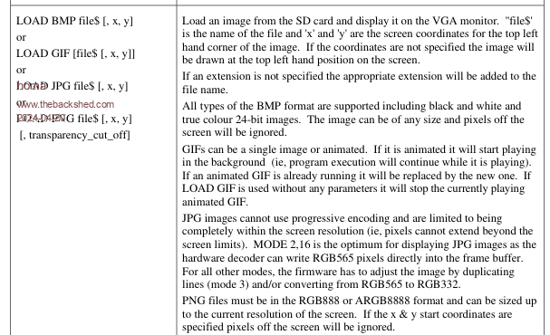

Which image types can the CMM2 display with which resolution?
I did not find a description of the specifications for the display of images.
Does it have to be switched to the appropriate mode for this?
When I call up the images via "files", it always jumps to the default mode 1.8.

It's all in the manual.
https://geoffg.net/Downloads/Maximite/Colour_Maximite_2_User_Manual.pdf
On page 85 the command LOAD (bmp,gif,jpg,png) ... and on page 91,92,93 the command MODE r, bits.
I had the same wish a few days ago and experimented with it. Mode 11 with 16bit is the best. Then the photos look best on a full HD monitor. Then JPGs with 16bit!
For the option with "Files" the default mode has to be configured differently. I haven't tried it yet.
Good luck and report back.

Thanks for the hints (Dankeschön!!) Mode 11,16 looks very good. I didn't know that "files" uses the default mode.
