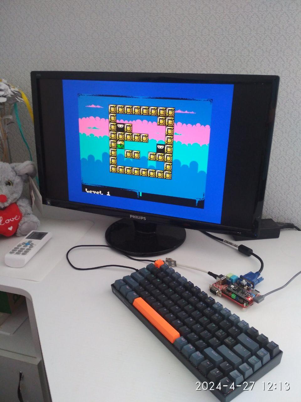

Posted: 01:25pm 27 Apr 2024
MMBASIC Photo frame for ZX Spectrum screens on PicoMiteVGA
MODE1 - Monochrome 640x480 mode + color TILE
ZXSCREENER.ZIP
Download files for ZX-Spectrum screens in *.scr format can be downloaded from the website:
https://zxart.ee/

Posted: 07:22pm 27 Apr 2024
Nice keyboard.....

Posted: 10:22pm 27 Apr 2024
Haha... honestly I just wanted to say the same as Volhout
REALLY cool keyboard

Posted: 07:17am 28 Apr 2024
This one on AliExpress looks very similar.

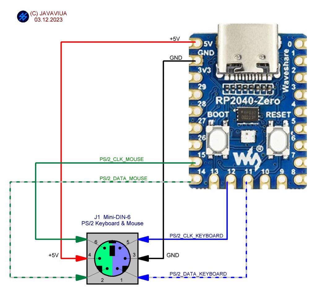

Posted: 03:09am 05 May 2024
Is that a home made USB C to PS/2 adaptor for that keyboard?

Posted: 06:26am 05 May 2024
  Hawk said  Is that a home made USB C to PS/2 adaptor for that keyboard?
Hi, Hawk
Yes, this is an adapter from USB to PS/2 keyboard and mouse
https://github.com/No0ne/ps2x2pico
For PicoMite it will work in a minimal circuit version.
