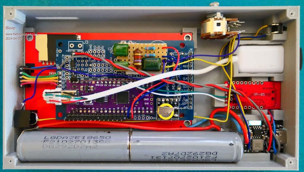

I wanted to build something that would be self contained and fully portable, this is what I came up with.
It uses a 4" ILI9488 LCD screen, 480x320 with touch, from AliExpress It has:-
USB obviously.
Mono sound through a jack plug, with volume, could easily be stereo.
Serial to USB.
SD card.
RTC.
All GPIO from GP0 to GP9 are free, coming out to a connector J1 along the bottom edge.
All the A/D inputs GP26 to GP28, coming out on connector J2.
Can be used as a battery bank when powered on to charge whatever...

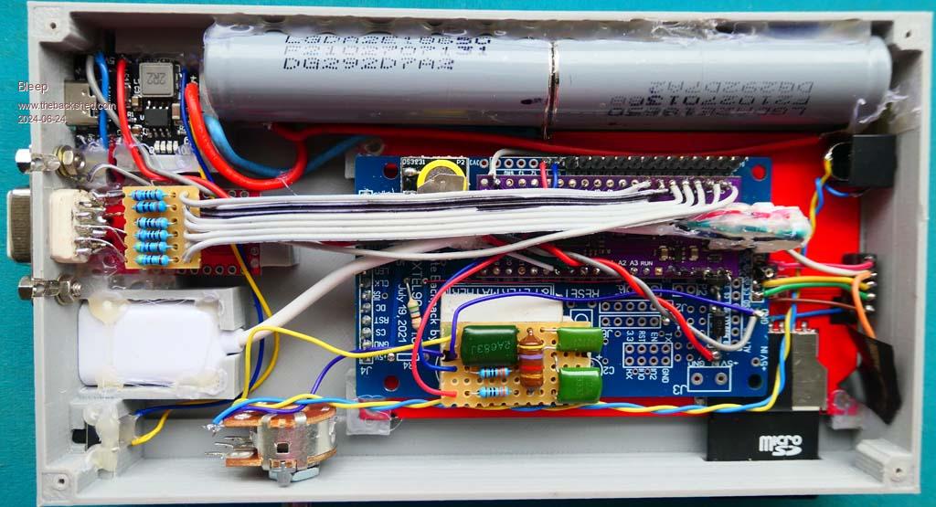

It uses:-
A Chinese Pico, because I wanted the extra flash.
One of Mixtel90 backpack boards, mainly as a carrier and for connections to
the screen, RTC and SD card.
A Lithium battery controller/charger/booster with on-off facility from Ebay
A serial to USB converter from Ebay
A RTC from Ebay
A strip board with Volhouts Audio filter, into which both audio outputs are fed, can easily be made stereo, then on to the 1K potentiometer and output from a jack plug.
Other sundry components were 2x Lithium batteries salvaged from a broken LapTop power pack 2.2AHr(measured) each, jack plug, 1K pot, momentary push switch and a box, which I designed up in FreeCAD, unfortunately my printer isn't great, but it has done the job, one slight hiccup was I designed it to have a 1.5mm recess in the back, into which the back plate should have dropped, for a currently unknown reason the printer stopped at exactly 1.5mm from finishing, so the back plate currently doesn't really fit, it sort of sits, but I will at some point make a larger back plate to properly cover the back. (the back plate should only take 30mins, the whole box took 7hrs. For the initial setup and testing everything is only friction fitted, once I'm confident it's all good, I'll hot glue everything, especially the batteries!
To operate you press the momentary button once and it all powers up, press twice and it powers down, if you connect to a powered external USB plug, the unit switches over to charging the batteries, as well as powering the unit, only caveat is once you are charging, if you remove the USB cable the unit will shut down briefly and then power back up, better to just leave it charging, then when you want to disconnect, press and hold the button while unplugging the power, it will then stay off, inserting USB power is ok, the unit continues running fine, or powers up if it was off.
Battery duration will be about 10 hours, full brightness screen, cpu at 420MHz, or about 20 hours, 50% brightness and 126MHz, or any combination in-between!
If you want music, I've experimented and have found compressing to a WAV file, using ADPCM @ 22kHz sample rate works acceptably, so nothing above about 10kHz, not exactly HiFi, but quite acceptable, especially for my ears. The file size is slightly bigger than a MP3 for the same track, so 4.41MB for MP3 and 6.15MB for ADPCM WAV, as opposed to 24.3MB for PCM lossless WAV.

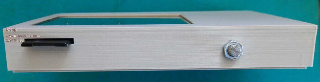

Pray tell me, what strange Majik doest hold the display into the case? Art?
Bleep
Joined: 09/01/2022
Posts: 817
Posted: 04:33pm 29 Apr 2024
Friction for the moment, once I'm happy I'll hot glue everything.

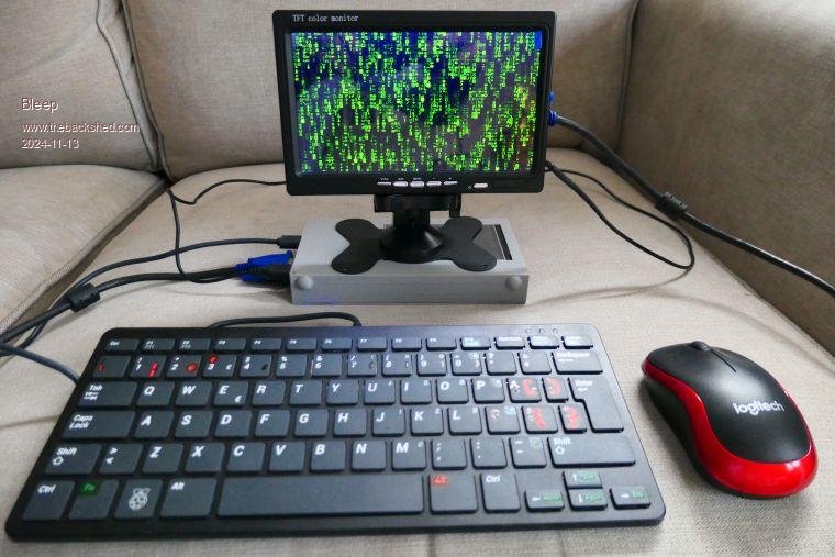

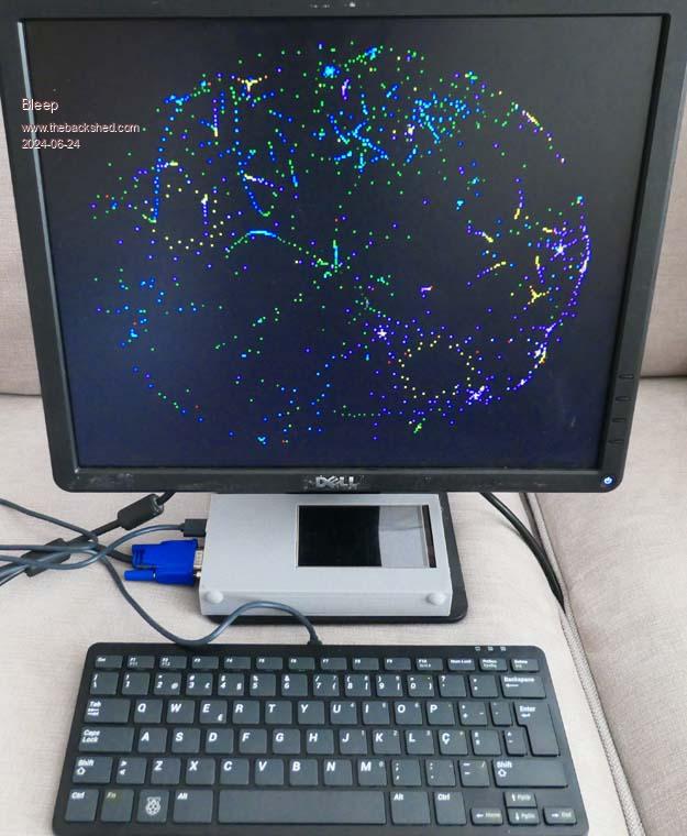

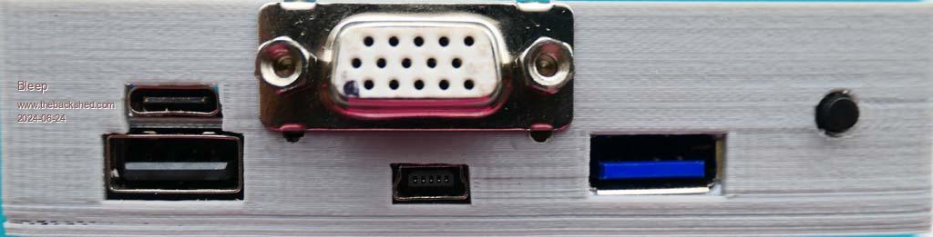

Bleep
Joined: 09/01/2022
Posts: 817
Posted: 03:45pm 23 Jun 2024
I've now included a VGA plug, so by changing the firmware I can use either LCD or VGA firmware.
Only problem I had was with the built in SD card reader on the LCD, I eventually had to add a jumper to either connect the SD MISO directly to the Pico, when using the VGA option, or via the LCD when using that; I beleive this is because of the extra diode/resistor required for this LCD, which was upsetting the SD when the LCD was not in use, all other connections stay as they are.

The PCB must have needed quite a bit of surgery to get the Purple module pin layout to work!

Bleep
Joined: 09/01/2022
Posts: 817
Posted: 07:45am 24 Jun 2024
Hi Phil,
Thanks very much for the info. :-) Now I know it can be got going in both versions I'll experiment a bit more & let you know, I have removed the pull ups, but as you say they are easily replacable, however, unfortunately I can't now change the 10k resistor, as it's on the other side of the LCD board, which is now glued in place, though I can wire a parallel resistor on to Micks blue board to get roughly between 1k5 & 3k3... 3k9 looks just right :-)
Yes wiring in the purple board to tie up with Micks layout was... interesting, I managed to do it, reasonably neatly, by cutting lengths of thin enamelled wire, some longer than others depending on routing, cleaning & pre tinning the ends, then soldering them all to the purple board, then very fiddly getting all the opposite ends into their appropriate holes on the blue board and soldering them as I went, in the end it all works and there is only about 2mm between blue/purple boards, & it looks neat, almost impossible to change anything of course. :-(
