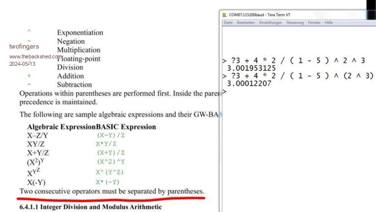

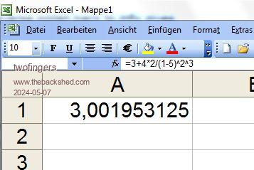

twofingers
Joined: 02/06/2014
Posts: 1769
Posted: 03:13pm 06 May 2024
  matherp said  3 + 4 * 2 / ( 1 - 5 ) ^ 2 ^ 3
is calculated by MMbasic as 3.001953125
UPDATE Wolfram Alpha also gives 3.00012207 so I suspect MMbasic is wrong
But that's what Excel says:
strange ...
The lone and ...

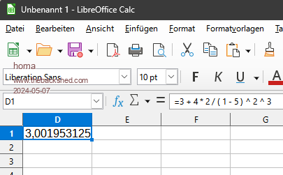

homa
Joined: 05/11/2021
Posts: 686
Posted: 03:37pm 06 May 2024
Very interesting, thank you!
  NPHighview said
PEMDAS is one attempt to implement the arithmetic concept of associativity. Here's an excellent explanation of how that is (or isn't) implemented in various programming languages, Excel, Matlab, Wolfram Alpha, etc.
and Libre ...
Matthias

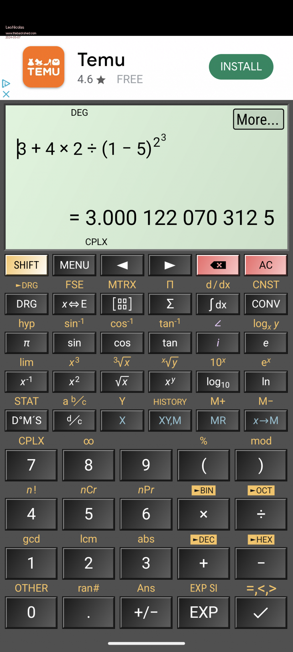

LeoNicolas
Joined: 07/10/2020
Posts: 625
Posted: 09:47pm 06 May 2024
From the android app HiPER Scientific Calculator

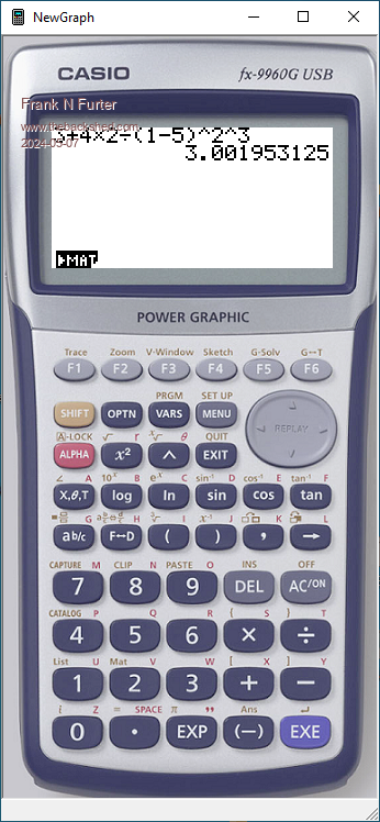

Joined: 28/05/2012
Posts: 1153
Posted: 06:26am 07 May 2024
This is what my CASIO calculator shows:
Frank
