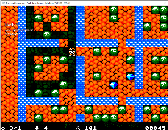

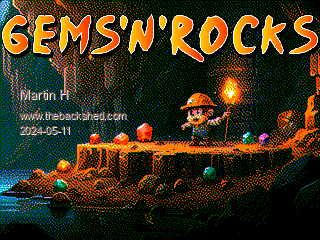

  Martin H. said  Right now I'm digging in the dirt.
I'm in the process of optimizing the routines that work. Checking the ones that aren't ready yet to see if they work the way I want them to.
Graphics, maps and self-written music are finished.
This is a Boulder Dash style vintage maze puzzler in which player collect gems before time runs out.
Here is a playable beta-version to test the program flow.
Movement via cursor keys and Game*Mite keys possible.(I prefer GameMite)
"m"-Key (controller "B") switches the music on and off.
ESC /Select to end the Program.
It lacks
a proper GUI,
the functions for water, butterflies and fireflies,
NES Controller support.
But the basic game-routines works.
GemsNRocks_beta.zip
Thanks and suggestions for improvement are welcome.
Have fun
Martin

Nice Martin,
Have been playing it on VGA. There are some rules I do not understand yet (sometimes a boulder falls in a pit to the side, sometimes it does not).
And when a level starts you see it build up (very fast, but never the less).
Is this all running on N layer ? Is it the intention that the flies and butterflies move in the grid, or pixel based (sprites) on L ?
But it looks nice. Reminds me a lot of Supaplex, I played a lot in the 90's.

  Volhout said  Nice Martin,
Simple rules apply to gravity.
A stone/gem falls logically if there is air underneath it.
If it lies on another stone or gem, the system checks whether there is air next to it and diagonally below it; if this is the case, it falls one space diagonally.
As the scanning process is always carried out from bottom to top, stone avalanches can occur.
It also makes a difference whether the object lies on the player or falls, so I set a bit (128) for the next scan, which remembers that this object was in motion.
The advantage of this method is that the objects manage themselves and I don't need any additional fields or time consuming routines to manage them.
The plan for fireflies and butterfliesis,
that will move clockwise and anticlockwise also just in the grid, so they just can move in "Air".(A layer is not required on VGA Version, Framebuffer is just used for faster LCD support). Here, the two upper bits should indicate the current direction of movement.
Both are deadly but if an object falls on a butterfly, the field it is on and those around it turn into gems.(one butterfly = 9 gems)
So one task in the game will be to drop objects so that they land on a butterfly.
Shouldn't be too difficult to integrate into the scan routine,but I still have some work to do. I still have to find out how the water should act

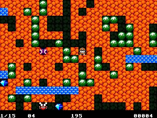

Here is the version with working routines for butterflies and fireflies.
The zip file only has the basic program, so the folder structure and files from the first upload are needed.
Now all that is missing is a proper framework( Menus , Gameover etc.)
Then the enemies will also be set to deadly.
GNR-Beta2.zip
have Fun

  Volhout said  Hi Martin,
I was just studying your code, to add the fireflies and butterflies moves....
you beat me to it ....
Did you ever play the game with water? do the flies fly over it ?
Great work!!
I had some trouble with the movement, because the scans run from bottom to top, from left to right, a fly that is moved up or to the right keeps moving during the scan. I solved this by also giving them a +32 marker when they were moved and ignoring them on the next scan.
I think I'll do without the water, the levels are hard enough as it.
Then a few additional levels and/or a level editor as a bonus.
