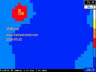

This thread is about a Thermal Camera based on PicoMite and a MLX90641 camera module that can be purchased around 20 dollar at Digikey or the likes.
The proto is running on VGA, but will have to be tested for a while before I release the code. The final product will run on LCD (handheld). The idea is to create a plug in for the Game*Mite expansion connector.
So this is just a heads up of what is coming, using the limited color palette of the VGA Picomite. The camera is 16x12 pixels, and this has been upscaled to 31x23 pixels.
The screen refresh rate is 0.5 seconds.

Posts: 6101
Posted: 11:17am 22 May 2024
  Amnesie said   I am sure there is a lot of math involved (interpolation?).
Daniel
The interpolation is simple code.
The complex math is in the conversion from ADC values per pixel, to temperature. Where there is dependency on emission coeficient, 3.3V voltage, ambient temperature, compensation pixel behaviour, linearization... and this all per pixel. It took me days to implement it from the Melexis MLX90641 datasheet (look at it, 54 pages mainly filled with math and examples).
Currently the camera itself is set to an update rate of 2Hz. And the current code uses 190ms to read the pixel data through I2C (100kHz), 70ms to do all the math (mainly useing MATH array commands in MMBasic), 190ms to do the up-scaling and pixel display (BOX command).
The camera can work faster, the I2C can go to 400kHz, so I might be able to get to 4Hz by squeezing every last bit out of the performance. But for now, let's first make it work correctly. My ambient temperature calculation is few degrees off. So need to search into the math if somewhere I repaced a "+" with a "-"....??

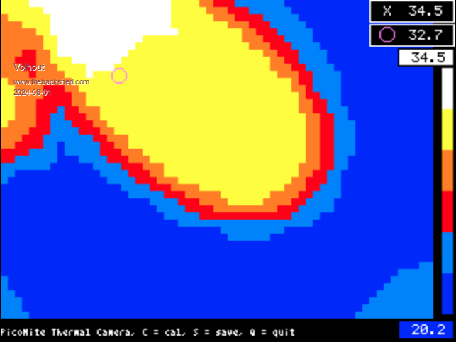

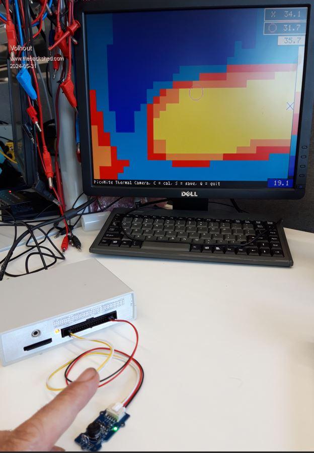

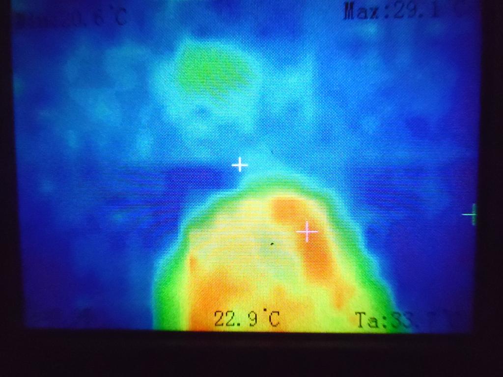

This is the status quo of the PicoMite Thermal Camera.
- 0.5 sec update rate (@252MHz CPU speed)
- "s" will make a screenshot
- 2 markers (X=higest temp, O=centre pixel)
- "c" zero's the screen (*)
Code
MLX90641_dev_09.zip
The code is compatible with VGA and ILI9341 320x240 LCD. Control is through keyboard ATM.
Support for Game*Mite controls and filesystem is next on the list.
Unit in operation (VGA), my finger is in front of the camera module.
I use a Seedstudio Grove IR camera module with MLX90641 with 110 degrees opening angle. Final design will use the 60 degrees opening angle part (software compatible).
This message is short, because my long message took too long, and I was kicked out of the forum, and lost all the message.
Edited 2024-05-31 21:56 by Volhout
Posts: 6101
Posted: 12:19pm 31 May 2024
Zero-ing.
Zeroing the screen is not really needed when temperature differences are large.
But the small differences between individual pixels can be equalized.
This is done by holding a piece of metal (at room temperature) in front of the camer and pressing "c". I use an old heatsink, so I know it is same temperature over the whole surface.

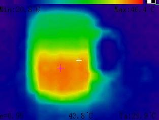

Posts: 6101
Posted: 02:01pm 31 May 2024
The current code upscales a 16x12 array to 31x23 by simply calculating the pixels in between in MMBasic by linear interpolation. Since there are only 16 colors in the VGA and in the framebuffer (needed to get speed to the LCD updates mainly) this gives a blocky screen. But it is the maximum that can be done in MMBasic in a refresh rate of 2Hz. Painting 700+ BOX'es and drawing the text etc..
If you see this (using probably the MLX90640 32x24 pixel array) and a piece of C code, you can start painting individual pixels.
demo code
The video is realy nice. Using all the colors, and calculating pixel RGB values using a fast algorithm, and immediately pushing the pixel out to the screen.
Still a lot can be improved in  MMBasic code, but I may need to work on a CSUB to do get closer to this demo.
Posts: 6101
Posted: 06:21pm 31 May 2024
Experiment with 4x upscaling...
The calculation and plotting takes more time
2x upscaling : 190ms
4x upscaling : 730ms
So the total update rate goes to 1 second.

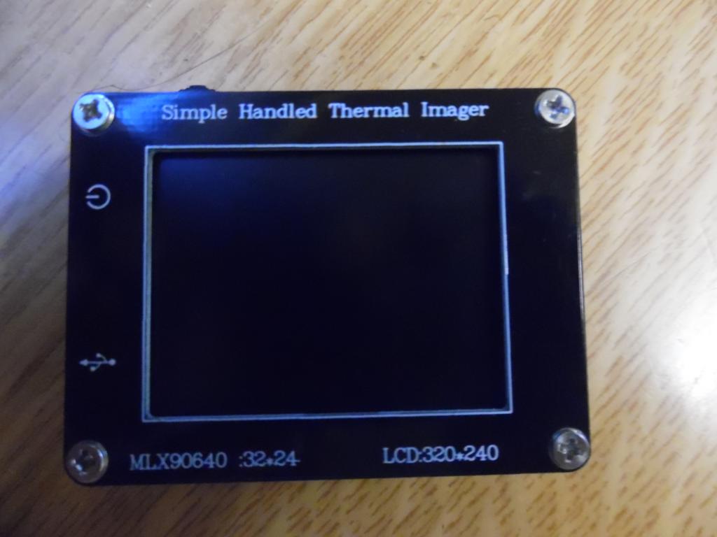

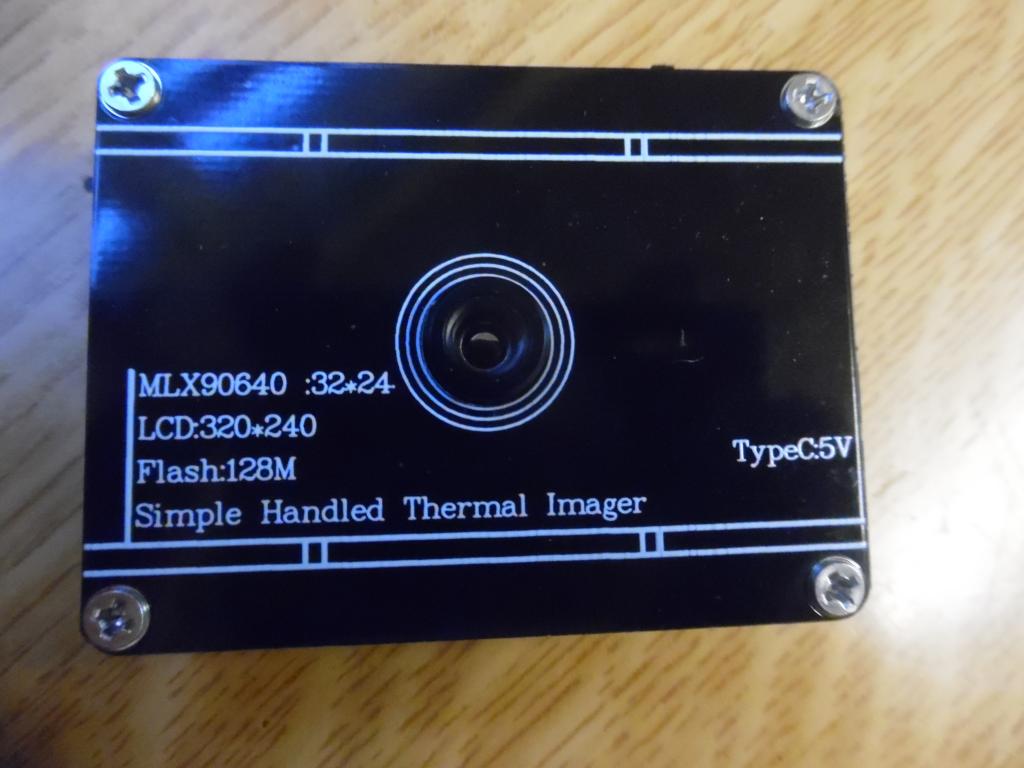

I went and bought a camera that looks like a kit for £26. no instructions. can't read as usb drive. could it be hacked for data ?
Posts: 2807
Posted: 09:20pm 31 May 2024
it could be a premade adafruit board with lcd and battery. figured usb and scroll through saved images.
half full mug of coffee
Edited 2024-06-01 07:34 by stanleyella

Posted: 07:39am 04 Jun 2024
All,
Yesterday played with matrix multiplication for up-scaling. It is 2-3x faster than doing the math cell by cell, but it is consuming too much memory. For 2x up-scaling it is roughly 7kbyte, but for 4x up-scaling it is 20kbyte extra in arrays that contain the up-scaling constants.
Since up-scaling was not the dominant factor(*), it is back to standard math.
(*) dominant factor upscaling 4x is writing 2790 BOX'es each frame, and re-drawing some text (=480ms). And I currently see no alternative way. I knwo many have the same color, but finding that out, and blit fewer larger boxes, costs also time. Maybe someting can be gained by determining the median color in the array, plotting the whole screen in median color, then plotting only the boxes that are different.
Edited 2024-06-04 17:42 by Volhout
