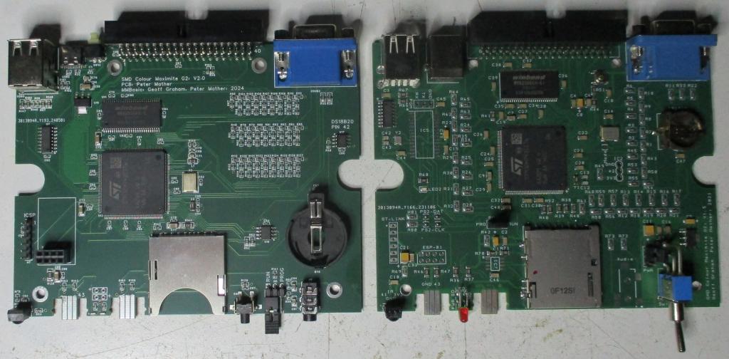

Peter has done a stellar job with the new design.
Look at the two different designs:
New one on the left, old one on the right.
Nothing wrong with the old design, but the new one is much "Tighter".
Posts: 8968
Posted: 08:25am 27 May 2024
It's interesting to see them side by side. I'm glad to see the end of that USB-B socket and a decent battery! Simple things, but fundamental.

The problem hasn't been the connectors, they are ok. It's the difficulty in finding good leads that will actually carry more than a few mA without volt drop. The majority are for connecting printers, where the power conductors are very poor as they aren't actually needed to carry current.
Personally I still prefer a barrel jack. They are designed to carry current. Just don't use a large size on 5V systems as someone will connect it to 12V! USB-C is a good choice too, but far more difficult to fit and less robust. There is also the danger of them being used to provide more than 5V if you use the wrong lead and the other end is capable of supplying it.
