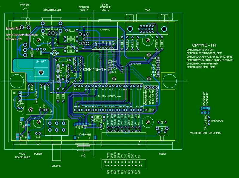

Inspired by Peter's CMM1.5, and fitting into the same case.
I was wondering yesterday if it would be possible to fit a normal through-hole version in. This is what I came up with. The design isn't complete yet, it's not ready for building as without a case I can't be certain about the fit. The available drawing for that case is pretty poor.
Peter used some of the normally reserved pins, which was a bit of a challenge. I've used GP25 as the SD card CS line so there's no heartbeat signal.
I've connected the Pico's USB to a USB-A socket on the rear panel. That means taking the top off for installing the firmware at first - but you need to to get at the Boot button anyway.
I decided that as half the GPIO connector would be rarely used I could halve it's length. I also reverted it to the original pattern on the first version of the CMM1.5 as that's the correct way up for those connectors. I don't care what you can get JLCPCB to use. :)  Of course, there's no GP29, but I connected the same pin. If a modified YD-RP2040 is used then it should be possible to get GP29 back.
I left out the power amp and replaced it with a LM4881 high quality headphone amp. This uses a common ground for the outputs. I added an option to power it from 5V (about 200mW max output) or 3V3 (about 90mW max output). Min. impedance is 8R so it will drive small speakers.

Very nice Mick!
When you can get the modules (LM4881 etc) that is a neat solution. You can even replace the SD reader with a module.
What made you decide for the CH340 solution, and not the (second) pico zero that converts USB to PS2?
Then you could use the proven VGA code.
P.s. you could also have sacrificed GP28. The adc’s are rarely used all 3

The CH340 is about 80p on AE and is smaller. It's also how the original CMM1.5 works and I specifically designed this to be similar.
The LM45881 module is around 2 UKP by the time you've added shipping. I'm sure I found it with inclusive shipping when I got one, but I can't find it now.
Getting microSD modules in can be a bit of a pain because of the depth they take up. Very often the edge of the socket is too flush to the edge of the module's PCB. Even on this design I've had to overhang the socket to get enough of the card through the front panel.

If people like it I'll finish it off.
Beware of a few issues though:
If you want the WII socket I got a couple on stupidly long delivery. I've been unable to find them anywhere apart from that one Chinese supplier. I don't think I can modify the board for a PCB edge design because of height issues in this particular enclosure. I'm tempted to change this for a RJ11 simply because of availability. It's possible to either make an adapter lead (from a WII extension lead) or chop off the WII plug and put a piece of RJ11 lead on.
I *think* it will work with the YD-RP2040 nut you have to modify it by shorting out two diode pins. If it will work then you get GP29 back and 16MB of flash. There is a problem in connecting to the USB on this board though, which may need some sort of butchered connector.
The LM4881 module and the CH9340C module are both available from AliExpress. The LM4881 may cost a little more than you first expect though due to postage charges.
The GPIO connector isn't compatible with the current version of the CMM1.5.
The audio should drive sensitive speakers ok, but 200mW per channel isn't a lot. It would be ok for a quiet room but don't expect loud bangs and crashes from games. It's more than enough for headphones up to 64R though. You'd be surprised how loud 1W is, and 200mW isn't 1/5th as loud as 1W. It's a lot more.
