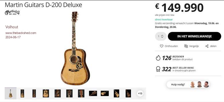

I was confused. Buy a Martin&Co guitar for 58gbp ?
But then I read "MartinSmith". Ok .. different brand....

@Volhout
150K for a lump of wood with strings on it????
I'm definitely in the wrong business
I see a lot of £2,000 Martins at open-mic gigs and owners who can barely play.
They all have the aforementioned piezo pickups and sound thin and tinny but they seem to believe that they spent the money and therefore they must be sounding good.

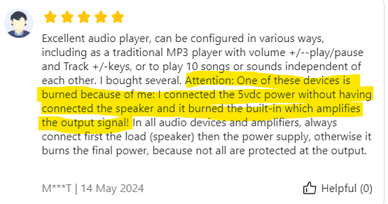

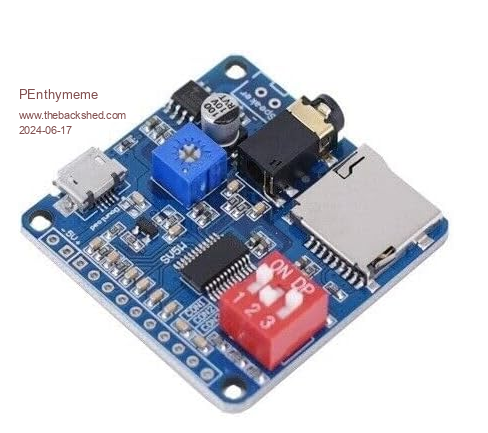

I bought one of these: https://www.amazon.co.uk/dp/B0CM47X42Q?psc=1&ref=ppx_yo2ov_dt_b_product_details
It has a few modes:
* It can trigger specific MP3s when pins are grounded (they way I use it)
* It can trigger specific MP3s and which part using UART mode
* (I think) it can also be controlled by SPI
PDF data sheet..
DY-SV5W Voice Playback Module Datasheet.pdf
My use case is a ghetto sound board linked to PicoMite.

  PEnthymeme said  I bought one of these:
Oh this is soooo cool    and has given me another idea.
I can get four of them for ~£10 on AE
Using the PicoMite to control them, I bet I could have a multi-track playback device.
I might have backing bass on one channel and percussion on another (and then something else on the other tracks) which would allow me to set levels to suit a particular venue. I already have a mini-mixer. I bet that they would stay in-sync at least for the duration of a song(?)
