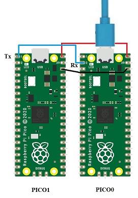

So to check what's happening I setup a simple system using 2 raspi PICOs as shown:
PICO#1's COM1 Tx line is connected to PICO#0's Rx line. The options on both are:
OPTION CASE UPPER
OPTION AUTORUN ON

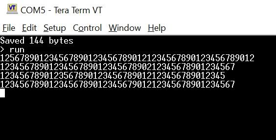

If I replace the PRINT statement in PICO#0 with
IF LEN(inp$)<>32 THEN PRINT inp$
I get lines printed roughly a minute or so apart as follows (ignore the first line since the program needs to sync first):
I've checked the serial line with a CRO and I can't see any change to the length of the data packet being sent by PICO#1 so I can only assume PICO#0 isn't keeping up with receiving data at that speed.

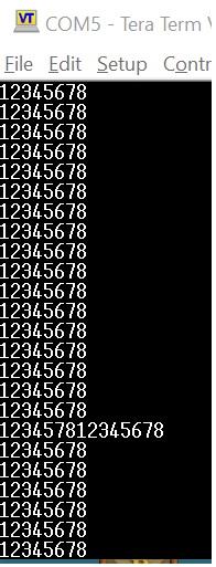

I just changed my test programs to send/receive 8 bytes and yep, same problem. Took a few minutes but it dropped the number '6' from the string:

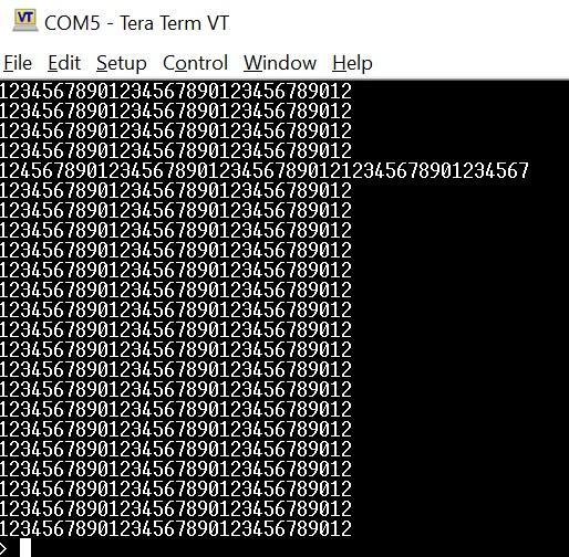

So if you re-read my original post, all tests I've now performed are using 2 raspi PICOs interconnected with 3 wires about 40mm long: +5 to +5, 0V to 0V and COM1 Tx from PICO#1 to COM1 Rx on PICO#0. I move the USB lead from one to the other to re-program each PICO but I leave it plugged into PICO#0 for the data transfer tests.
I confirmed that sending a 32 byte string + cr/lf (PRINT dat$) at 921600 baud via the USB port on each PICO to a computer running TeraTerm and Putty didn't drop any bytes when sending at 1 string per second and also 100 strings per sec. I then loaded a program into PICO#1 to send the 32 byte string via COM1 Tx at 921600 baud but once per second and looked at the signal with a CRO (oscilloscope). The packet didn't change size so confirmed 32 bytes were always sent (it would have been obvious if a byte was dropped).
Then I programmed PICO#0 to wait for a min of 32 bytes to be received from PICO#1 using LOC(), it inputs everything from the receive buffer using INPUT$(70,#5) (the 70 is there so it'll read up to 2 strings just in case) and to send everything it receives to TeraTerm at 921600 baud. So on the screen it should display 1 line of 32 characters each second.
So imagine my surprise when occasionally it skipped a second and then 1 second later printed nearly 2 strings of characters. 1 string per sec is hardly stretching any buffer or timing limits but there is was - it was dropping the occasional byte. The work-around as we now found is to either send the data with 2 stop bits or to up the speed of PICO#0. So it seems to indicate a timing problem in MMBASIC either with the INPUT$ command or thinking about it overnight, maybe there's an interaction using LOC() while serial data is being received by the serial port, I just don't know.
