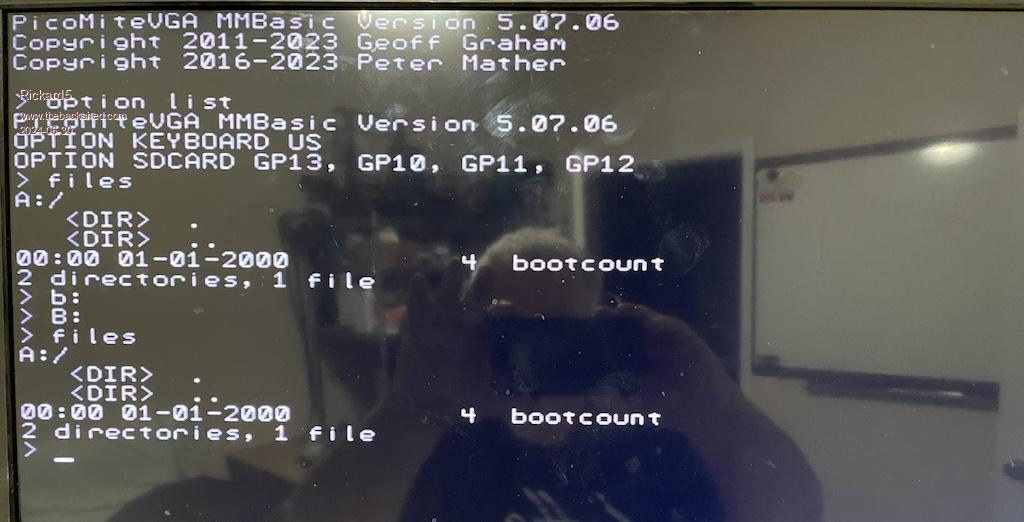

I'm on a building kick right now , and I just finished 3 design 1 Picomite VGAs and all 3 have the same problem, the SD Card doesn't work :(
I flashed them with PicomiteVGA MMBasic Version 5.07.06,  because for some reason I can not reach geoffg.net from any machine on my network.
I set the option to "option SDCARD  GP13,GP10,Gp11,GP12"
and when I do files on a Scared that is full of Picomite and CMM Files I Get Back the following
>files\
A:/
   <dir> .
   <dir> ..
00:00 01-01-2000.       4  boot count
2 directories,   1  file
I for the life don't know what I did wrong, can any one help please

What happens if You change to drive B: ?  Is the SD-card ready?

  v.lenzer said  What happens if You change to drive B: ?  Is the SD-card ready?
how do I change to B:?
Posts: 3323
Posted: 06:15am 28 Jun 2024
The Pico firmware creates Drive A: in the on-board flash chip so as noted above the SD card is B:.
Here is PicoMite V5.09.00RC5 firmware.
PicoMite_Beta (1).zip
Edit. At the command prompt type B: <enter>

on the console "B:" in the program "DRIVE B:". For more details see the manual from page 19 (last paragraph) and page 70. Good luck!

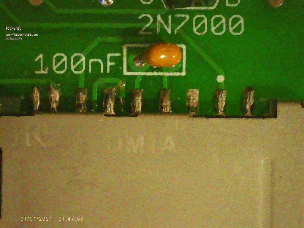

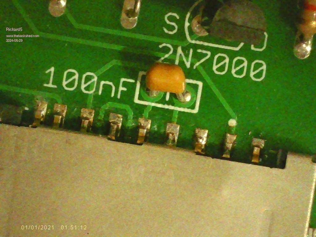

I've re-flashed all board and No joy Tried to Change to B: from prompt and I get the same results below is pictures of the solder job on 2 of the boards and I've checked all other solder joint under micro scope too

  Quote  I set the option to "option SDCARD  GP13,GP10,Gp11,GP12"
Same settings as I use on PicoMiteVGA MMBasic Version 5.09.00RC5 without problem.
"Option List" will show if the option has been accepted correctly.
That just leaves the hardware.
Check that you have 3.3V across the 100nF cap.
Others have found some SD cards can be fussy about the supply impedance so add a 10µF SMD ceramic across the 100nF if no cards work at all.
Check continuity from each SD pin to the top of the Pico pins, as per the diagram in the manual (p18 in the most recent one) in case there is bad contact in the Pico socket.
Another possibility is poor contact in the SD socket. Look inside with a magnifying glass for an out of place contact.
Some masking tape on the top of the card, at the contact end may press it down on the contacts better.
Edited 2024-06-29 14:28 by phil99

How is your card formatted? If you do it on Windows the default format may be wrong. It won't work with NTFS.
Your options are correct for that board and we know that the board design is ok so it must be something else. We need to check for bad etches and bad connections.
With the card removed and the power off, preferably with the Pico unplugged, check for shorts and/or open circuit connections from the Pico socket to the SD card socket. Use a thin wire into the socket so that you are checking the soldered joints. It looks like the SD card isn't even attempting to be accessed.

Posts: 11654
Posted: 07:24am 01 Jul 2024
One failure mode when assembling SD sockets is to allow them to sit up off the PCB on the solder even though the connection to the pins is good..
Never tin the pads before fitting the socket. It must fit tightly down on the board as it is this fit that holds the card against the contacts
Posts: 5995
Posted: 08:09am 01 Jul 2024
Rickard5,
To much solder may short out the pins to the metal. Your second photo shows potential candidates for these shorts. Can easilly be detected with a multimeter.
The first photo has a non-soldered pin (6'th from the left).
Posts: 8967
Posted: 08:18am 01 Jul 2024
It might be an idea to lift some of the solder off using fine solder wick. First, it will remove any excess solder, secondly the re-heating and pressure will help the remaining solder get between the contact and the trace to improve the contact. You can always put solder back if you need to. :)
