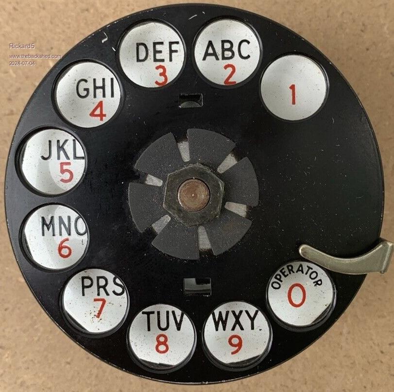

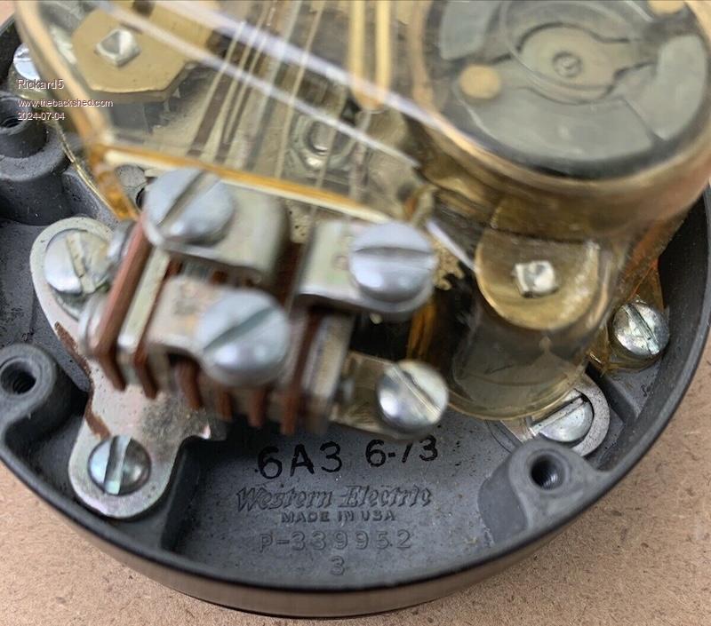

Rickard5
Joined: 31/03/2022
Posts: 463
Posted: 03:40am 04 Jul 2024
  DaveJacko said
I'm just playing with a 1930's Bakelite micro-Ammeter
Dave I'm watching a Western Electric Black Rotary Dialer I Want Badly to acquire, and build a very Steam Punk Calculator with MMBasic on the Pico Use th dial as a number psd and a Button  matrix for operator buttons:) the hard part is how to use 8 segment LEDs for Displays. and I'd love to have a pull arm or a carriage line feed that ratchets on top as the enter Key as it would be a Reverse Polish Calculator! Something Very Brazil!
