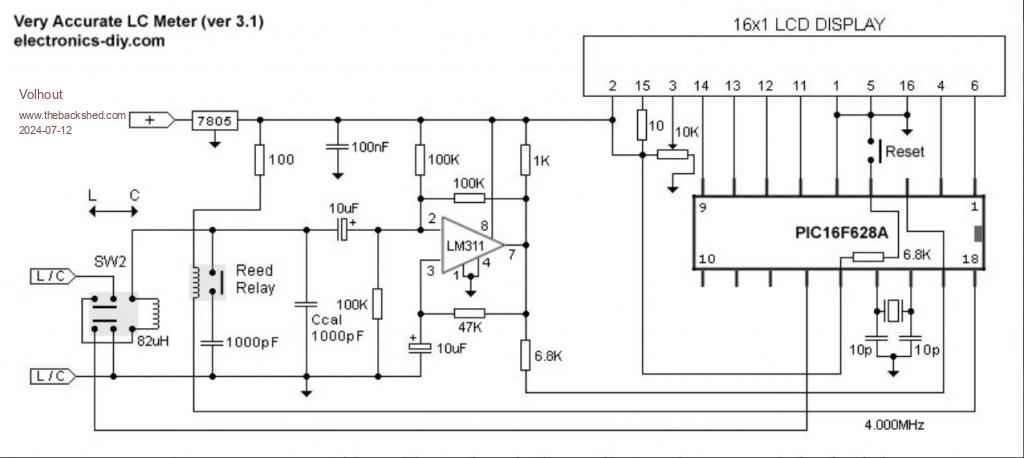

What is everybody working on... Well, this is my latest addition to the PicoMite family.
The PicoMite LC meter
This is not my own design, but a PicoMite implementation of a design that is published on the internet years and years ago. I breadboarded the design, and used the breadboard since. But I liked it so much, I got a more solid housing now.
The LC meter can measure capacitance between 1pF and 100nF, and inductors between 0.1uH and over 15mH. It is based on a a tuned oscillator, and addad capacitance and inductance off-tunes the oscillator. The frequency changes of the oscillator is measured, and from there, with simple electronics math, the values are calculated and displayed.

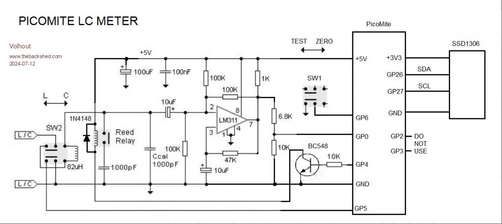

This is the (arduino) circuit diagram that is used as a basis:

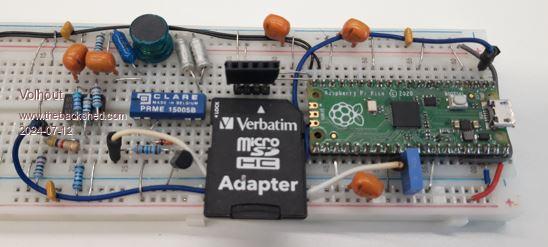

And the breadboard version
To adapt the circuit to the Pico 3.3V levels the output (the 6.8k resistor) receives a 10k pulldown, and the relay output gets a NPN driver transistor with 10k base resistor.
The re-vamped circuit looks like this now

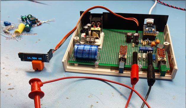

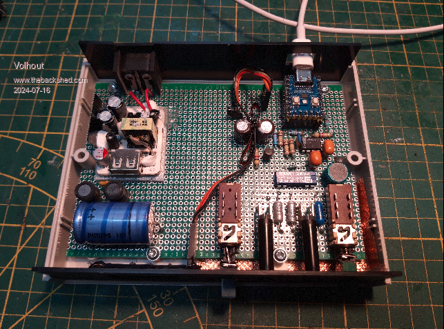

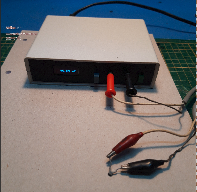

It is in a G738 box (same as the CMM2), and has a 4 euro phone charger as power supply. Since the charger outputs quite a lot of ripple, and old 4700uF cap came to the rescue. Not visible is the copper foil under the PCB, to shield the bottom from the outside world.

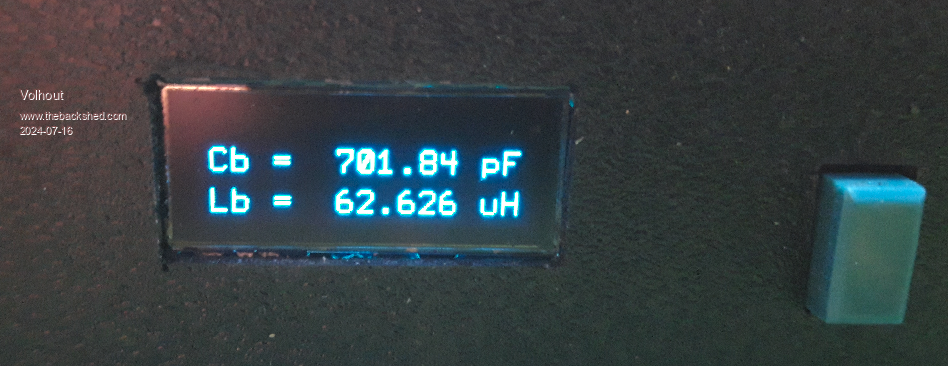

The Pico Zero uses the PIO to measure the oscillator frequencies up to 7 digits. It uses PIO 1 state machines 2 and 3, simply because the code is "borrowed" from my frequency counter that uses the other state machines from pulse and period measurements.
The "green" button switches between capacitance and inductance mode. The "blue" button acts as a push button, and zero's the reading to compensate for wires, or adaptor (note you can measure down to 0.01pF).
When there is interest I may draw up a complete schematic, but the circuit looks simple enough to do without.
If you are building, the 1000pF capacitor in the circuit diagram that is NOT identified as Ccal, needs to be a stable and accurate one. Try to find a 1% part.
The one identified as Ccal needs to be stable as well, but not accurate. Any film capacitor, or NP0 capacitor will do.

  Quote  When there is interest I may draw up a complete schematic, but the circuit looks simple enough to do without.
I'm very interested! I read through the source and identified the GPs. Which GPs are you using for I2C? I didn't find that in the source because I'm sure you've put it in the OPTIONS. If it's not too much work, a schematic would be nice.
Best wishes! Joachim
Posts: 4355
Posted: 12:42pm 12 Jul 2024
Er... it doesn't use I2C does it?
Posts: 5995
Posted: 12:45pm 12 Jul 2024
Hi Joachim, John,
The Pico ZERO uses:
OPTION SYSTEM I2C GP26,GP27
OPTION LCDPANEL SSD1306I2C32,RL
So YES, it is an I2C display....
It is this simple..... The circuit diagram.
It does not show the power supply and huge 4700uF capacitor, since that is not needed to make it work. Powering from the laptop USB works just as fine.
Edited 2024-07-12 23:28 by Volhout

Hello Volhout!
At the moment I can only find 1% capacitors with a value of 816 pF for the 1000 pF capacitors at a reasonable price. Shipping is usually more expensive than the item itself. Can I use it if I change Cref? If so, what value should Cref have?

Hi Joachim,
Yes, you can use 816pF as long as you put that valuing the program. But you can also do what I did. I used 470pF 1% parallel to 560pF 1%. Since these where the values I could purchase. It is all math, so if you just use thisvalue for Cref in the basic program, it is fine.
Technical: Cref is switched parallel to the total capacitance. When trying to measure a 100nF capacitor, the 1000 pf makes 1% difference(101 versus 100). Since frequency depends on the square root of the capacitance, the frequency difference is only 0.01%. When your target is measuring larger capacitors, 2000pF may work even better than 1000pF.
Edited 2024-07-14 03:59 by Volhout

Posts: 5995
Posted: 07:47pm 15 Jul 2024
Appart from the lettering on the front panel, it is complete,,,
Inside the unit
When you zero the unit, it shows what the corrections are (inductor and capacitor inside).
The unit in operation, measuring a 47pF ceramic capacitor, using a long coax cable with alligator clips, that is zero'ed out. Running from the 230V charger power suppy inside the box.
The display is small, but reading is clear enough to be readable. But I think the frequency counter (next project) needs a bigger display (more digits, so the font would become very small).
The current display is "hot-glued"  in it's frame. I did not bother to make a special glass for it (with my tools that always is uglier than the display itself).
Edited 2024-07-16 05:49 by Volhout

Posts: 5995
Posted: 05:19am 22 Jul 2024
Hi Joachim,
The circuit consists of 2 blocks: 1 the oscillator using the LM311. 2 the frequency counter using the pico.
First see if the oscillator works.
Switch to capacitor test.
If you disconnect the 6.8k resistor, there should be a nice square wave at the LM311 output (pin 7). It should be 5Vpp, some 500kHz…1MHz depending the capacitors and inductors used.
If you do not have a scope to monitor this, but you have a voltmeter, then re-connect the 6.8 k resistor, and measure at pico pin1, gp0. There should be 1.4v to 1.8v dc at that pin ( 3.3v with 50% duty cycle.
Edited 2024-07-22 15:27 by Volhout
