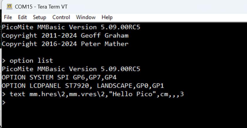

I've been trying to get one of the ST7920 Chinese Ebay 128 x 64 LCD's running with a Pico without any success.
I am running version 5.08.00 and have the display wired in SPI mode following the wiring in an earlier thread on here.
Like this
LCD Reset (pin 17) goes to GP3
LCD RS (pin 4) goes to GP5
LCD RW (data in pin 5) goes to GP7
LCD E (clk pin 6) goes to GP6
Then I have Gnd connected to pins 1,15 and 20 and VCC connected to pins 2 and 19.
First problem I have is when I do
OPTION LCDPANEL ST7920, LANDSCAPE,GP5,GP3
I get an error   'Error : duplicated pin'
I have checked and neither GP5 or GP3 are used for anything else, this happens from the get go after an 'option reset' and with no program uploaded to the pico.
Anyone else tried these type of display's and had them working at all?
Tony.
Posts: 8965
Posted: 07:03am 13 Jul 2024
I think you might need to set it up like this:
SETPIN GP5, DOUT 'the SETPIN commands may not be needed
SETPIN GP3, DOUT
OPTION SYSTEM SPI GP6, GP7, GP8 'this is the hardware SPI port
OPTION LCDPANEL ST7920, LANDSCAPE, GP5, GP3 'any pins can be used for these
You can't use that SPI bus for anything else as this display has a fixed CS that's always enabled. I must admit that I've not used one of these.

Hi Mixtel90
Thank you for the help, I have tried what you suggest,  following an 'option reset' I enter
SETPIN GP5, DOUT
SETPIN GP3, DOUT
and after entering the last line above I get Error : not valid SPI pins
Tony
Posts: 11647
Posted: 11:05am 13 Jul 2024
I think there may be a bug in the firmware for the ST7920. I can't work on it until later this month. In the meantime I wouldn't waste too much time on it until I have a chance to test/fix

Posted: 12:35pm 16 Jul 2024
Thanks Peter, I tried the version which seems to be the latest from the release candidate thread 5.09.00RC5 and I appear to get the same as with 5.08
OPTION SYSTEM SPI GP6,GP7,GP4
The last line gives
I'll have a search to see if I can find a later version in the thread, but scanning quickly on my phone, that was the only one I could see.

Posted: 06:12pm 16 Jul 2024
Peter,
I tried the 2024-07-16_212924 version, I no longer get the Error : duplictaed pin message, but the display shows garbage unfortunately.
I can see the data, clock and RS pins toggling nicely on the scope though now which RS was not doing on the previous version.
Tony.
Posts: 11647
Posted: 01:47pm 25 Jul 2024
This version is tested and working. I think the garbage was because I was clocking the SPI bus too fast.
PicoMite.zip
Connections as tested
GND - 1,15,20
5V - 2,19
GP0 - 4 (RS)
GP1 - 17 (RST)
GP6 - 6 (E)
GP7 - 5 (R/W)

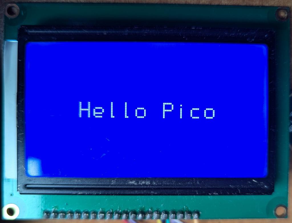

58kk90
Joined: 14/06/2023
Posts: 77
Posted: 06:17am 26 Jul 2024
Great thanks Peter, i'll try it this morning and report back ....
Tony.
58kk90
Joined: 14/06/2023
Posts: 77
Posted: 05:39am 27 Jul 2024
I can confirm that it works perfectly using the Chinese Ebay ST7920 LCD's
Tried both the white backlit version and the yellow backlit version, the yellow was the 3.3v version and the white was the 5v version, both work perfectly with the Pico.
Thanks Peter.
Tony
