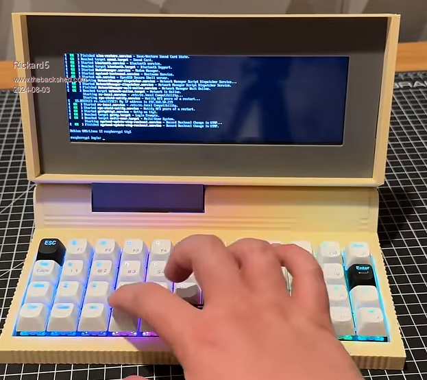

Last night I watched This Video 3-4 times, and I'm going to Build a Picomite Laptop
I've started Gathering Parts so I can start 3d Drawings :)
so Far I've got:

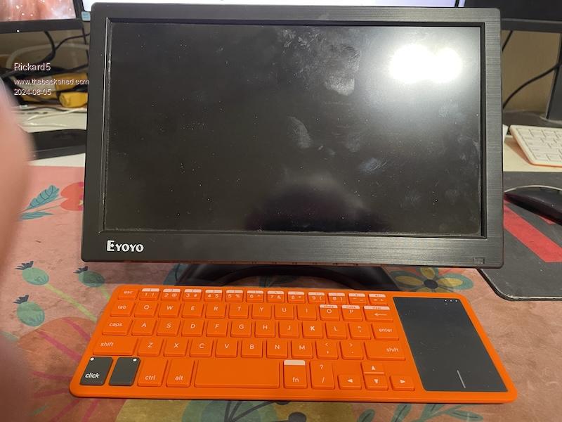

a  60% size Keyboard on order
I have a few Eyoyo 8" Monitos
But I have a Ton of Questions
1 Can I use aa USB Keyboard like Show'n here Time stamp 1:40
2 does anyone know of a Text LCD With an aspect Ratio shown in laptop picture I like that style like the sharp 8080 I have
2 is there a MMBasic for the Raspberry pi zero ?

Last question first, not a current one.
If you can find it there was a version of MMBasic for the Raspberry Pi but there was a lot of difficulty getting it to work through successive updates of the Raspberry Pi so it was dropped. It certainly never supported USB.
Tom's MMB4L is now the closest you'll get but it's far from complete and runs MMBasic on top of Linux.
You can have a normal USB keyboard and mouse on a PicoMite using the USB version of MMBasic.

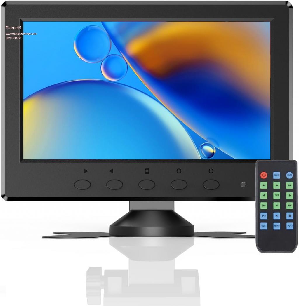

You will have to use one of the displays that MMBasic supports if you use a PicoMite. That could be a large LCD or one of the little VGA screens depending on your MMBasic version. The VGA input on that monitor will be fine.
Posts: 2807
Posted: 08:32pm 02 Aug 2024

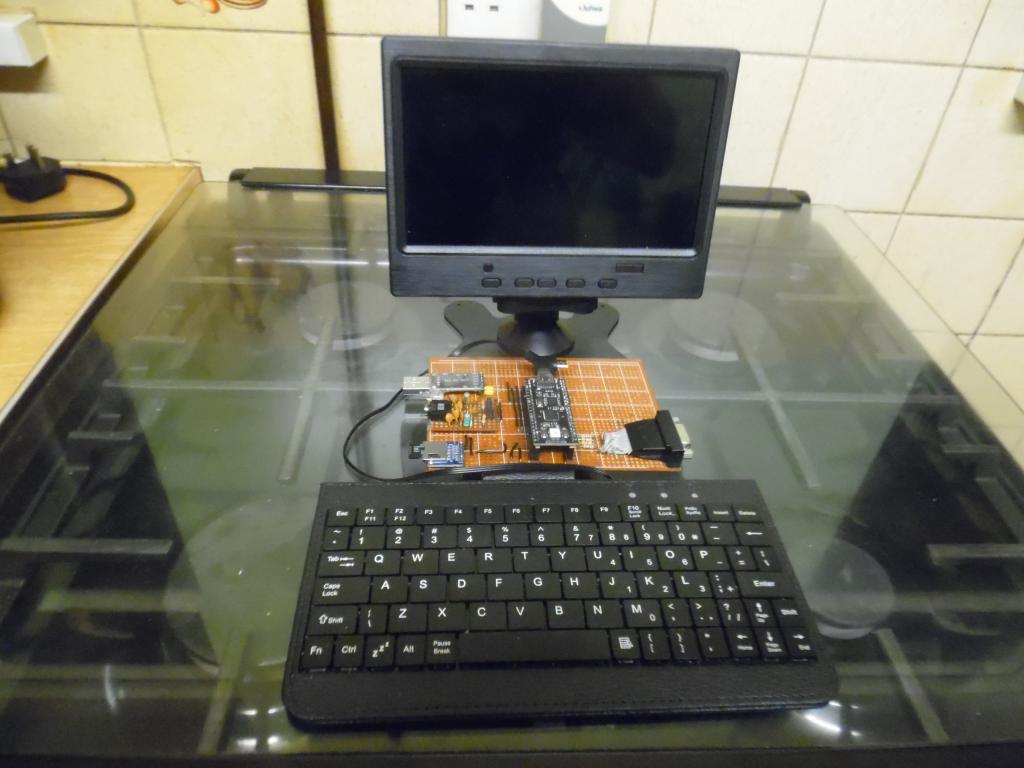

I've used a car reversing monitor with vga, large 8" screen and a usb mini keyboard with pico usb vga but not thought of a pico laptop. screen and keyboard were <£30
this got a swivel base so pico in a box and stick a mini usb key board on top, cheap option

reality is anything less than 12" and you can't read the writing and why are large displays more expensive tham a car monitor with vga,hdmi,composite avi?
Hey Mick
if I get the USB Version of MMBasic, and find an LCD will I have to inject power though a +5v pin and be able to edit programs on the LCD with the usb Keyboard ? or can I Use VGA monitor to do the same editing with a USB Keyboard? I REALLY WANT TO FIND A MONOCHROME 40 OR 80 Column x 20 line Dot matrixy  led/lcd screen something as retro as possible :)

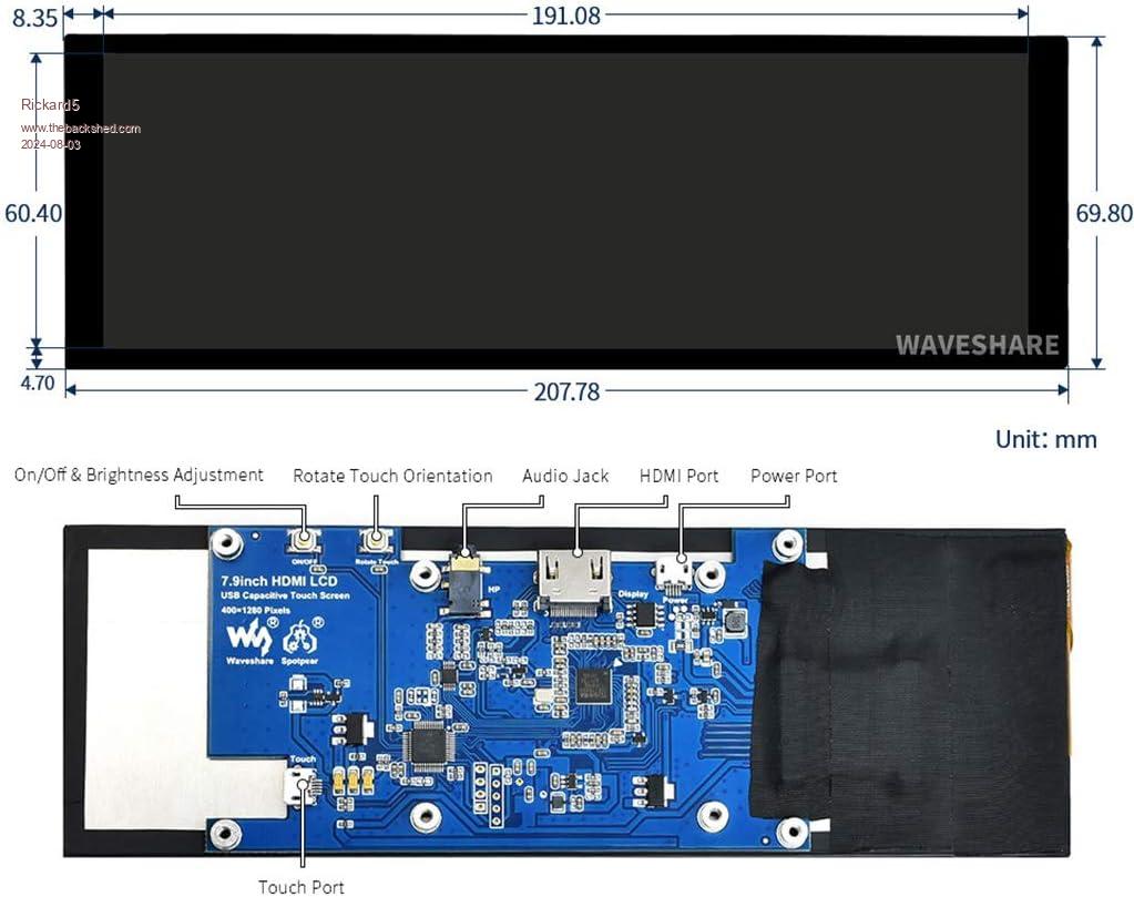

This is the LCD  I wish I could use
Posts: 8967
Posted: 06:44am 03 Aug 2024
Tough.
You can't drive it directly. You can get VGA to HDMI converters but MMBasic will only give you 640x480 in monochrome. You can't do anything about that.
Yes, the USB keyboard will let you enter programs etc. but you need a TTL console input for configuring stuff. That's usually done with a USB to TTL adapter of some sort. Once it's all up and running that isn't used.
The touch facility won't work with MMBasic either.

There is a larger LCD display supported by the PicoMite - see https://www.thebackshed.com/forum/ViewTopic.php?TID=17035

But when using those 7 inch VGA displays (approx. 17x11 cm), the keyboard should not be much wider than 20-22 cm. Unfortunately, I have not yet found a PS2 keyboard that is anywhere near as narrow.

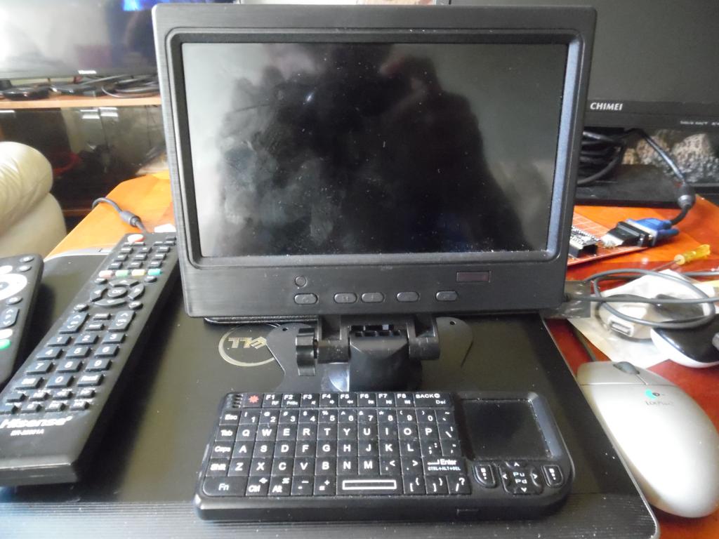

That was the point of my post and using usb vga pico. There's lots of cheap tiny or even a wireless micro with touch pad and laser pointer I got cheap.
mini ps2 keyboards are expensive.
For the keyboard to be the size of 7" vga then it would be micro like this and as fun as text typing on a phone

ps wireless keyboards work with usb pico. groovy
