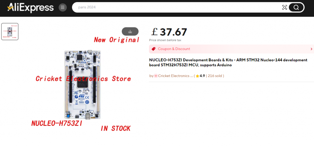

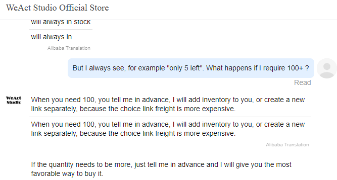

I have the Nucleo H743ZI2 but I also have several of the more compact, 100-pin WeAct modules.
On AliExpress, WeAct was only ever showing a limited availability and so I contacted them regarding future supplies:
The latest Nucleo:

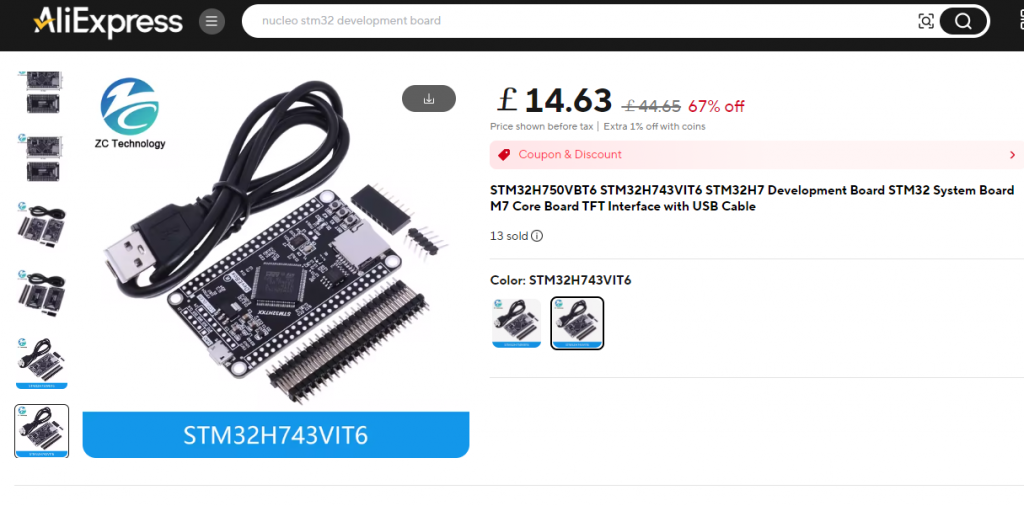

In addition to a Nucleo board (which I don't find on aliex after a brief search), I have used this H743VIT6.
Be very careful in ordering--there are many variants which won't work (insufficient memory, etc.). The "VIT6" did for me.

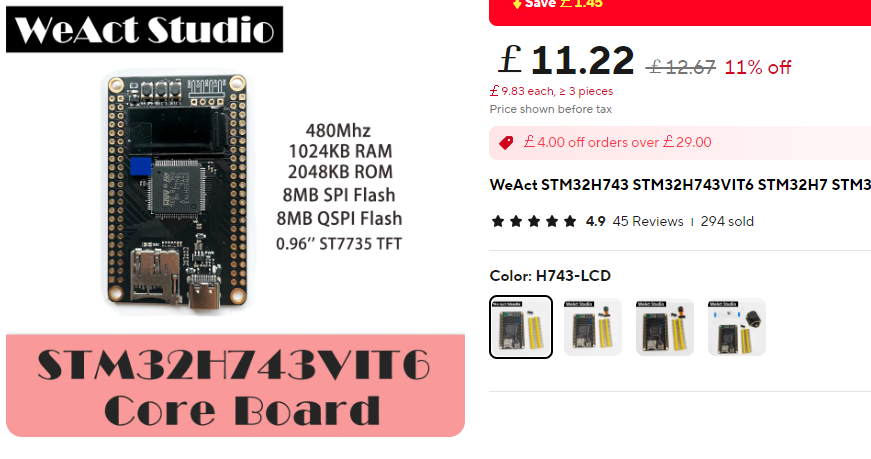

The 100-pin WeAct module (again)
The other alternative is the Devebox that others appear to be copying:

@lizby
The Nucleo now features the H753ZI device. I think it was KeepIS who confirmed that it was still MMBasic compatible.

In fact, the Mouser price for the new Nucleo is better than AliEx:

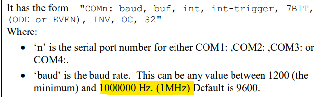

FYI:
I don't know if I have somehow missed the latest manual but mine still shows:
I have tested to 3MBAUD...The H7 won't recognize anything faster.

Hello Community,
It's me again, looking for a STM board, which could be MMbasic compatible, I found this STM-Board too. (see Link)
Is it compatible with MMBasic? Does anyone have experience with this board?
Many thanks in advance for your assessment,
Wolfgang
https://www.amazon.com/-/de/dp/B09GCD3WVD/ref=sr_1_1?__mk_de_DE=%C3%85M%C3%85%C5%BD%C3%95%C3%91&crid=2K2AJN0GUQTDX&dib=eyJ2IjoiMSJ9.OpyomquZPTF07tUG4EBtY4kK7kKYMTKezueDgViIhPMvTQwub4JC5BShTg2iW5KUbqc887fv78ywZGCo1uh8aZHBS1WSF3tsCTXLaV0K0lLN4DiaG_IwhHR8YMWOfRJ_STk_PpcS9RTSzxbBSxRL31uTVBKkCKYvsWJDskG6tkX8rnj9fOhB0oLoFkudPngcxq_xQInAzfFB4KUlendGm8CiCIcrSZlqTHeMGPV8Y_c.AptRUxsDupXp0bIrYPTs-DkFtMnjtrw1I62dNljvows&dib_tag=se&keywords=STM32H750VBT6+Development+Board+ARM+STM32H7+Programmable+MCU+Controller+STM32+Cortex-M7+System+Board&qid=1724315173&sprefix=stm32h750vbt6+development+board+arm+stm32h7+programmable+mcu+controller+stm32+cortex-m7+system+board+%2Caps%2C644&sr=8-1
Posts: 11830
Posted: 08:54am 22 Aug 2024
No: H750 only has 128Kb flash so not enough room for MMBasic
