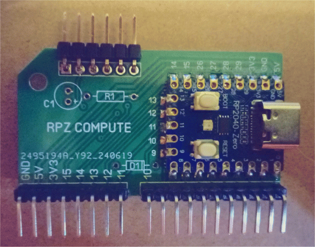

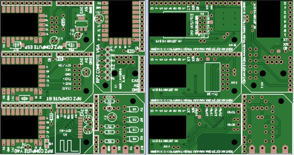

  Rickard5 said  I'm looking at building it modularly with 1 Master Pico that is the User Interface, and modules for Speed control and Stepper
You mean you basically want Mick's RPZ system with additional modules (if actually needed)?
Mick's RPZ Compute
Edited 2024-08-12 11:03 by lizby
