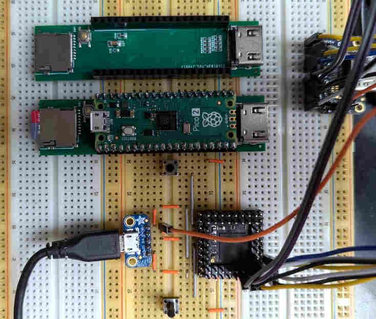

What Pico2 hardware are you using?
Based on the info you’ve mentioned, I’ll guess Pimoroni Pico Plus 2 with the Adafruit DVI breakout board 4984
Posts: 11653
Posted: 08:43am 22 Aug 2024
  Quote  What Pico2 hardware are you using?
My own little adapter board (gerbers on the other thread ) and a breadboarded Pimoroni PGA2350

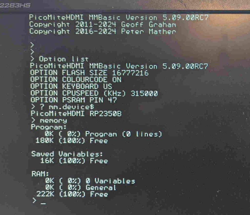

For completeness, I have run the BubbleUniverse on this HDMI version, as well as the others and get the following results:-
2040  VGA  @ 378MHz bubble runs at 286mS per frame
2350A VGA  @ 378MHz bubble runs at 163mS per frame
2350A HDMI @ 315MHz bubble runs at 191mS per frame
For VGA approx. a 1.75 times speed up, over 2040 VGA. :-)
For HDMI approx. a 1.5 times speed up, over 2040 VGA, only limited by the fact that the core frequency is 315Mhz (HDMI clock requirement) as opposed to 378Mhz for VGA.
Not too shabby. I'll have to increase the number of points it plots to slow it down again ;-)
Otherwise everything I have so far tested is working fine on the PicoMiteHDMI, display quality looks good stable & sharp & full screen. :-)
