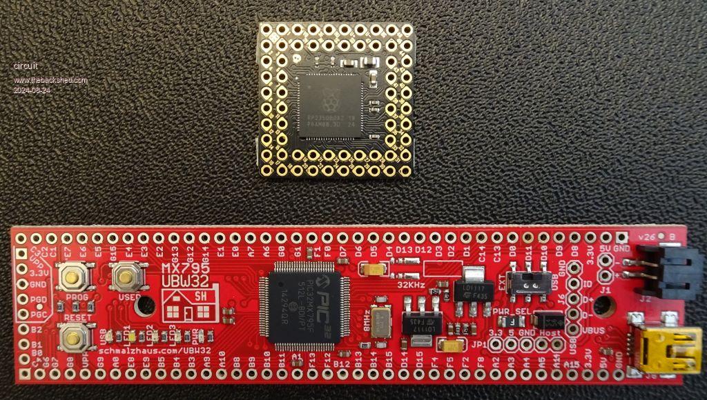

I greet with delight the introduction of the 64 pin RP2350B and the port of MicroMite Basic to this chip.  Peter, my gratitude for, and deep appreciation of, your most selfless work on these projects is without bounds.
The only current embodiment of the 64pin version that I can find is the Pimoroni PGA2350; a board that I find rather absurd.  It is hardly a development friendly outline.  What I would really welcome (and I assume would any others who work with stripboards and breadboards in their development projects) would be an RP2350B mounted on a straightforward long board with 32 pins on each side in the manner of the now obsolete MX795 board by Sparkfun.  I have several of the Sparkfun boards and, despite the version of MMBasic for the board having had no development for several years, I find the layout so compelling that I continue to use them from time to time.
The picture below shows a Pimoroni PGA2350 board next to the MX795 board; given a choice, which format would YOU prefer to play with?
So here is a call to manufacturers or to those with contact to them, perhaps Sparkfun or Pimoroni, to mount up an RP2350 on a board in the format of the MX795 (UBW32) board.  I am sure that this would sell rather well! (I would be first in the queue.)

The problem is, what would it cost?
The PGA2350 is £9 here. The cost of 5 custom made PCBs is less than £9, so total cost for one is £18. You can then get another 4 identical builds for £9 each if you just buy more PGA2350 modules.
The MX795 is about $50 each - almost three times the price of one PGA2350 setup.
I'll bear this in mind for a future project.

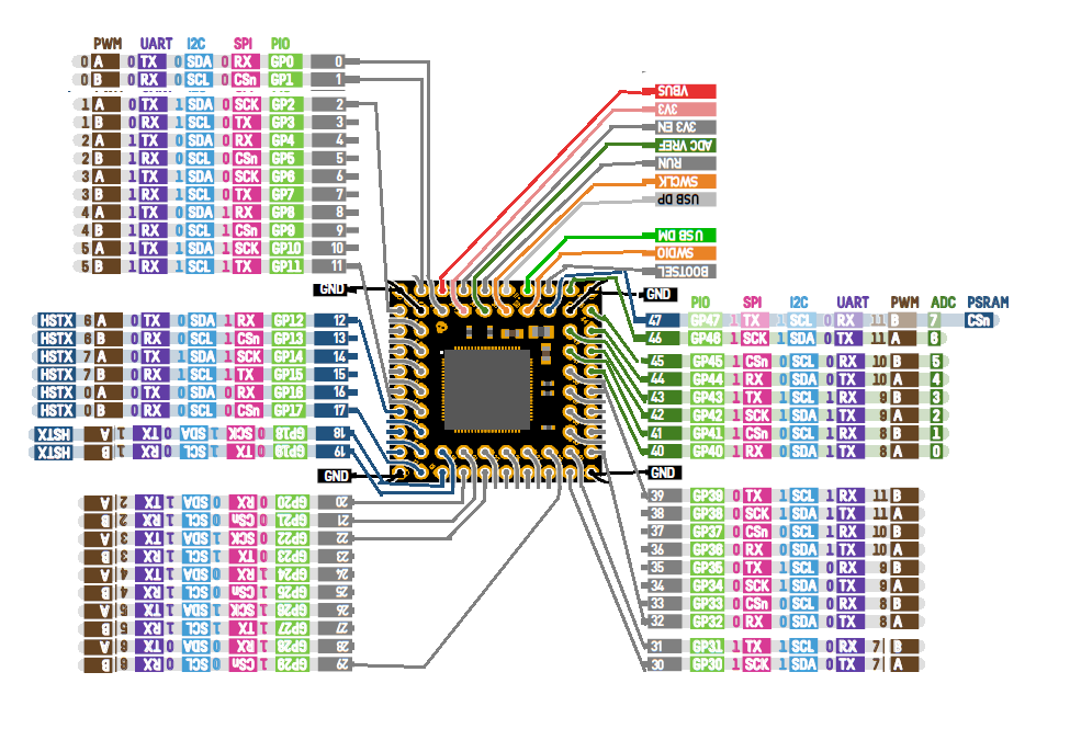

My board will be a Pimoroni PGA2350 perched on some stripboard.
I need to add some gnd lines to allow for the run and boot buttons and rearrange the USB pins to suit my breakout board but you get the idea.
My PGA modules will arrive this week...

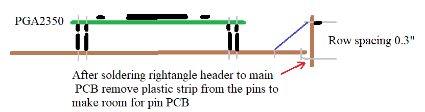

A breadboard adapter for the PGA2350.
Could be a PCB or stripboard with a lot of wire links.
It should work well with Jim's layout above by extending the wires from the second header strip to the opposite end of the board.
Edited 2024-08-25 15:26 by phil99
