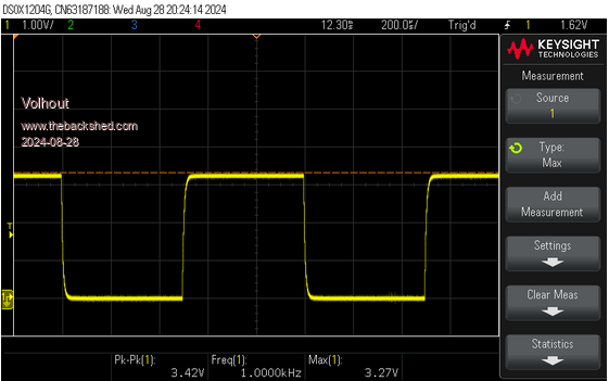

I have a 1kHz signal from a generator (3.3V), looking like this:

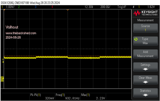

With a series resistor of 100k (yes, that is high impedance, but not terribly high) I apply this signal to a Pico2 GPIO pin (in this case GP0). This Pico2 is flashed with MMBasic, but NO PROGRAM IS RUNNING. This is just the default GPIO pin configuration after power up.
This is what the signal looks like:
You really need to drive the pin low impedance. High impedance will not work. Forums say that 9k ohm is maximum.

EDIT: on my RP2350 Pico2, 10k ohm series impedance works when the signal is perfect (0V/3.3V), 20k ohm definitely not. So on my Pico2, I need 10k or lower as pulldowns.
