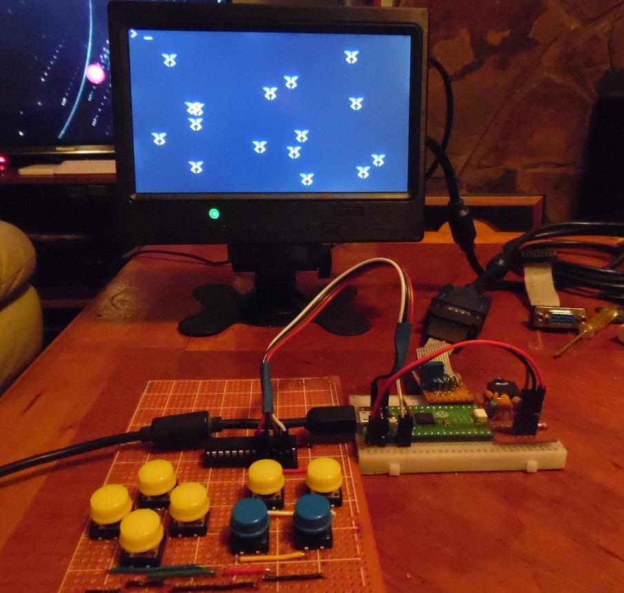

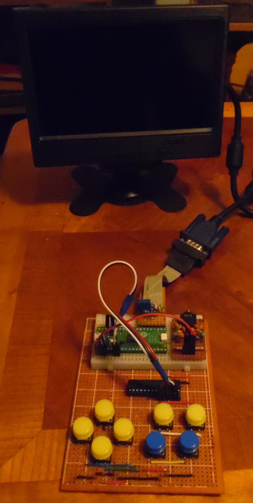

Here is part of my earlier struggle, with Volhout's explanation below which made me (at the time) better understand how it worked. No resistors involved.

  lizby said  Here is part of my earlier struggle, with Volhout's explanation below which made me (at the time) better understand how it worked. No resistors involved.
I like lizbys preference. I used the weak pull ups and checked pins grounded

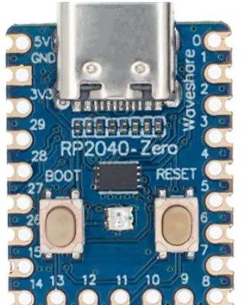

Posted: 06:45am 06 Sep 2024
RP2040-Zero over I2C?
Program it to do what you like - it could even trigger an interrupt on pin change.

  Mixtel90 said  RP2040-Zero over I2C?
That sounds like overkill, likewise using an 80-pin 2350 so there is more GPIO.
