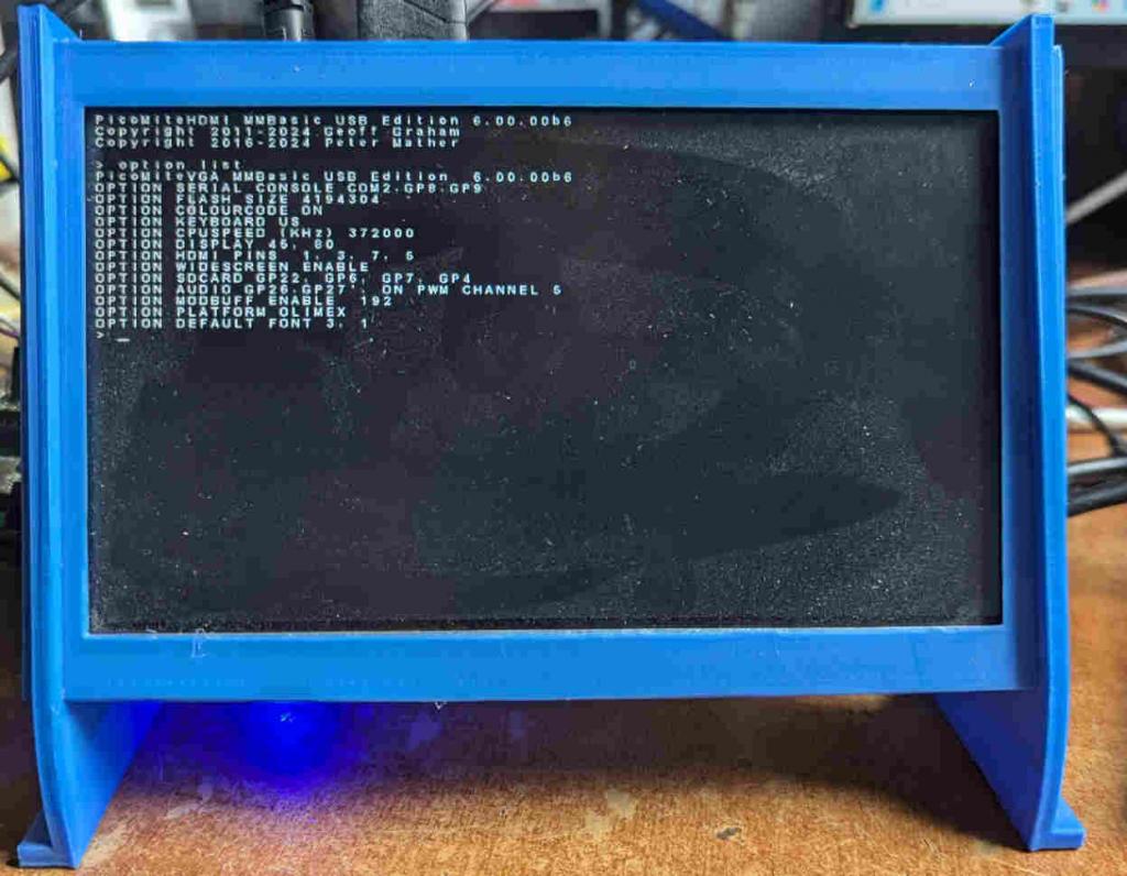

Too bad, it doesn't work for me (720p, all modes), even though it's a full HD monitor (HP 2309m) with DVI input.

I've checked it both normal and USB versions using a bog standard 1080p monitor. I've also checked the signals on the scope and the clock timing is pretty much perfect.
720P is a TV standard rather than a normal monitor standard but is the only widescreen mode that has a clock speed in range of the RP2350 - 371.25MHz (rounded to 372MHz - 0.2% error). My monitor is perfectly happy with a 375MHz clock speed so I don't think the trivial error is the issue - the advantage of a clocked system unlike VGA.
Are you using  270 ohm series resistors on all lines? My tests are using my little I/F board and the Olimex board. In both case the signal lines form the Pico2 to the HDMI socket are very short. At 372MHz signal integrity is likely to be an issue if breadboarded.
Even works on one of the little 800x480 displays with the multi-input adapter board
Edited 2024-09-07 02:23 by matherp

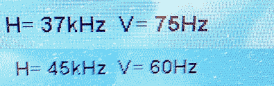

As feared, no improvement at the other entrance. This shows the OSD info normal 4:3 vs 720p:
Edited 2024-09-07 03:01 by homa

  Quote  This shows the OSD info normal 4:3 vs 720p:
The 720P timings are exactly correct see here
