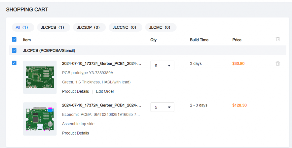

Total hardware newbie question here, so please forgive my ignorance - but I've never ordered a PCB before.
I've been spreading the gospel about the Colour Maximite 2 to some of my friends, but alas we have no suppliers left in Canada.
So, I thought I'd better explore the option of getting some made myself. After reading Peter's post on the design files (link below), I downloaded them (I got the newer set from his 10th July comment) and uploaded them (both the Gerber and Pick and Place files) to JLCPCB.com
They quoted my $160 Canadian dollars for 5 populated boards (plus $50 shipping).
Is that all there is to it? Is there anything else I should be doing/looking for?
Like I say, please forgive me if this is a stupid question - but I'm a total newbie to this. But if I can get CMM2's for about $40 each, I know what I'm giving everyone for Christmas!

Yes, that's pretty much all there is too it.
So long as those two items(the PCB and the SMD assembly) are in your cart, you then just choose your address, choose your shipping method, pay the grand total, and wait for the box to arrive.
JLC make it pretty painless to do, and once you have done the order ONCE, you can - if you want - reorder them again at the click of a REORDER button.  You don't need to re-upload the gerbers or the BOM/CPL, JLC will reuse those files from your original order.

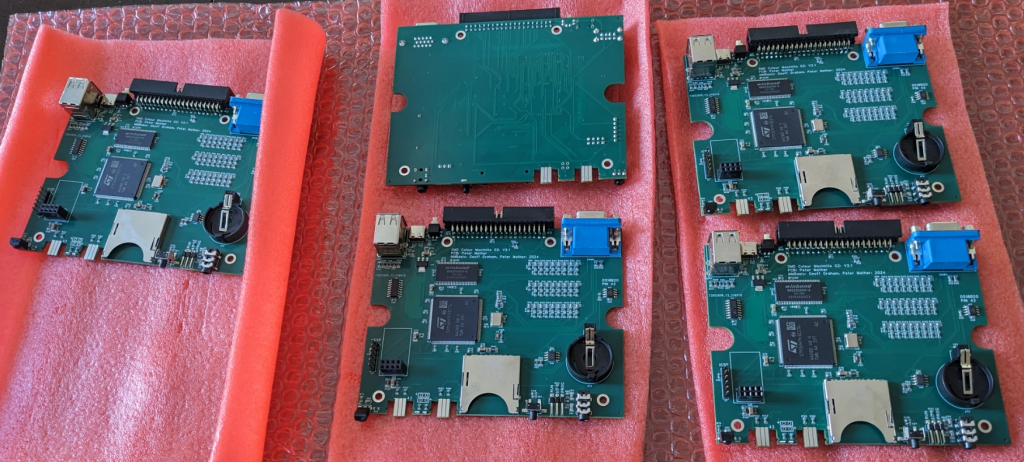

A quick update. The 5 boards arrived (a day earlier than expected). I grabbed the first one off the pile, blew the firmware into it, and..... it worked.
That was so painless.
Final cost was $325.91 (Canadian dollars) including shipping and taxes for five brand new CMM2 computers.
A small point, the JLC website does allow me to select CAD$ for the price, but it never remembers it and reverts back to USD$. Not a big issue, but I was a bit confused by the price until I realised this.
But that still works out at just $65 (Canadian each). ($47 USD, 43 Euro, 36 quid). Of course, you need to buy a power supply, SD card and CR2032 battery (I have all of those lying around - as I'm sure most people do) - but this is bloody brilliant.

  PhenixRising said  Not a big deal but I was wondering if one has the option to exclude a component?
Sorry, I missed this question. Yes - after you upload the Bill Of Materials, the website displays a list of all of the components with a tick box next to it. It looks like you can just uncheck/untick the box and it will be excluded.

Final update. I'm happy to say that all five boards worked flawlessly. For anyone else doing this I did also order some tiny little extras (that only added a couple of loonies* to the price of each).
