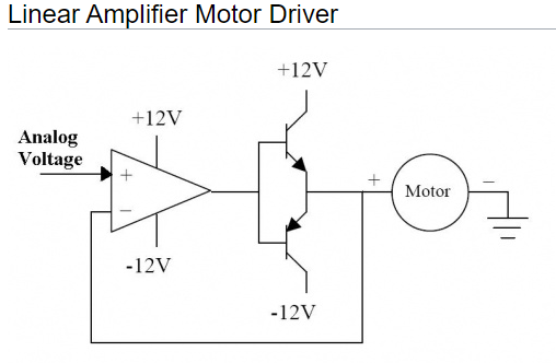

I have been searching for a full schematic for something like this:
It's for my small brush-type motors.
My command signal is +- 10V where 10V drives max current in one direction and -10V drives max current in the other direction and of course, 0V is null.
Current output <2A but adjustable gain (pot?) would be a plus.
I had several of these, back in the 80's but now I can't seem to locate one and I'm useless at designing this stuff

Hi Phenix,
The circuit you provided has voltage feedback, not current feedback. I basically makes sure the voltage from the DAC is put across the motor terminals. So the motor received -10V...+10V, regardless the current that is running.
Why not look at DC motor control IC's ? These provide all the control you need, and sometime even have a build in power stage for < 2A. Such as the BD62130 (Rohm) or A4952(Allegro). You control these directly from 2 PWM outputs on the pico.
EDIT: if you insist in going linear, I would look at car radio amplifier IC's. These provide the current, and the protection, at low cost. Then combine these with a simple opamp that does the +/- 10V conversion to the car amplifer IC input and feedback (the car amplifier IC's do not have the DC accuracy you may require).

  Volhout said  Hi Phenix,
Oh, the intention of the schematic was to merely illustrate that I am looking for something that will accept an analogue command...don't want PWM, I have lots of those.

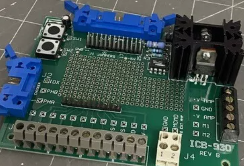

How about this?
Posts: 5994
Posted: 11:45am 10 Sep 2024
Why not, that is a single channel, but should be usable.
You can also find them at Aliexpress for like 7 euro a pair (2 pieces).

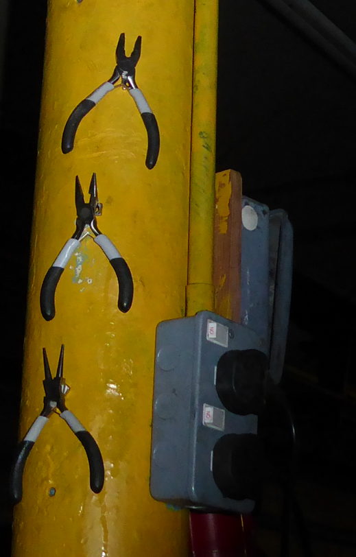

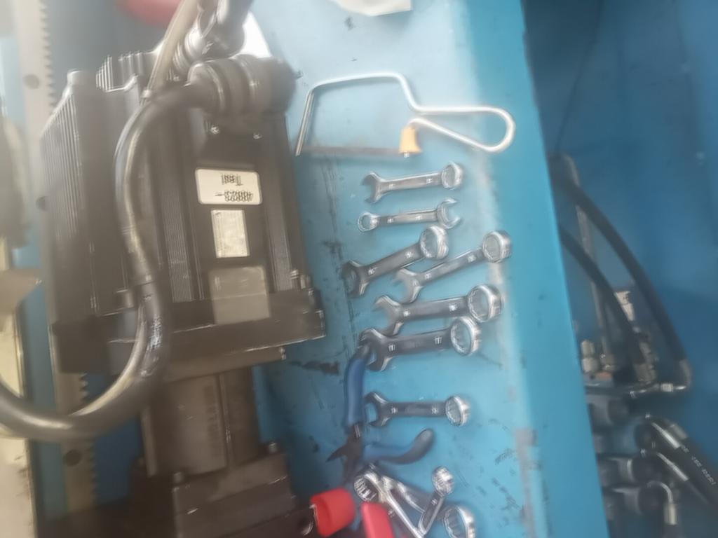

Posts: 2807
Posted: 06:35pm 10 Sep 2024
is the magnetic field so strong spanners stick? :)
PhenixRising
Joined: 07/11/2023
Posts: 2006
Posted: 06:50pm 10 Sep 2024
My tools are weird like that

I actually located an image:
The amp requires a +/- PSU (IIRC, 24Vmax)
The motor command +/- 10V is merely a reference; 10V command = max motor-current say, clockwise and -10V command = max motor-current counter-clockwise.
There was a gain-setting resistor to scale the amps/volt of motor-command.

So it's the actual amplifier that you are looking for?
The sketch right at the beginning is something to work with. Personally I'd use a full H bridge as torque is proportional to the square of the armature current and a full H gives you twice the voltage therefore 4 times the torque. The second half-H is driven by an inverter from the input to the driven half-H.
I'd look at the possibility of fitting some current feedback somehow too. It would be sad to see smoke arising from the bridge devices if the load gets a bit sticky. One of the "ring" type hall effect sensors would be good here as they can be bi-directional and actually fitted to the motor output, although you could equally well use one unidirectionally on the main supply to the H bridge.
Any linear output devices will get *HOT* if you are considering 30A. It might be an idea to consider some sort of PWM and let the load's inertia act as the filter. That way your output devices are always hard on or hard off - juicy MOSFET territory, but P-channel might be difficult to get so it gets more complex.
