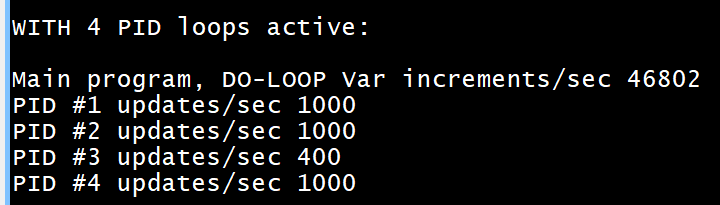

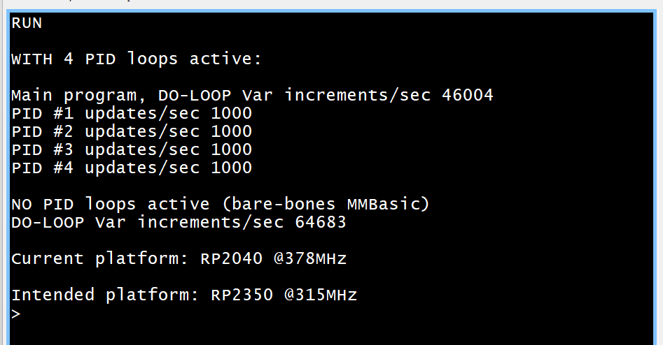

Tested with T at 0.001 seconds and it still works fine. Of course you wouldn't have a print statement in the interrupt routine in a real-world application
Boy do I feel like a rude and ungrateful so-and-so
My sincere apologies to Peter Matherp.....I totally spaced-out and forgot about this. The very thing that I am obsessed with and I didn't get back to it
