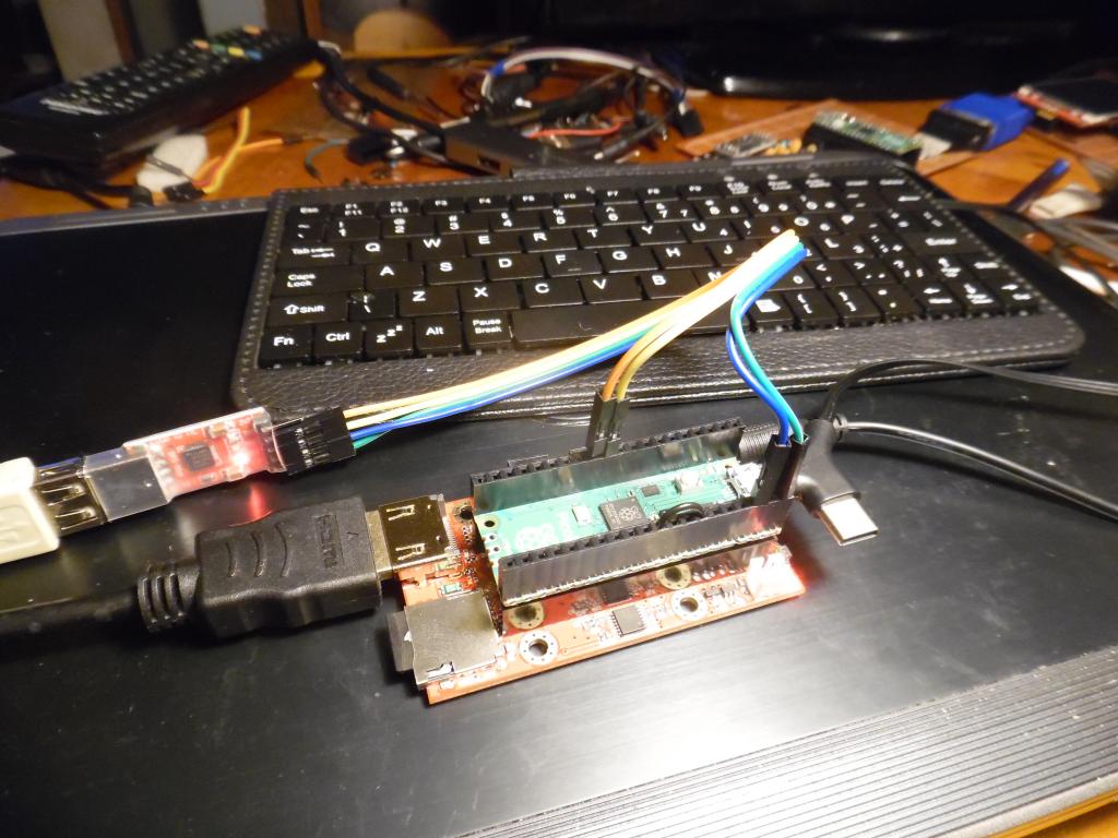

olimex dev board. it's brill but commercial and other pcb on forum but got to say imho it's very tidy. best pcb I've used as am vero/strip board fan.
sd card reads, hdmi ok , well mode 1 flickers. usb kb ok ,3.5mm sound ok. it's brill with support... reset olimex
little  details. where is 5v vbus input pin to power pico and usb kb unless got headers? it's great with pico2/2350
Posts: 8965
Posted: 09:45pm 24 Sep 2024
The micro USB socket on the Olimex is the 5V DC input to power it. It's connected directly to VBUS. The data pins on it aren't connected so it doesn't do anything else. With that connected you can use the USB on the Pico to power a USB hub when you are using the USB firmware.

Posts: 2807
Posted: 10:08pm 24 Sep 2024
when using usb the usb to ttl 5v out pin powers the vbus which powers usb kb and the pico.  the olimex board usb would not power a usb keyboard connected to the pico board usb.
the 5v from usb to ttl must go to vbus pin 40 but no connection unless used a headeron that pin
Posts: 8965
Posted: 06:38am 25 Sep 2024
The Olimex is designed to be powered from it's own USB socket. That is connected directly to VBUS (pin 40) on the Olimex so it powers the USB socket on the Pico. You can then use that in Host mode and plug a (non-powered) USB hub into it.
Don't get power from the USB to TTL converter. You only need the data lines and GND.
In this way the Pico is always powered from the Olimex only. You don't need headers.
GP8, GP9 and GND are also available on the 10-pin connector on the Olimex so, if you connect the USB to TTL converter to those, you don't need headers for those either.
Note - you never connect the USB on the Pico to the PC on a USB setup unless you are loading MMBasic into it, in which case you disconnect all other sources of supply. It's in Host mode so it won't work with a PC anyway.

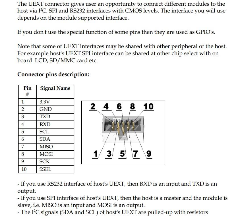

From two of my earlier posts.
Available on the connector are:
PIN
1       3V3
2       GND
3  GP20 COM2 TX
4  GP21 COM2 RX
5  GP9  I2C SCL (with pull up)
6  GP8  I2C SDA (with pull up)
7  GP4  SPI MISO
8  GP7  SPI MOSI
9  GP6  SPI CLOCK
10 GP5  SPI CS
I have the circuit here. :)
The 3-pin has GP0 & GP1
CON2 has GP2 & GP3
The 10-gin has GP4, GP5, GP6, GP7, GP8, GP9, GP20, GP21
The HDMI socket has
GP10, GP11, GP12, GP13, GP15, GP15, GP16, GP17, GP18, GP19, GP26
Audio has GP27, GP28
The SD card has GP22, GP4, GP6, GP7 (it shares the SPI with the 10-PIN)

Posts: 8965
Posted: 05:13pm 25 Sep 2024
CON2 is connector 2 on the Olimex. They put GP2 and GP3 on it and called them I2C1_SCL and I2C1_SDA.
There is also DBG1, a 3-pin connector with GP0 and GP1 on it, labelled UART0_TX and UART0_RX.

Posts: 8965
Posted: 07:47pm 25 Sep 2024
Pins 5 and 6 of the 10-pin will probably work fine as GP9 and GP8 respectively. The Olimex has 10K pullups on them, but they have those anyway when used for a PS2 keyboard. A USB-TTL converter would probably have no problem - and they are the standard default pins. Note though that GP8 and GP9 are COM2. when used like this. You can't also have COM2 on GP20 and GP{21. They can be I2C though, if you provide your own pull ups.
Olimex's labelling is what they intended for Python. It has nothing at all to do with MMBasic. We can do what we like with the pins that aren't hard-wired to things.
Posts: 8965
Do you mean to a Olimex, Plasma?
Basically it's like all the others.
Power has to be vie either the USB port on the Olimex or on a header pin on pin 40.
You use a USB to TTL converter on a COM port to get the console connection. GP8 and GP9 are the standard pins.
When you load the USB version of MMBasic the USB port on the Pico goes into Host mode and can't be used for the console.
You then plug a passive (non-powered) USB hub into the Pico and plug your keyboard, mouse, game controller into that.
