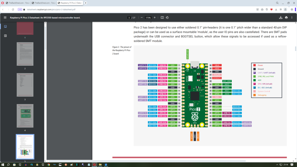

The increasing configuration flexibility of micros is creating a bit of a chicken-and-egg problem. Developing software requires something to test on, there are often supply problems where often there are alternatives available but not the specific model needed. and designing a pcb to fit existing pin connections means fishing through a lot of possible combinations and designs.
It might be useful to come up with a naming system and/or depot of configs so that the details can be found easily via searches  (?).
Maybe an id of initials/company + number + pcb ref  with a page that then lists the pins config.
Eg I found a basic pi2350 config which was useful for a quick hack assembly, It just used wires without a pcb. As it happens it worked across pico 2, pi Moroni Tiny, pi Moroni LGA-2350. [Don't know about MMBasic.]  Without an id it makes it hard to reference it or the details.
GP4     (spi0)RX
GP5     (spi0)CS
GP6     (spi0)SCK
GP7     (spi0)TX
GP12    (i2c0)SDA
GP13    (i2c0)SCL

The golden rule is *always* use GPnn numbers for everything in MMBasic if you can (there are cases where you can't).
What a particular pin *does* is (usually) decided in software now. That makes it *much* easier to lay out PCBs.
For maximum software compatibility you have to start being clever, but that's the price to be paid for having flexible hardware. You *could* fix hardware pins to specific jobs, but PCB design gets difficult and you may even run out of pins because there are more possible functions than available pins now! 16 pins gone on 2xSPI, 2xI2C and 2xCOM.
MMBasic now contains the OPTION system that will auto-configure it for any board that has been registered. That seems to sort out the firmware. After that it's the hardware. At the moment you won't find one board that can do VGA and DVI. I've done one that you can build as alternative versions and Alpha is half way to being able to be easily modified to change it over from one to the other. Of course, it doesn't support PS2. :)

The situation I am addressing, is developing software for a micro with a lot of configuration possibilities but is very new.
You want the software to be runnable on a fair number of pcbs and modules, which will be developed by others. When the info about the connections used by those pcbs/modules  becomes available it is usually not available in a standardized way, meaning a slog through a slow feed of sometimes hundreds of pages and posts, often without readable schematics or even searchable ascii text.
So what I am suggesting is identify some generic config states, labeled with id's of some kind, that can be found by search engines easily.
Eg I wanted to develop software for a rp2350. I used a very basic wiring, with spi accessing a sd card and also an i2c two wire bus, so, a defined configuration. So I identify that configuration with a unique standardized label and post it.
eg a label "rp2350[sd/i2c]0spi4.5.6.7,0i2c@12.13(xyz001)" which identifies the micro, the functionality used, the pins used, and initials and number xyz001. This would be used on a description post or page somewhere to be collected by search engine.
To search for compatible boards etc the label can be used. And then when it comes to comparing or discussing the particular config eg to say whether a pcb is compatible or not, the config label can be used instead of trekking through the details.
Just a thought and it needs development  but it would be so useful.

I realize the bit about schematics, the point is that there shouldn't be any need for the user of a board to need to use one. It's all very well saying that a pair of pins are allocated to SDA0 and SCL0 but those names are only valid for the language the board was designed for. Saying that they are GP0 and GP1 allows you to configure them in any language you like as those names relate to the processor, not the language.
This is very important on the RP2350 as, across 48 IO pins, you have 12 pins that can be SDA0 and twelve that can be SCL0 - and you don't have to use adjacent pairs. :)
PicoGAME SPGA would be an interesting config string when you get to the joystick/controller/I2C/COM port that can use any combination of GP0,GP1,GP2,GP3,GP45 and GP46. The latter two are also COM1 for the ESP8266 and ADC pins on the back and alternatives for pins 5 and 9 on the controller port, which are usually GP4 and GP5. Or something like that.  :) It might do SPI too, but I haven't checked that. :)  And that's without hacking the board. You see why documentation is important? (Even I'm confused. Goes off for a coffee and a couple of dried frog pills.)
