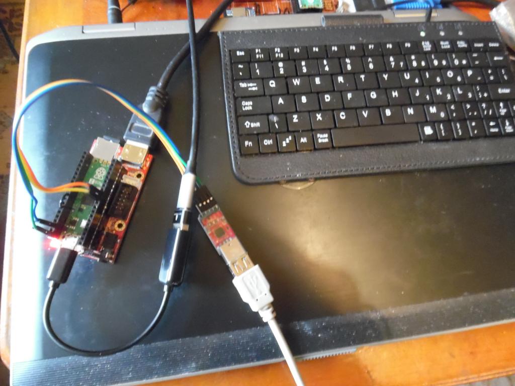

Anyone using olimex 2350 hdmi usb?
I ask because when I flash the hdmi usb it runs as vga hdmi usb and can't reset olimex.
When I flash pico hdmi it works

hdmi usb firmware
I got usb to ttl connected to gp8,gp9 and flash hdmi usb says vga hdmi usb but usb to ttl works connected to win and terminal option list but option reset olimex says invalid board

How  many times do I need to say the same thing? - you have asked the same before and I explained then
OPTION RESET OLIMEX is not valid for the HDMIUSB firmware only the HDMI firmware. The concept of OPTION RESET is that is configures a board WITHOUT any other additions to work "out-of-the-box". The Olimex needs an additional USB/UART to work as a USB host and therefore is not supported in HDMIUSB firmware.

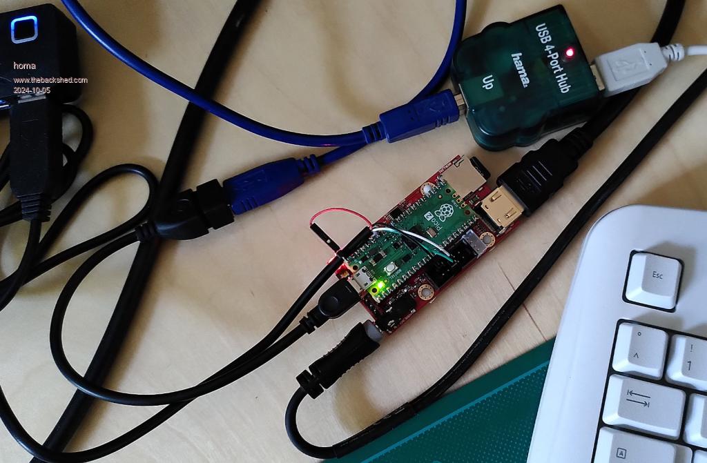

I use it.
OLIMEX Connector
1 3.3V  -- 3.3V p36
2 GND   -- GND  p38         -- ok black
3 TXD   -- GP20 p26 com2 tx
4 RXD   -- GP21 p27 com2 rx
5 SCL   -- GP9  p12 com2 rx -- ok green
6 SDA   -- GP8  p11 com2 tx -- ok white
7 MISO  -- GP4  p6  com2 tx -- ! sd
8 MOSI  -- GP7  p10         -- ! sd
9 SCK   -- GP6  p9          -- ! sd
10 SSEL -- GP5  p7  com2 rx

@Peter: an “OPTION PLATFORM OLIMEXUSB” would be really nice and desirable.
You can also do without a console (COM2 ), then I supply the board with a USB power supply via the USB port underneath and have a small standalone computer :-)

Just set the options by hand - it isn't realistic to add every variant of how a board might be used

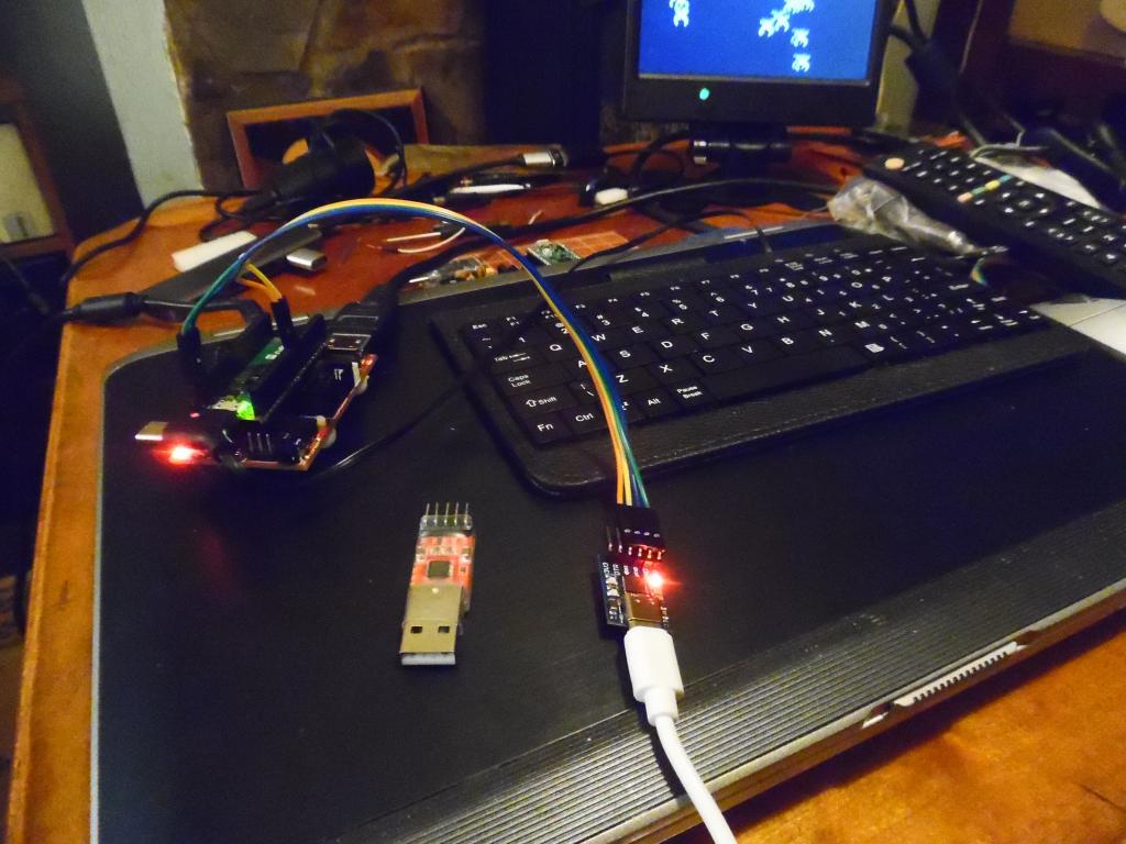

Posts: 2807
Posted: 04:18pm 05 Oct 2024
@homa. Yes, manually set options works! Thanks.

it complained OPTION CPUSPEED (KHz) 372000 - invalid? but works for you?
> option cpuspeed 372000
Error : CpuSpeed 126000, 252000, 378000, 157500 or 315000 only
regards, stan

Posts: 8965
Posted: 06:23pm 05 Oct 2024
RC2 vs RC4
