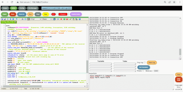

  Volhout said  I tried the build in editor, and each time I would go to the output window it would resize back to default (I made the window bigger, and choose a different font).
When you resize the windows in Annex (after clicking in the log pane and then clicking Ctrl+Shift+F2), when you have things sized as you like, you can click Ctrl+Shift+F3 to save the configuration.
(Not sure about font changes, though.)
This is my preferred layout:
  Quote  In WebMite you run a basic program and the html is not in the driver seat. From what I saw in Annex (code examples) the basic is executed slave to the html. I hope I have that right, but it does not matter really.
You can write a program in Annex which is "procedural" (like MMBasic), but you get its full power by using its "event-driven" features (which are sort of as if things happen in several SETTICK events).
After your initial setup, you issue a WAIT (which is like an endless empty DO: LOOP).
Then code is run when external things happen, like OnHtmlChange, OnHtmlReload, OnEspNowMsg, OnUDP, Timer0, Timer1, OnSerial, onSerial2, OnMQTT.
So if your program is driven by external events, all of your code executes as a result of some event having been triggered (which can be a timer event, so you can do certain things on a regular basis).
Edited 2024-10-20 01:18 by lizby

Hi Lizby,
I tried your suggestion (Ctrl_Shft_F2 and F3) while focus(mouse click) in log plane.
For me it does not work. Running on Node-MCU (ESP8266-12). Or is this browser dependent ? Annex 1.50
Tried Opera and Brave browsers.
Edited 2024-11-04 05:41 by Volhout

Ctrl_Shft_F2 and F3 work for me in Brave to reposition and save the panes in the editor window with an ESP32 (under Windows). I am usually using Chrome. Opera does not connect to the device for me at all.
I doubt this works on the ESP8266. There has been no new development there for several years (except for a few minor tweaks). The editor resizing is within the past year, if I recollect correctly.

Harm,
The screen Lizby shows is for an ESP32, ESP32-C3, ESP32-S2, ESP32-S3 with Version 1.53.4 and higher, the Ctrl+Shift has been added and the latest version is 1.70.1.
This is in the (?) help.
These keys are always active
- CTRL+SHIFT+F1 - Set vertical layout
- CTRL+SHIFT+F2 - Set horizontal layout
- CTRL+SHIFT+F3 - Save layout
- CTRL+SHIFT+F4 - Load layout
- CTRL+SHIFT+F5 - Reset layout
There is a "visual" flash of the screen when these keys are used.
Updated keyboard shortcuts for Editor (?)
The ESP8266 or ESP01 has less RAM memory, which is why cicciocb stopped at version 1.50, which will probably be the last version.
This version does not include all the nice things like saving the editor screen and dark mode and sub and basic programs etc.
The ESP32-C3 is the successor to the ESP8266 and the ESP32-C3 super mini is very cheap on AliExpress, but there is also an ESP32-S3 super mini.
In the editor there is a row of buttons and a blue question mark (?) containing the options.
Unfortunately, with version 1.50, these Ctrl+Shift commands are not in the help and you have to adjust them each time in the editor.
The online flash only works in Chrome.
Jan.

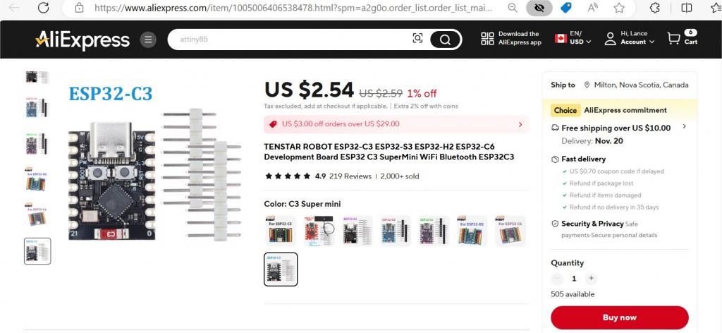

I'd certainly recommend buying an ESP32 (or 4 for free shipping), especially the ESP32 C3SuperMini :
I did by one batch which didn't include the PSRAM, which made it unusable, but have bought several times from the seller linked above (Tenstar) and they've been good.
(Note: in most cases with Annex Basic on the ESP32, you can have more than one command on a line. There are exceptions, but I haven't pinned them down. For commands entered in the "Immediate" pane, only one command per line is allowed, so you cannot perform DO or FOR structures there.)
