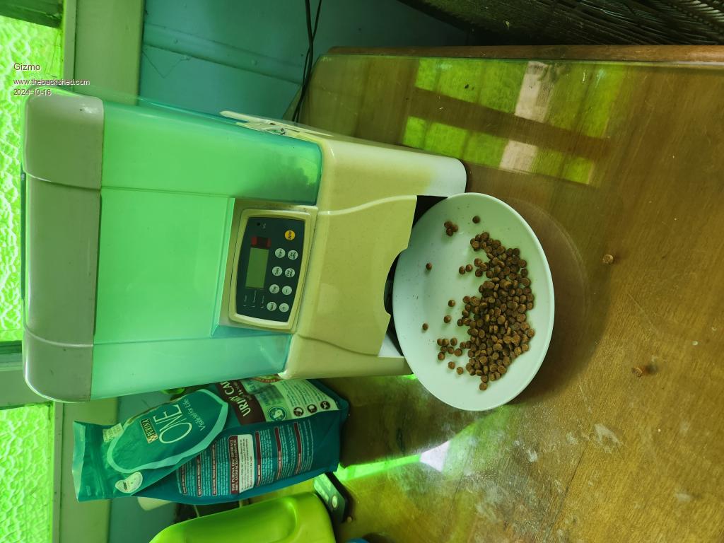

Occasionally I need to go away for a day or two. The dog goes to the doggy hotel for a couple nights, and the cat stays at home. Usually I put down enough cat food for the duration, but he eats it all in one go, then finds somewhere on the carpet to vomit it all up.

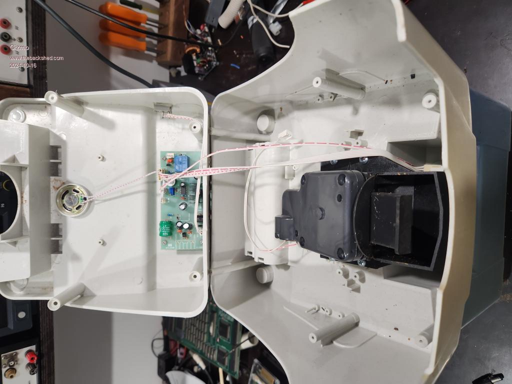

I was given a broken cat feeder. It has multiple issues, and instead of trying to fix it, I decided to hack it with a arduino.

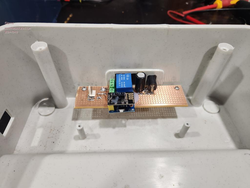

Opened it up and removed the main control board. The feeder uses a motor to spin a paddle wheel to basically throw out some cat food. I used a ESP01 plus relay board as the brains, mounted on a piece of veroboard with a couple caps, power socket, etc. Its powered by a 9v adaptor.
Spent a couple hours with ChatGPT to come up with the basic code, then modified it to add a few features. It connects to my wifi, and serves a web page to let you configure the feeder. I have two feeding times, and a duration to spin the motor for. It connects to a NTP server to get the actual time. Settings are saved in EEPROM.

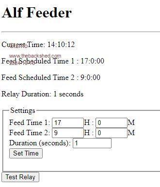

 String html = "<html><body><h1>Alf Feeder</h1><hr/>";
 html += "<p>Current Time: " + currentTimeStr + "</p>";
 html += "<p>Feed Scheduled Time 1 : " + scheduledTimeStr1 + "</p>";
 html += "<p>Feed Scheduled Time 2 : " + scheduledTimeStr2 + "</p>";
 html += "<p>Relay Duration: " + String(durationSeconds) + " seconds</p>";
 html += "<fieldset><legend>Settings</legend><form action=\"/setTime\" method=\"GET\">";
 html += "Feed Time 1: <input type=\"number\" name=\"hour1\" min=\"0\" max=\"23\" value=\"" + String(startHour1) +"\">H : <input type=\"number\" name=\"minute1\" min=\"0\" max=\"59\" value=\"" + String(startMinute1) +"\">M<br>";
 html += "Feed Time 2: <input type=\"number\" name=\"hour2\" min=\"0\" max=\"23\" value=\"" + String(startHour2) +"\">H : <input type=\"number\" name=\"minute2\" min=\"0\" max=\"59\" value=\"" + String(startMinute2) +"\">M<br>";
 html += "Duration (seconds): <input type=\"number\" name=\"duration\" min=\"0\" max=\"3600\" value=\"" + String(durationSeconds) + "\"><br>";
 html += "<input type=\"submit\" value=\"Set Time\">";
 html += "</form></fieldset>";
 html += "<form action=\"/manualTest\" method=\"GET\">";
 html += "<input type=\"submit\" value=\"Test Relay\">";
 html += "</form>";
 html += "</body></html>";
 server.send(200, "text/html", html);
