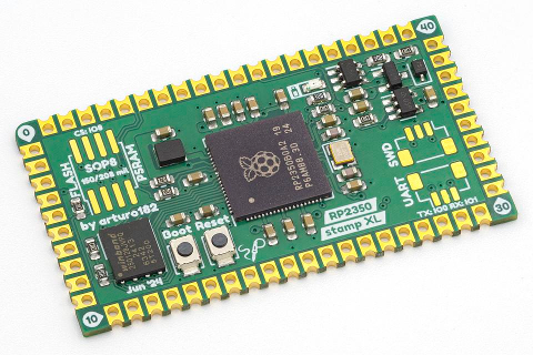

Has anyone looked at or bought any of these?  Any thoughts or observations?
https://www.lectronz.com/products/rp2350-stamp-xl
Warning!  2mm pitch pins, not breadboard friendly!  But there is a spot to solder PSRAM on.  Hmmmm  I wonder if it will run at the higher clock speeds?  (>315MHz)
They have a carrier board with a micro-DVI port connected to the HSTX pins:
https://www.lectronz.com/products/rp2xxx-stamp-carrier-xl
Unfortunately, no audio on the carrier board.  The SD card is wired to GP8-GP11 these are serial console and audio on Peter's reference HDMIUSB design.
Seems well documented with Schematics, design files and footprints available at Github.

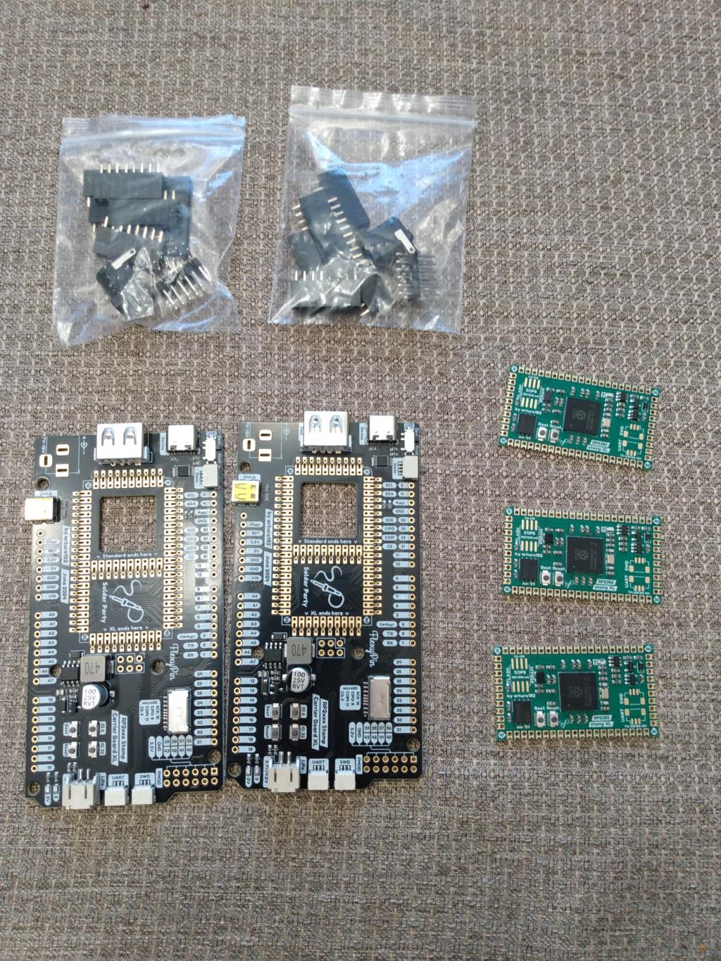

Mine arrived yesterday.  12 days economy snail-mail from Lectronz in MALMO Sweeden to Colorado USA.  I also ordered two of their "Stamp Carrier XL" boards.  My micro HDMI cables should arrive today. I should have some time to assemble and test tomorrow.  I also have some PSRAM IC's to install and test.  I don't know yet if these boards will run at the clock speeds required for the higher resolution HDMI modes.  I'll post here on TBS when I have more info to share.
Perhaps the name "Solder Party" refers to the 60 pins on the stamp XL device?  LOL

Ok, some initial results on the Solder Party RP2350 Stamp XL:
Device is stable at 315MHz (HDMI Resolution 640)
Seems OK at 324MHz (HDMI Resolution 1024)
Will NOT run at 372MHz (HDMI Resolution 1280)
I will do some longer term testing to verify stability at 315 and 324MHz.
Other observations:
The HDMI works fine with the default pin settings.
The SD card slot on the carrier board requires OPTION SDCARD GP9,GP10,GP11,GP8 which may require OPTION KEYBOARD DISABLE on non USB Picomite versions
The onboard LiPo charger and regulator seem to work OK.
The Official Pico2 is a great value at $5.00  but I still want a RP2350B device with more I/O pins.  The only RP2350B device that I have that runs reliably at 372MHz is the Pimoroni Pico2 Plus with the PSRAM removed.
All is not lost, I want to try the Solder Party module with my SSD1963 displays.  One of the nice things about the RP2350B is that the extra I/O pins will run a parallel LCD with plenty of I/O left over.  My best recollection is that the PicoMite firmware only supports 8-Bit parallel mode due to the limited I/O of the RP2040 device?

Quick update on the Solder Party RP2350 stamp XL with carrier board:
After more testing I am seeing some slight artifacts in the HDMI image at 1024 resolutions.  It seems to vary somewhat depending on the adapter/cable/monitor combination YMMV.  Whatever the case, the HDMI signal is marginal at 1024 resolutions.  The CPU is stable at the 324MHz, just the HDMI signal a bit marginal.  It looks very stable at 640 resolutions.
Differences to note:
1. They used 270 ohm series resistors vs 220 ohm for other designs.
2. The "Micro-HDMI" connector has tiny contacts spaced very close together and requires an adapter to full size HDMI or a micro to HDMI cable.  The video artifacts change a bit if the connector is unplugged and re-inserted.
3. There are long narrow PCB traces between the RP2350 IC and the series resistors+micro-HDMI connector.
  stanleyella said  I don't like micro hdmi sockets. used on raspberrypi 400. full sized socket can handle thick hdmi cable.
I agree!  the connector and it's contacts are tiny and fragile looking, especially with a heavy HDMI cable attached.  At least the connector has through hole mounting tabs so it's not entirely surface mounted.
Next step: add PSRAM to see if it effects maximum CPU speed.

Ok, finally got the PSRAM installed and working:
Added the PSRAM chip to the Stamp XL.  The Stamp XL module has the PSRAM CS line tied to GP8.  The carrier board has GP8 tied to the SD-Card CS line.  The PicoMite firmware uses GP8 for PS-2 keyboard or console by default.
Had to cut the trace between GP8 and PSRAM CS on the XL module to get anything to boot.  Added a bodge wire between PSRAM CS and GP47.  I can hook up my el-cheapo USB microscope and take some pictures if anyone is interested.
Now it boots, and the PicoMite firmware recognizes the 8MB of PSRAM with OPTION PSRAM PIN GP47.  Haven't had much time to test the PSRAM, will need to write a small program to test.
The RP2350B still seems stable at 315 and 324MHz  with the 1024 resolution modes still a bit marginal.

Here is a summary of my observations with the Solder Party RP2350 stamp XL and carrier board so far:
Things I like:
1.  Lots of I/O, although they did make some odd choices in trying to make it Arduino shield compatable?
2.  Lots of power options.  7-12V barrel jack, USB-C, single cell LiPo with onboard charger, Arduino style Headers, even the USB-A host connector could be used for power.
3.  USB-C "Device" and USB-A "Host" connectors with an anlog switch IC to connect them to the RP2350.  Can be switched by small slide switch on the carrier board or linked to GP7 via solder link on back of carrier board.  The full size USB-A "Host" connector is great for connecting a USB hub.
Things I don't like:
1.  Won't run at 372MHz for 1280 HDMI modes.  1024 HDMI modes seem marginal.
2.  Tiny Micro-HDMI connector seems inconvenient and possibly fragile.
3.  GP8 is shared between the PSRAM CS line and the SD Card CS line on the carrier board???  I had to cut the trace to PSRAM CS line and add a rework wire to GP47.  I'm not even sure if the RP2350 device can support sharing the CS line like this???  Does anyone know if CircuitPython supports this configuration?
4.  The 2mm pitch on the stamp XL is not breadboard friendly and really inconvenient for anything other than attaching it to the XL carrier board.
5.  The LiPo charge status LED flickers constantly without a LiPo cell attached.  It can be disconnected by solder link on the back of the stamp XL board BEFORE soldering the stamp to the carrier board.
All in, I'm not sure I'd really recommend the Solder Party modules for general PicoMite MMBasic use.  Peter's reference design for the official Pico2 module is still a great value AND it includes audio, RTC and USB hub.  Hopefully there will be a reference design for the RP2350B when the bare IC's become more widely available.
I still want to test with a Parallel LCD.
