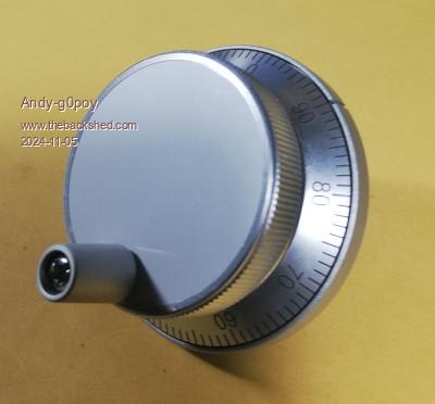

I have been trying out the PICO and MMBASIC as a simple development system and
so far it is working nicely.
I have solid code for the cheap ky-040 rotary encoder working fine
I have been trying to get this higher quality encoder working, it's sold as for use
with CNC machines. It is a really nice dial.
It outputs the normal quad. phase signals, but it is slightly different to the KY-040
in that the phase of the outputs is always 90 degrees apart.
The encoder is an optical type, so no contact bounce to worry about and
it outputs 100 pulses per rev.
The ode to use these encoders is veru very simply you simply interrupt of the rising edge
of output A and then read output B. If hige is mover in one direction if low it's moved in the other.
The simplest code I've tried is this:
sub do_enc
'Rotary encoder interrupt routine
'Requires init_encoder to be set up and run at startup
' Returns: modifies rotflag +ive = CW -ive -CCW
statea% = pin(clk%)
stateb% = pin(dt%)
if statea% = high% then
   if stateb% = low% then
   inc rotflag , counterclk%
   else
     inc rotflag , clockw%
   endif
endif
end sub
It ALMOST works. It detects the clockwise direction OK but sometimes it gets the direction wrong. so the output jitters
In the anticlockwise direction to situation is worse.
Just to make sure tyat the encoder is OK, I wrote the same code in c on an little ardunio nano and it works perfectly.
I'm wondering if I am hitting the limits of what the MMBASIC interrupt is capiable of, yopu can spin the encoders
quite quickly, especially after takign out the detent spring, so 600Hz pulses would be easily generated.
However the problem occurs at much lower speeds, and even when I turn the dial slowly the problem still occurs.
I'm just wondering if it is just on the limit of what the system can cope with. The docs indicate that there can be
a lot of system interrupts going on, so perhaps that's it.
If anyone knows what the limits are any advice would be appriciated.
I'm wondering if the PIO system could be used , but as yet I don't know anything about programming that.
Andy

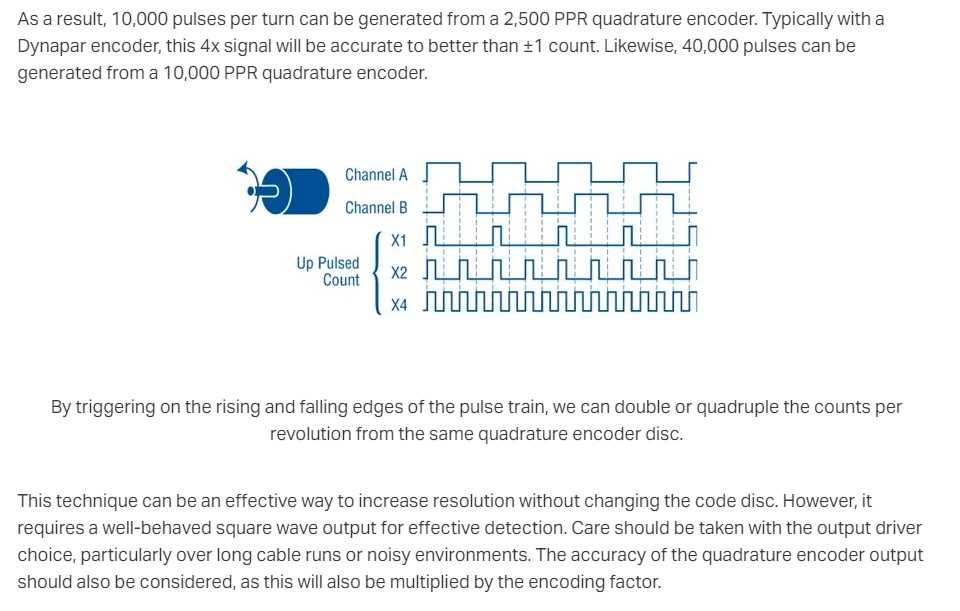

If that's a 100 line encoder, you will get 400 quadrature counts/revolution
Here, the frequency is 63MHz. Divide that by 44 and the count rate ~1.43M counts/sec.
Works beautifully.

Counting pulses is one thing but the phase offset between CHA & CHB indicates direction (up/down).
Edited 2024-11-05 06:13 by PhenixRising

Andy-g0poy
Joined: 07/03/2023
Posts: 85
Posted: 10:29pm 04 Nov 2024
  PhenixRising said  If that's a 100 line encoder, you will get 400 quadrature counts/revolution
Works beautifully.
The output is 100 pulses per rev.
If you trigger on the rising edge of the A output, that will be slap in the middle of the pulse on the B output so you get the direction from the value of the B output. Really nice encoders - They use a slotted disk rather than etched lines. It's also possible to remove the detent spring, so you get rid of the "click" which makes it a very nice tuning knob.
(I do have a 1000 pulse per rev shaft encoder to play with at some point)
Andy

PhenixRising
Joined: 07/11/2023
Posts: 2009
Posted: 06:04am 05 Nov 2024
Andy
It might be that your 1000 pulse encoder has complementary outputs (A, -A, B, -B) for better noise immunity. I use the MC3486 line receiver to interface to the MCU.

Posts: 5995
Posted: 08:13am 05 Nov 2024
@Andy,
I looked at your original code, and I think it could be optimized to work better.
In MMBasic you can set an interrupt on a pin. If you set that for interrupt going high on clock, you do not need to check the clock being high in your interrupt routine.
But...
You do need to make sure the clock line goes low before you enable the interrupt again(1), -or- simplest. (2)Do not exit the interrupt routine before the clock line goes low.
(1) re-program the interrupt for low transition. In the "low" interrupot routine program the interrupt again for "high".
(2) just before "END SUB" insert
DO:LOOP UNTIL PIN(clk%) = low%
But this typically costs 50% CPU power wasted waiting.
Your code however only uses the clock transition going high to count. The PIO code increments and decrements at every transition of either data or clock. So it gives better resolution. You can also improve your code. In example, this code would look at both clock edges (from 100 resolution to 200 resolution).
sub do_enc
statea% = pin(clk%)
stateb% = pin(dt%)
  else
  endif
else
  if stateb% = high% then
  else
  endif
endif
end sub
Then the interrupt should be set to both edges sensitive.
SETPIN gpx,INTB,do_enc
Edited 2024-11-05 18:24 by Volhout

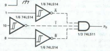

PhenixRising
Joined: 07/11/2023
Posts: 2009
Posted: 09:42am 05 Nov 2024
@Volhout
FYI: For best possible precision, the index is gated with A and B:
(apologies for the poor quality)
