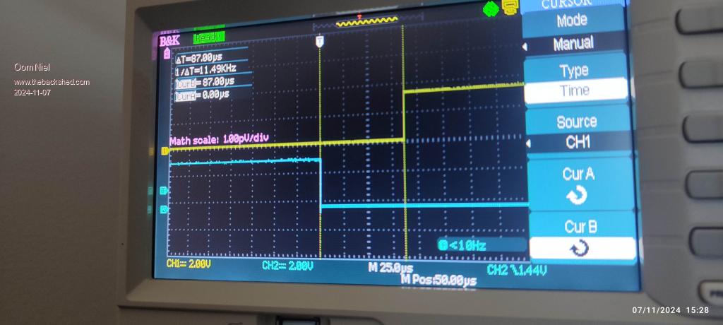

I was wondering if someone here can cast some light on the expected latency for pin interrupts using the Setpin function (e.g. Setpin GP2, intl, buttonIntHandler, pullup) in WebMite.
When running a simple program like:
option colourcode on
OPTION EXPLICIT
OPTION DEFAULT NONE
option autorun on
setpin GP3, dout
pin(GP3) = 0 'for testing int latency
'Main Loop
do
 Timer = 0
 Do while Timer < 2000:loop
 pin(GP3) = 0
loop
'Interrupt handler for GP2 going low
sub buttonIntHandler
 pin(GP3) = 1 'for testing latency
end sub
I get latency of between 57 to 87 micro-Seconds as shown in this image:
The blue trace is a simple button press and the yellow trace is the interrupt service routine toggling a pin high.

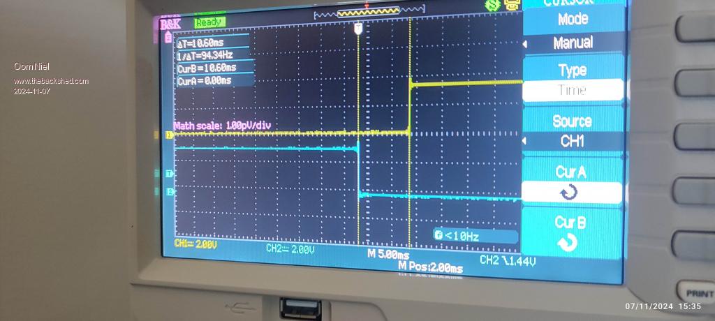

When a more substantial program is running, like pulling data from an MQTT broker the latency increases to about 10 mS and it can vary greatly (as much as 300 mS).
