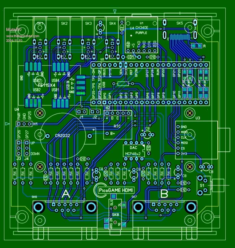

This is the one you've been waiting for. lol
It's PicoGAME 2 revisited. About as compatible as I can manage, given that there are less pins available. I've tried to create something that's a natural progression from that.
It fits the Hammond 1593 enclosure again, and is smaller than 100mm x 100mm.
Controller ports:
Port A is almost identical. The Fire input is now GP28 as GP14 is no longer available.
Port B can't use a joystick or analogue inputs, but it can use NES/SNES controllers with common Latch and Clock signals, it has its own Data pin. Also, System I2C is now on the pins that would usually have analogue connections so it's very easy to make an adapter for a WII controller. I think these changes will suit most people, but there just aren't enough pins to do everything.
The RTC is now a fixture and, in fact, is providing 19K pull-ups for System I2C. There's space for a nice big battery when the time comes to take the little yellow one off. :)
I thought I'd have a change and put the DAC in this time. I think that will let me get away with not fitting a linear regulator, which is a bit superfluous unless you have some user GPIO. It also means that you can choose your sound quality. :) The RP2350 has the horsepower to handle it.
The only nasty thing to solder is the HDMI socket. There's not a lot I can do about that as there's no room for the Adafruit module.
There was no room for an LED either! However, a 3-pin header will let you connect one in several different ways, including as a replacement for the Heartbeat LED. There is room to mount it in a holder above the audio socket on the front panel.
At the moment the pic shows the USB hub mounted upside down on wires with a L bent on the end to "surface" mount it. This is an idea I came up with to make them more easily removable in the event of a problem.
Comments welcome before I get the circuit diagram and BOM sorted out.

Posts: 8965
Posted: 06:47pm 10 Nov 2024
@ javavi
I've had another look at the possibility of dual video boards. It's possible, but definitely not on this build. It would be based on a system that has the same pinouts as the Adafruit DVI module, but with a VGA socket mounted on it. The main board would have no video capability by default, you would have to add one of the two boards. That makes a mess of the rear panel though. :(
The problem with this build is that I want to keep compatibility with the PicoGAME 2, yet add USB and keep the family resemblance. I have to find space for the USB sockets as well as the controller sockets . I'm out of space on the front and the back hasn't got enough space, even by piggy-backing it over the USB-C socket.
The best arrangement would be one where the rear of the Pico faces the video module, like PicoTower (which I think has possibilities even with limited back panel space) but with the Pico mounted further forward. I'll have a think about this for a future project if it's of interest. There wouldn't be a lot of front panel space, I don't think. What sort of a system have you got in mind?
Project updates:
I've now use GP22 as CS for the DAC and GP23 as the Data line for Port B. This is to avoid the risk of the pull-down resistor on GP23 enabling the DAC. I'd added a pull-up anyway, but just making sure.
The USB data lines are now isolated by a DIP switch instead of jumpers. A third way on the switch disables the above pull-up should it not be wanted for some reason.
Changed the power supply arrangement. The USB hub is now not powered while updating the firmware. It wouldn't be working anyway. :)
Quite a few minor trace layout changes for efficiency and, in a couple of cases, just to make them prettier. :)

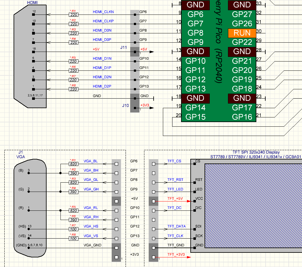

  Mixtel90 said  I've had another look at the possibility of dual video boards. It's possible, but definitely not on this build.
There are two more ways to get other types of video outputs:
1) Put a PLC pin comb on the HSTX Pico2 pins and thus make it possible to connect external connectors.
This solution is used on the "Murmulator" boards and makes it possible to connect an external VGA, LCD and even Composite Video module in addition to the soldered HDMI connector.
2) A passive VGA adapter cord can be made from a piece of HDMI cable by simply adding a few resistors.

Posted: 07:48pm 11 Nov 2024
It's not going to happen on this design, sorry. It's the sort of thing that needs to be implemented at the start, not at the end.
The PicoGAME 2 is fully VGA compatible and I'm not going to redo that in the same way.
The PicoGAME SPGA is another VGA design, but using the PGA2350 and providing a GPIO port.
I'm not going to attempt to make something like the Murmulator. There's no point, it's been done. :)
I'll have another look at it when I've managed to get a Adafruit module. I need one to get fixing centres etc. before I can even consider it. Also, I'm not going to move the Pico and everything else to get enough space to do it at this stage.
Have you looked at the PicoTower design? Is there a problem with that?

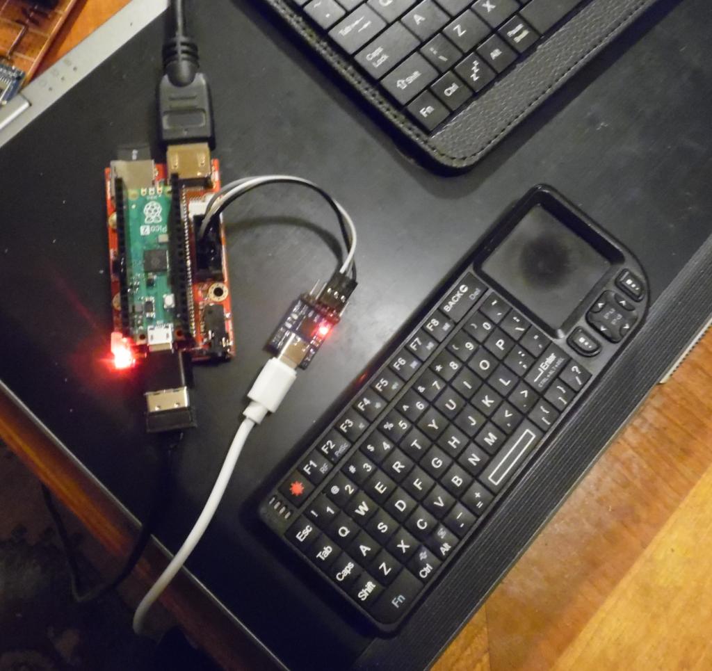

Posts: 2807
Posted: 10:32pm 12 Nov 2024
I know you guys got board designs so sorry posting olimex but it works even with the sockets it uses. I used long leg female headers for pico for pin access.
this is usb hdmi with usb to ttl for win programming. I recommend it.
