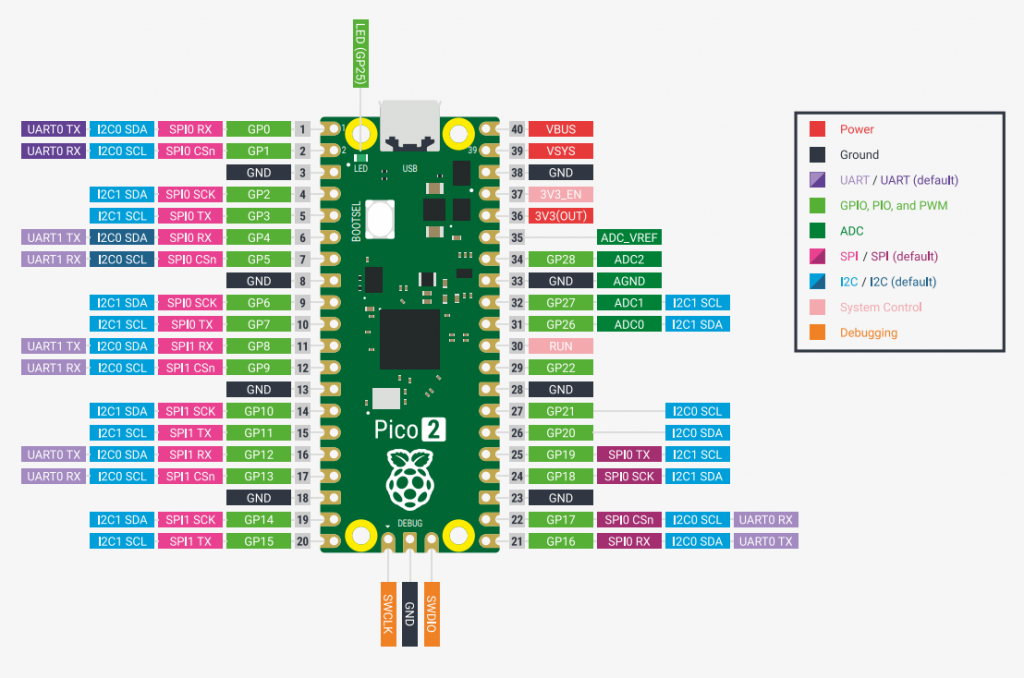

what are adc pins 2350 but on olimex hdmi? please
option list
PicoMiteHDMI MMBasic USB Version 6.00.00RC15
OPTION FLASH SIZE 4194304
OPTION COLOURCODE ON
OPTION KEYBOARD UK, 0, 0, 600, 150
OPTION CPUSPEED (KHz) 315000
OPTION DISPLAY 30, 53
OPTION HDMI PINS  1, 3, 7, 5

Posts: 11653
Posted: 08:20am 17 Nov 2024
  Quote  what are adc pins 2350 but on olimex hdmi?
There aren't any with audio enabled. Without audio enabled and the link between GP28 and GP26 removed you can use GP26

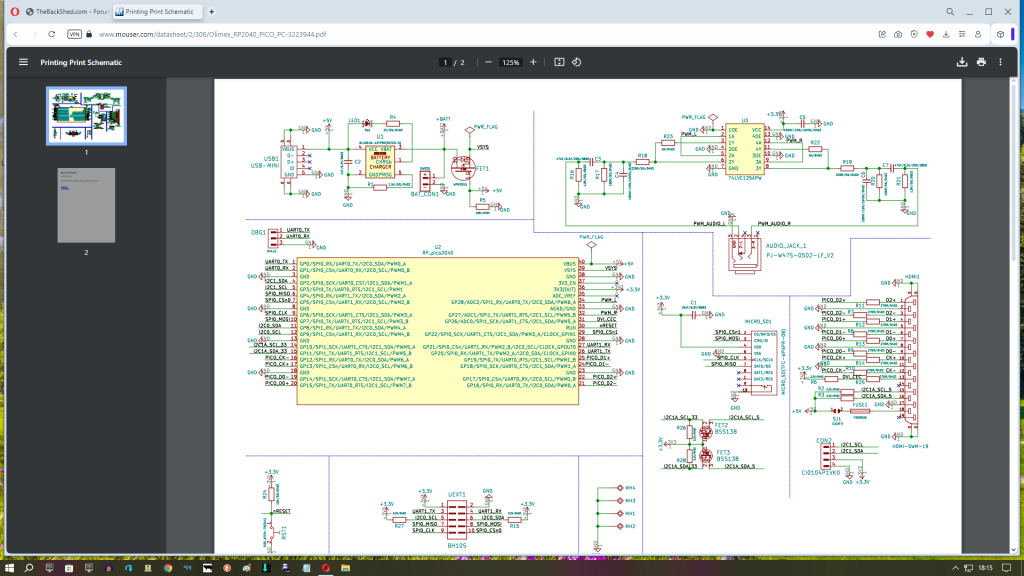

Mick, you seem more informed about olimex board than me. I don't know why gp26 and gp28 need joining.

Posts: 8965
Posted: 07:48pm 17 Nov 2024
MMBasic's audio wants both channels to be on the same PWM, where they use A and B outputs. GP26 and GP27 would be fine for this as they ae on PWM5. The Olimex board has used GP28 (PWM6A) and GP27 (PWM5B) for audio and put GP28 on the DVI_CEC signal.
This seems a weird choice. Why take the A channel from one PWM and the B channel from another? In fact, the whole of the audio side is odd. They took the PWM output, put it through a logic buffer then fed it into the simplest RC filter that was first used on the Micromite (except that they took the DC off the output). They put some resistors in to run an extra buffer too but then disabled it. Very strange and they don't seem to have gained anything.
By linking GP26 to GP28 you are getting the right channel from GP27, the left channel will appear on GP26 which is then linked to GP28 so that it can appear as audio.
The audio connections for the RP2350 and the RP2040 are identical when running MMBasic.
