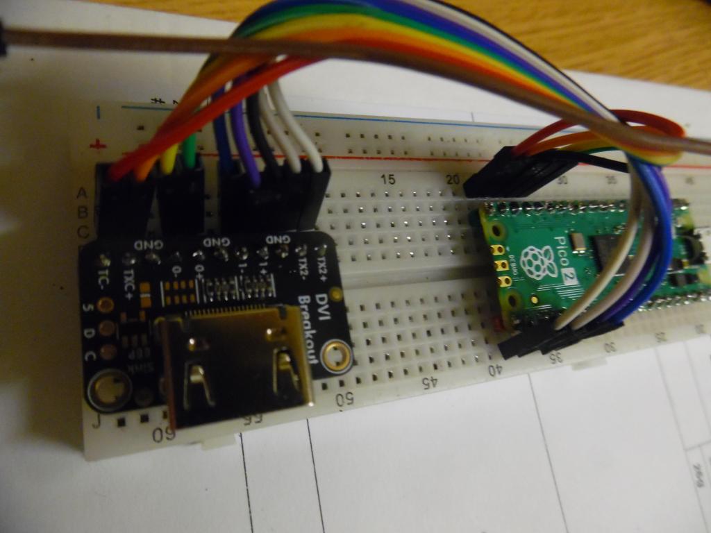

I ordered one of these.
https://thepihut.com/products/adafruit-dvi-breakout-board-for-hdmi-source-devices
it suggests using
GP12 to D0+
GP13 to D0-
GP14 to CK+
GP15 to CK-
GP16 to D2+
GP17 to D2-
GP18 to D1+
GP19 to D1-
how do the D0+ etc. relate to the board labelsplease if any ideas?
going to make pico 2350 usb hdmi sound and sdcard
cheers, stan

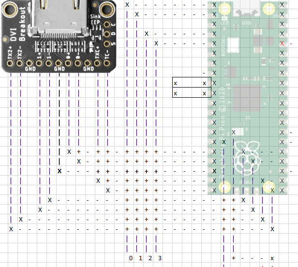

I connected the HDMI module according to this plan
sorry, I just had Excel to draw the design and ignore the other lines
Edited 2024-11-19 05:14 by Martin H.
'no comment

TX2+ = D2+
TX2- = D2-
1+ = D1+
1- = D1-
0+ = D0+
0- = D0-
TXC+ = CK+
TC- = CK-
You should also connect "5" to 5V.
You'll also need GND, of course.

Thanks Martin and Mick. great help for me.

Posts: 2807
Posted: 06:51pm 22 Nov 2024
Good news option hdmi pins 2,0,6,4 worked with
gp12=0+
gp13=0-
gp14=txc+
gp15=tc-
gp16=tx2+
gp17=tx2-
gp18=1+
gp19=1-
this the pihut dvi breakout board pin labels. well pleased it works.
option list doesn't show option hdmi pins x,x,x,x
5V to hdmi wasn't needed.

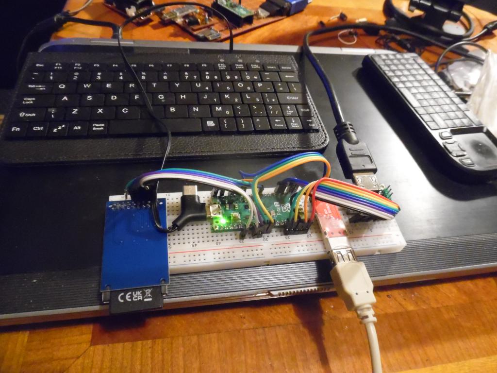

option sdcard gp22,gp6,gp7,gp4 works with the hdmi and reads files
option audio gp26,gp27 is accepted but not tested
> option serial console gp8,gp9
Error : Pin 11/GP8 is in use
where?
PicoMiteHDMI MMBasic Version 6.00.00RC15
OPTION FLASH SIZE 4194304
OPTION KEYBOARD US
OPTION CPUSPEED (KHz) 315000
it's cos I not using usb hdmi and it's for keyboard.
I'll flash usb version and usb to ttl. all on bread board and molex cables atm
Edited 2024-11-23 06:56 by stanleyella
Posts: 2807
Posted: 09:38pm 22 Nov 2024
usb hdmi works with sd card and usb to ttl and usb keyboard. solder to copper strip "vero" board next. pleased it works. stan
