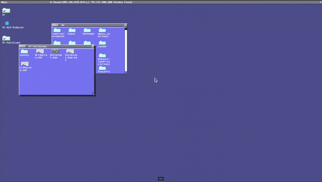

I know - The CMM2 already has a fully working file manager. But this started as a bit of fun. It was originally going to be a GUI for a graphical text adventure like the old Magnetic Scrolls "The Pawn" or "Guild of Thieves".
Then it sort of morphed into a front end for launching programs or managing files.
It's a work in progress, so it almost certainly has a few bugs, and there's a lot more features I want to add to it (Ram Disk, Networking etc.), but I want to spend time on some games dev, so it's going back on the shelf for the time being.
It happily handles files and directories being moved, renamed. Launching programs. Copying links for folders to the desktop (for easier launching) and it has a Rubbish bin for deleted files, so that they can be recovered.
It does require a CMM2 Gen 2 as it uses the mouse. It is by no means intended to be an operating system - I 100% still prefer that the CMM2 boots straight to BASIC and not to an OS. But part of my thinking was that if you did want to make a system that was easier for the grandkids to launch games etc. then this would suffice. It would be simple to disable the disruptive commands (Delete, Move, rename etc.) so that it was only a file launcher.
Video of it in action here:
https://1drv.ms/v/s!AnkZn9N9Pt1fyMISsNqOildOm0r6jA?e=cCDuMg

Well, it could be extended to be GEM for CMM2 if you like.  Add some apps and control panel to customize the look etc.

Oh, very cool, Pete
This is the sort of thing I've been wanting to see and I love the code format/structure

That's a very nice graphical shell Pete.
Posts: 3820
Posted: 02:57pm 19 Nov 2024
What a terrific piece of code, Pete. Congratulations.

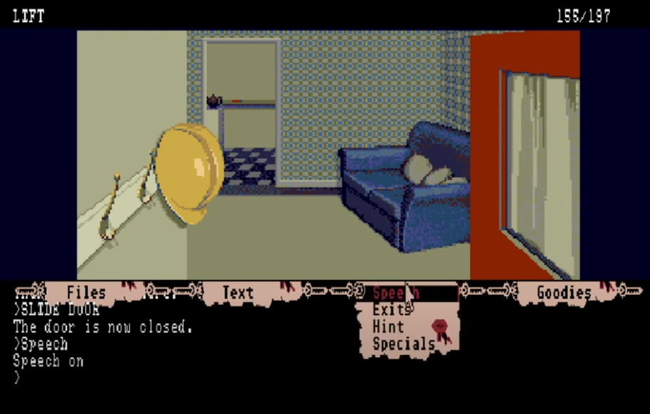

  Volhout said  Pete,
Nice work. But I fail to see the relation to the Magnetic Scrolls adventures.
I played on the Amiga - so it might have been different on other versions. But the graphics were on a sliding window that could be dragged up and down over the text (it seems so trivial now - but I remember being wowed at the time). At the bottom of this overlay window were four buttons which opened drop down menus.
That was the genesis of this whole project.
I was thinking it would be nice to add a lot more as well, such as an auto-drawing map and roving characters who would be overlayed on the background images.

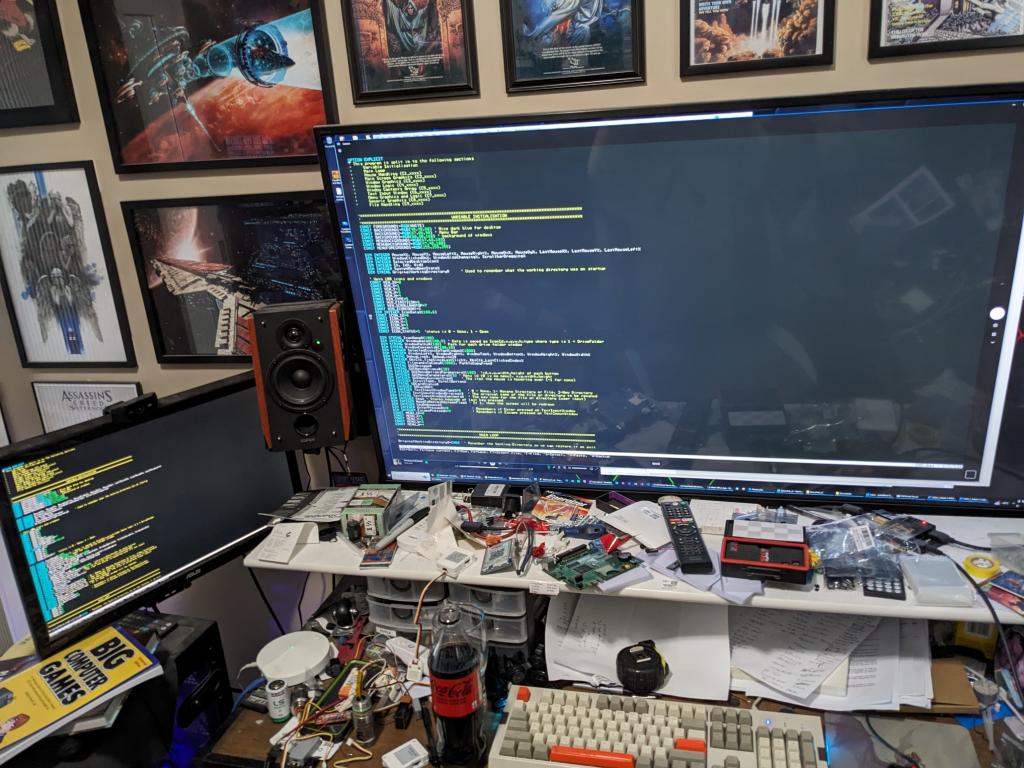

  PhenixRising said  Hey Pete, how did you capture that video of the CMM2?
With these two doo-hickeys.
A VGA to HDMI connector to convert the VGA out to HDMI.
https://www.amazon.ca/gp/product/B083K83NNX/ref=ppx_yo_dt_b_search_asin_title?ie=UTF8&psc=1
An HDMI capture card. I just used Windows Camera app to record the incoming video (if you open Windows Camera app - it sees the capture card as a web cam).
https://www.amazon.ca/gp/product/B0CLNZ8267/ref=ppx_yo_dt_b_search_asin_title?ie=UTF8&th=1
The whole setup works well, because I can also pass through the HDMI to my HDMI splitter box (not required to record the video). This gives me the options of how to use the output: video out from the CMM2 to a Window on my PC (via Camera app) or straight through to my secondary monitor - or both. Or use the secondary monitor for my PC (usually), my Mac (boo-hiss -  I have to have one to compile iPhone projects), or whatever Raspberry Pi I am mucking about with.
https://www.amazon.ca/gp/product/B071G4NXNH/ref=ppx_yo_dt_b_search_asin_title?ie=UTF8&psc=1
Please forgive the incredibly messy desk - but as you can see, the CMM2 is feeding through to the 24" secondary screen, and if I'm feeling particularly blind it's also displaying in a window on my 55" PC monitor. Interestingly, the Webcam input (from the capture card) reacts to mode changes much faster than the 24" monitor (it is an old monitor > 10 years). If I change mode, my monitor blanks for a few seconds before locking onto the new display mode. Modern monitors are probably much faster at picking up the new signal.
Edited 2024-11-21 06:17 by PeteCotton
