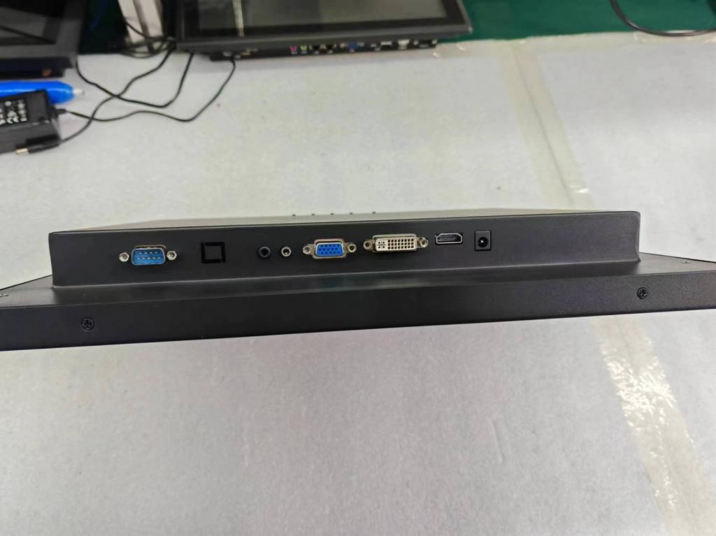

For some months now, I have been chatting with a Chinese supplier of industrial touch-monitors. I was looking for a TS with serial output. These guys supply these but I couldn't get through to them that I need the protocol. They just couldn't understand this. "We have driver" Yes but for PCs with operating systems...no good for MCUs.
Anyway I think it finally clicked and I just received this:
  Quote  Touch screen serial port communication protocol
Baud rate: 9600, data bit: 8, stop bit: 1, check bit: N. The format of the data packet sent (a total of 10 bytes):
55H, 54H, DO, D1, D2, D3, D4, FFH, 00H, D5 Among them: 55H, 54H---data packet start character.
D0---touch state, start touch is 81H,
keep touch is 82H, lift is 84H.
D1---touch point X coordinate low 8 bits.
D2--touch point X coordinate high 8 bits.
D3---touch point Y coordinate low 8 bits.
D4--touch point Y coordinate high 8 bits.
FFH, 00H---data packet end character.
D5-check byte, D5=D0+D1+D2+D3+D4-AEH, if greater than FFH, take the lower 8 bits, if less than 0, take the complement. If the check byte is wrong, abandon the data packet.
Note: Data will be sent continuously while the button is pressed, with one data packet every 30ms or so.
This could be good news because I really need a touchscreen for the CMM2.
I already interface with the serial output of the ELO-Touch but those are £500 touch monitors...not exactly hobbyist friendly.
I'll see about grabbing one for test.

Should be interesting.
The protocol looks pretty sensible, especially as the packet is fixed length. Please let us know how you get on with it.
