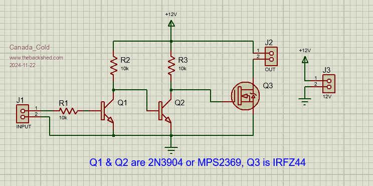

Posts: 57
Posted: 01:31am 22 Nov 2024
Hi PhenixRising,
I don't know what your power requirements are, however, for medium power (up to a few amps) I use the following ckt.
