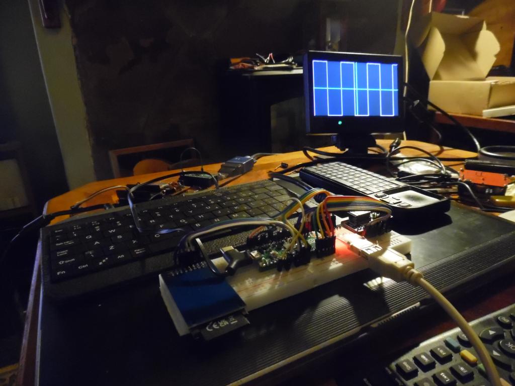

I built a usb hdmi board and tried adc on gp28
 setpin gp28,ain
 'SETPIN (34), AIn
 adc open 10000,3 'samples per second
gives
run
[3] ADC open 10000,3 'samples per second
Error : Pin GP26 is not off or an ADC input
> option list
PicoMiteHDMI MMBasic USB Version 6.00.00RC15
OPTION FLASH SIZE 4194304
OPTION COLOURCODE ON
OPTION KEYBOARD UK, 0, 0, 600, 150
OPTION CPUSPEED (KHz) 315000
OPTION DISPLAY 30, 53
dunno what to do, only built board to overcom olimex a2d probs

For ADC OPEN channels are allocated in sequence. Check the manual.
If you want one channel it has to be GP26. Two channels, GP26 and GP27.
I suppose that all pins to be used for ADC inputs have to be set for it.

Look at your OPTION LIST
You have GP26 and GP27 reserved for audio.
Remove that and you can use GP26 and GP27 for ADC
you can choose some other pins for your audio.

I don't know why I used gp26,gp27 for audio.
changed to gp0,gp1 as suggested in vga manual and all is fine in that it accepted audio gp0,gp1 and the gp28 as adc is working.
I got a vga usb board that runs this "scope" prog but no test pwm signal with hdmi usb

Are you sure your PWM output isn't working? If you set freq=50 you could probably measure something on it on the AC volts range of a multimeter.
Posts: 6548
Posted: 08:18pm 24 Nov 2024
You seem to be fixated on GP28.
Do you have GP2 linked to GP26?
GP26, not GP28.
adc open freq*100,1 'samples per second
ADC command uses GP26 as the first input and in this case the only input.
Posts: 2807
Posted: 08:52pm 24 Nov 2024
  TassyJim said  You seem to be fixated on GP28.
GP26, not GP28.
idiot I am connected gp2 to gp26 and I got pwm wave on screen

why was this so difficult? for me, losing it?
