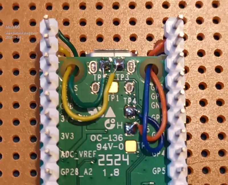

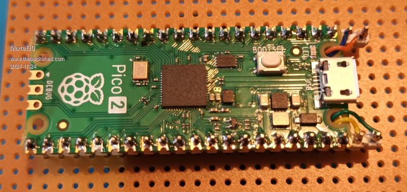

This brings out extra signals:
GP25-TP5   TP2-DM (D-)
GP23-TP4   TP3-DP (D+)
Pin1           Pin40
Pin2           Pin39
etc.
As you can see, it is still 0.1" breadboard compatible and the extra pins are easily removed later if you decide that you don't want them. You could do this with any of the RP Pico modules but the signals may not be available on some clones.
GP23 is only available if you are using an external 3V3 regulator. It has an on-board 100K pull down resistor.

No. This is a normal, official Pico 2. The one with the RP2350A on it. I just added 2 extra pins on each side to get extra signals onto the board.
