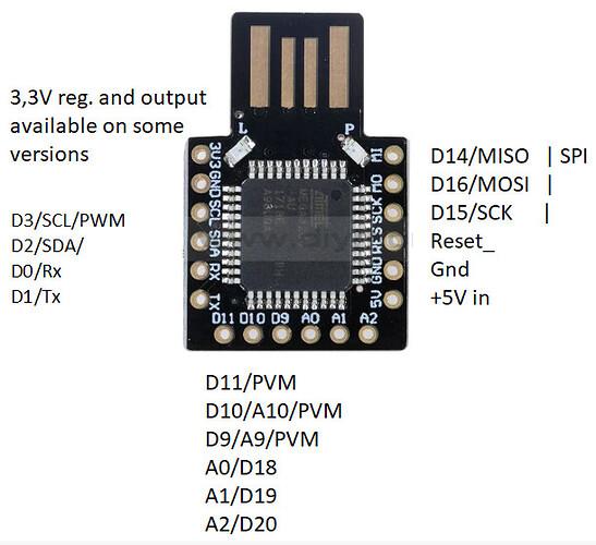

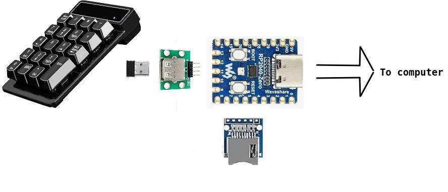

I have been looking at using the Waveshare RP2040-Zero as a HID device.
I am using the Arduino Leonardo know as BadUSB to give me keyboard and mouse
operations with the push of a single key.
My next step is to add SDcard with definitions for each button so no need to
redo the program with new changes in what buttons do.
Eventually looking to build this.

What it will do is map keys from keypad to keyboard and mouse functions.
 Not pass on the keys on the keypad but a macro that can be mixed key and mouse
 under any key. The map would be on the SDcard so the mapping can be done
 without reprogramming the pico.
 I am using custom mapped alt+x keys to do things as I can not use my right
 hand yet. Here is my Minecraft 5 button arduino device. Saves me a lot of
 typing that is hard to do one handed.

Volhout the USB wireless receiver comes with the keypad which has
 the transmitter built in. I guess no one is understanding what this
 is to do.
 I am using the keypad as my first test but the pico part would be able
 to have any keyboard plugged in and send the macro for the pressed key
 out to the computer. With a full keyboard one could map a lot of words
 and mouse functions being sent to the computer. Best part it should be
 OS independent Linux, Windows ?Mac. Would act as if someone typing or
 using mouse. There are very costly macro keyboards that do some of what
 I want this to do.
 Think of it like this I have my main keyboard plugged in if you plug in
 a 2nd they act the same. Press "A" on ether and get and "A".
 Using this idea your main still sends and "A" for the A key but the keyboard
 plugged into the device would send "Hello world. How are you?" as that is what
 remapped when the "A" is sent by the 2nd keyboard. The pico gets the keys from
 2nd keyboard and looks up what to send from the SDcard.
 Hope this is a better description its function.
