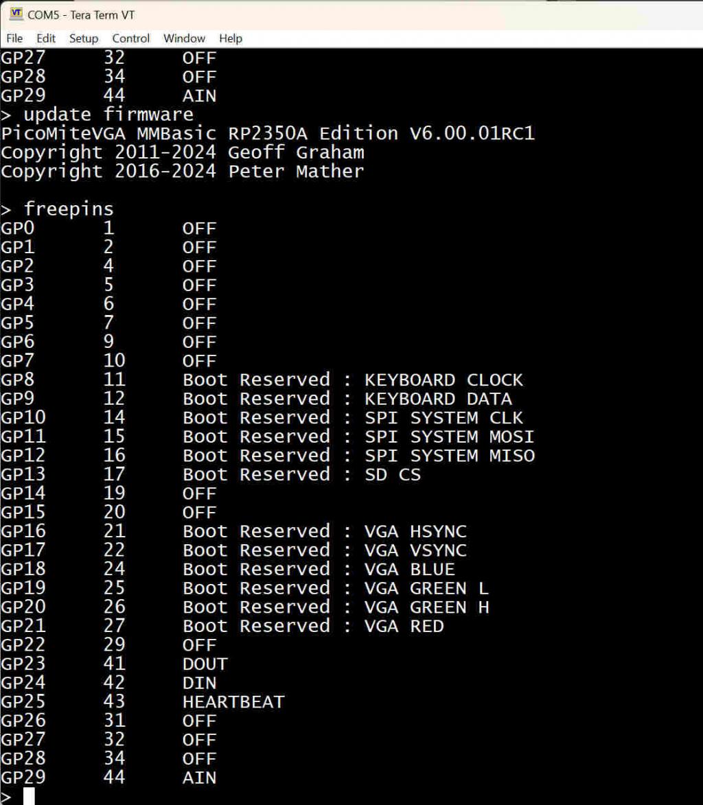

  Quote   but maybe it is possible (or put it on the wish list for 6.00.02) to correctly display the pin function for pins that are in use in the OPTIONS (boot reserved).
Not really possible without a huge amount of code to go through every possible allocation for each pin and check the Option to see if that pin is using it.

Posted: 05:41pm 26 Nov 2024
I suppose you mean something like this

  matherp said  I suppose you mean something like this
Yes! PicoMite's built-in procedure for informing about port status and reservations will be very useful for users/developers.
Edited 2024-11-27 04:00 by javavi
Posts: 6100
Posted: 06:52pm 26 Nov 2024
Hi Peter,
That is way over the top. Very nice, but reading the pin config (alternate function registers), and justconverting that to SPI or  I2C would have been enough.
But this sure is very nice,
Edited 2024-11-27 04:53 by Volhout
Posts: 11828
Posted: 07:05pm 26 Nov 2024
  Quote  but reading the pin config (alternate function registers), and justconverting that to SPI or  I2C would have been enough.
Doesn't work for thing like CS pins etc.
