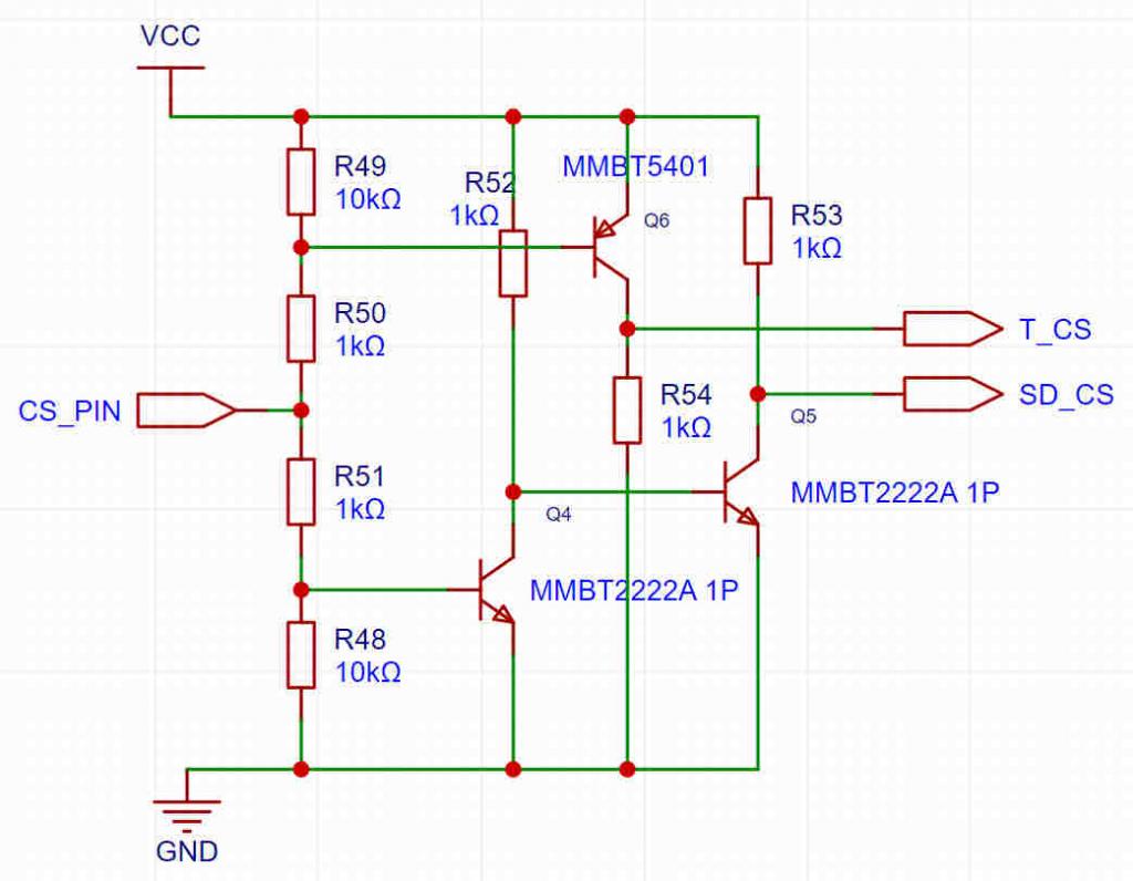

page 91: option combined cs. The electric scheme which is necessary should be included in the manual somewhere. I might have overlooked it.

Circuit for OPTION COMBINED CS  is
