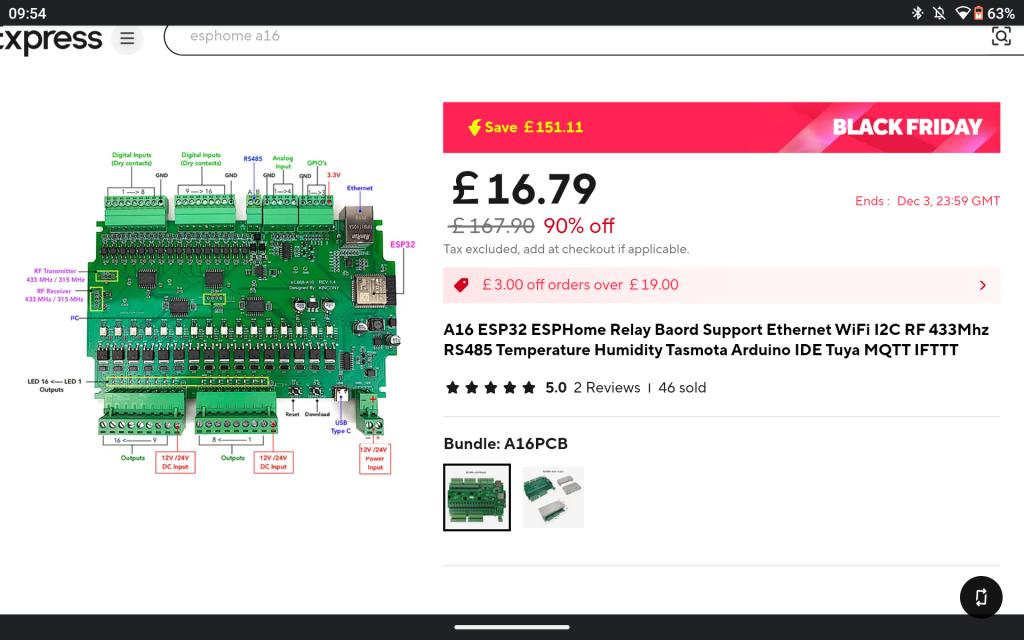

Using ESP32 only as a BT device for the PicoMites right now but I want to use ESP-Now and possibly the WhatsApp and Messenger messaging.
Perfect slave device.
Do you have experience with ESPHome?
I have only glanced at it but it looks pretty friendly.

I couldn't resist at this price and they have lots of sample code on their site.

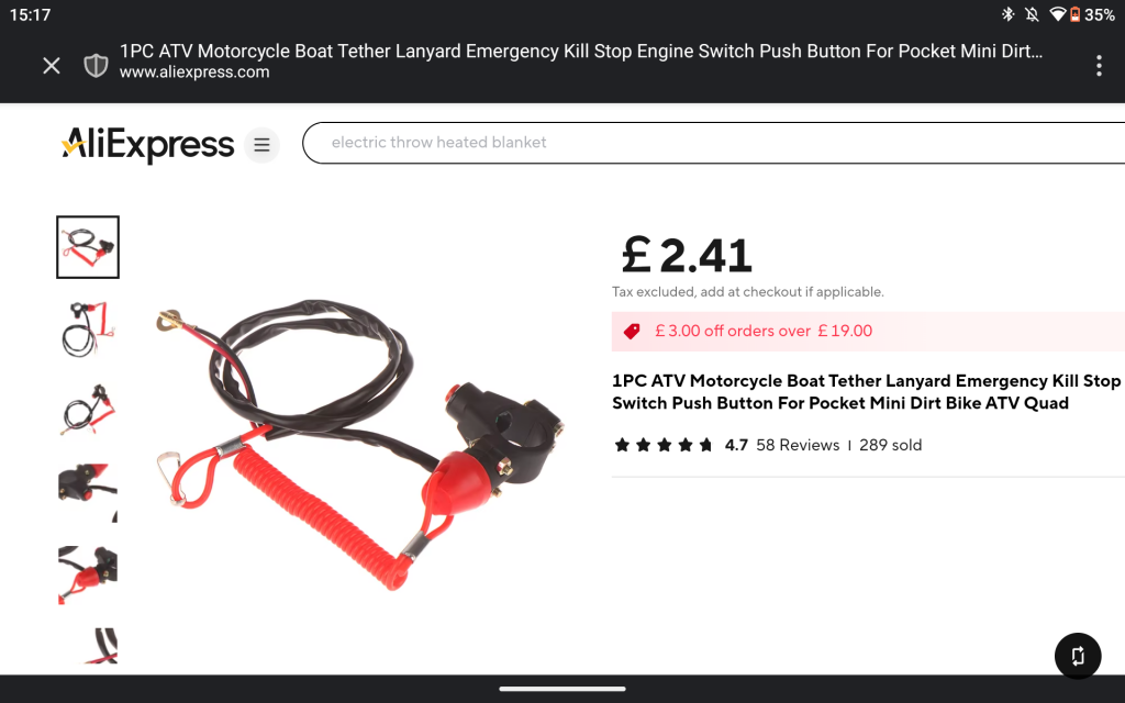

Quazee137
Sounds like you need a lanyard switch:
Have the strap around your wrist. Insert the plug to enable power. Pull your hand away, the plug pops out and power is removed.
